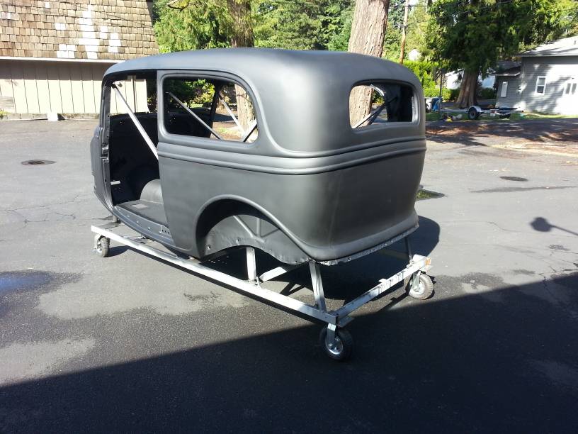

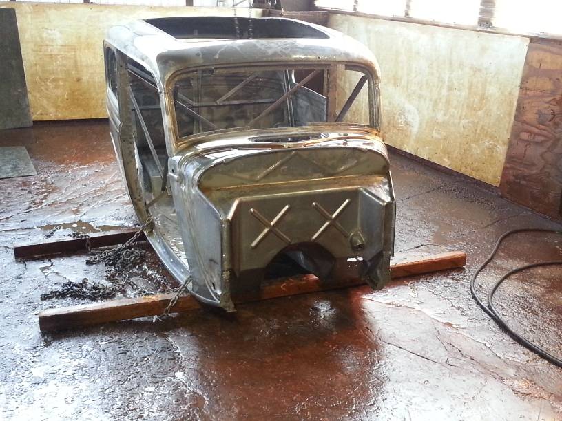

    Had mine done hear, reasonable price & lead time. They are used by Steves Auto Restoration, Graveyard Carz, and most other good shops. Phosphated also, epoxy primed as soon as it was home.
    This is non acid, electrolysis.
    https://www.americanmetalcleaning.com/ 20140918_084940.jpeg 20140925_143502.jpeg
