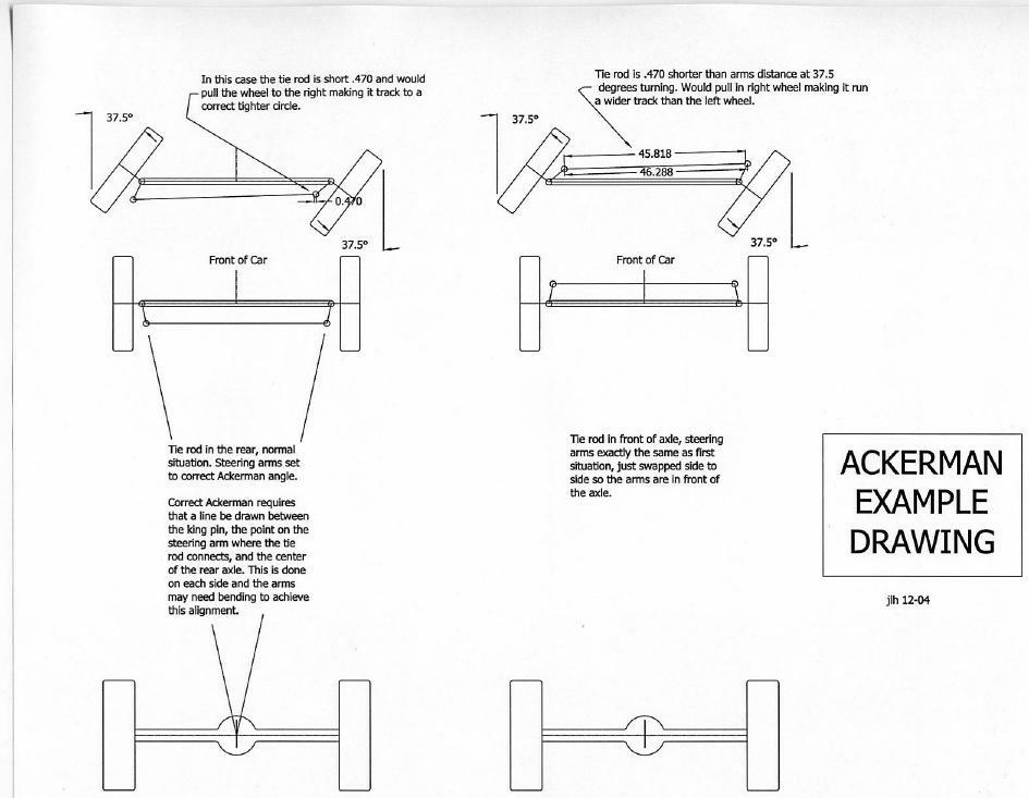

    Out of curiosity I did a sketch to see what the effects were with the Ackerman steering arm angles. It was interesting to see just how the angled steering arms moved and what happened as they turned. From this I would say that just swapping the arms from one side to the other, placing the tie rod in front of the axle, would not be good and tire scrub would result on tight turns. On wide turns it does not make much difference.
    Having the arms angled properly (on the tie rod behind the axle setup) does the right thing and makes the inside tire track on a smaller radius than the outer wheel.
    This is old info for many of you I'm sure but the drawing helped clear it up for me. [​IMG]
    (You will probably need to print the drawing to read the text)

    THINK about it man...only the location of the outer tierod ends needs to be changed to regain a useable amount of Ackerman.
    Do you REALLY think GM and FORD got the independents wrong!?!?
    My front tierod 4x4 has the tierod ends so far out that the boots actually rub ever so slightly on the rims! If it were rear steer the tierods would be several inches away from the rims.
    It's just a location issue to get Ackerman back into line.
    Heat the arms and move them out to compensate on a straight axle Hot Rod with the spindles arms flipped to the front.

    you know... I hear that 100% Ackerman isn't correct. 100% being exactly what Ackerman said, the lines running straight to the middle of the rear axle. Supposedly its supposed to be anywhere from 50% to 75% Ackerman, 50% being smack dab in the middle. Thats what I was told by an autocrossing, racecar building veteran. Take it for what its worth.

    metalshapes
    [ QUOTE ]
    [/ QUOTE ]
    You are right.
    If you take a corner faster, the tires will not just roll, but they will also slide a bit.
    The difference between the the centerline of the tire and the direction of the movement is the slipangle.
    The outside tire will be able to have a larger slipangle before breaking away than the inside one because of the weight transfer.
    So you dial in less Ackerman to get the breakaway points closer together ( Improving the total grip ).
    Different types of tires have different maximum slipangles.
    Tall skinny biasply tires tend to be controleble at large slipangles so they need much less Ackerman.

    Maybe I don't understand Mr. Ackerman's theory, but the MustangII geometry is meant for a 96 inch wheelbase. Say on a '40 Chevy, with a 113 inch WB that's alot of heating and bending and weakening, isn't it? I've never heard of the 50 or 75% theory. Racers usually aren't concerned with tire wear as much a road car. [​IMG]
  17. Ackerman principle works well for low speed driving and has become less important on modern cars. Our driving habits have changed vehicle dynamics quite a bit over the last few decades. Principles that were carved in granite before are no longer taken as gospel.
    That said Ackerman changes toe angle during a turn. Toe out slows responsiveness, so the counter to that would be no angle change to toe in. A convergence point far behind the vehicle. This helps for a crisper turn in but can cause a scrub on the outer tire at low speeds. Case in point; drive a new car on polished concrete and listen for the tires howling. This usage of less Ackerman angle has opened up posibilities for platforms being stretched to fit multiple applications. In racing applications it helps to be able to change the convergence point to sort out some over/understeer situations. But for the case of our hotrods, close is good enough.
    The only real Voodoo to avoid would be negative ackerman angle.
    I am still waiting for the reason why all Mustang and Camaro front ends are done wrong by street rodders.... I can't wait to get into the front steer vs rear steer thingie. And then drop the compound steering geometry employed by GM on the Corvair and front steer Camaros! WHOO thats gonna be fun... [​IMG]

  19. [ QUOTE ]
    [/ QUOTE ]
    Damn, I though you were going to pull something different. Oh well,
    Have you ever measured the convergence point on a Mustang II? I have, it is somewhere around 160" back! Well within the scope of most streetrods.
