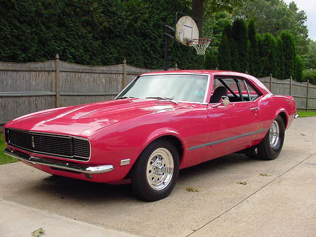

  24. aerocolor
    Joined: Oct 7, 2009
    Posts: 1,204
    aerocolor
    from dayton
    Magenta Camaro 24 years
    Orange Camaro 20 years
    Both DuPont Lacquer. Stored winters and heated garage the last five years. No cracks just slight dulllling that comes back with a foam pad buffing every couple of years. The advantage of lacquer is I can spot paint it and buff back in without painting an entire panel like Urethane
    basecoat/clearcoat. Both still look nice.
    Bill
