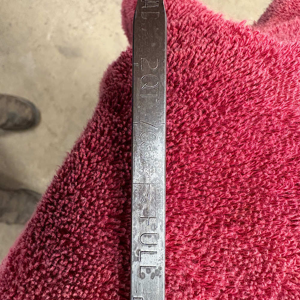

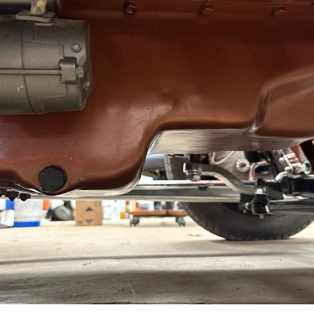

    My dipstick is 16 5/8 total length. It’s also not marked with an M. My pan is rear sump, but shaped slightly different than the image you posted. So, I just added the 6th quart, cold engine with canister drained back to pan. On my stick it still shows about a half qt low.
    In my mind, that’s where I’m running it!
    Possibly I’ve got a Merc pan, Ford dipstick?
    Regardless, I’ve got 6 qts in it.
    Thanks again all for the info guys.
