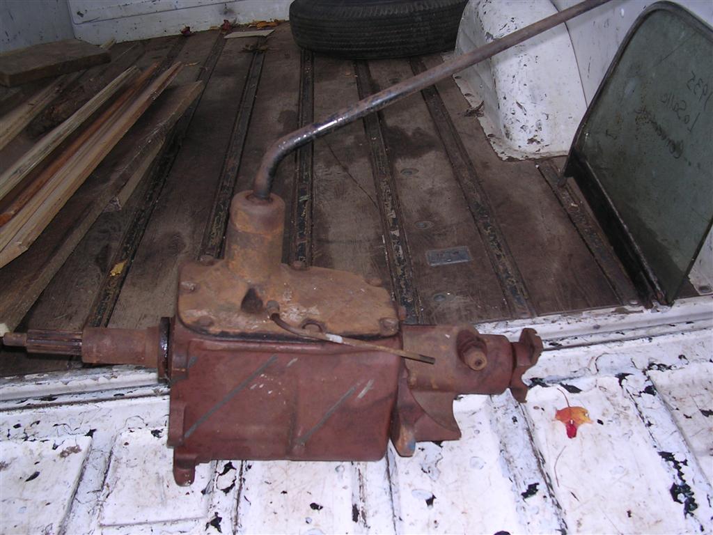

    Frank it certainly seems that you are correct in that the spring is pinned on the one side to force it to one side and probably the neutral gate. Upon closer inspection of the pin, there is a nail head on the opposite end, that seems to be pretty well covered by the spring coils. I guess the spring has to be compressed to be able to get at the pin? Only think I can think of to compress it would be a C clamp. I have one that's big enough but it doesn't want to catch bottom coil to compress, and even if it did, I'm not sure I could get in there to back the pin through the stick.
    Man... They sure made this thing a pain in the ass to take apart! I wish it were easy like the SM-420's from the 48-87 Chevy trucks!

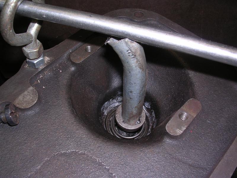

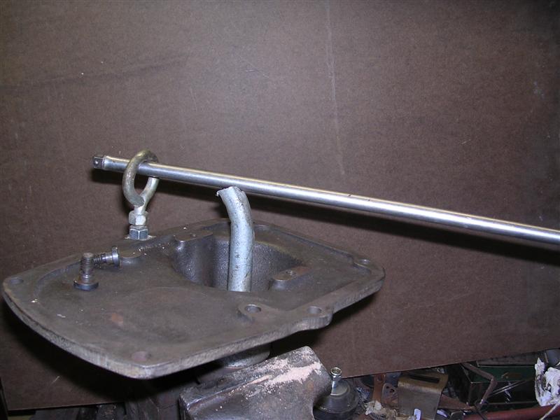

    Don't have an unmolested 37 shifter.. The only loose one came from a package deal for 2 37 Buicks that were modded with Olds stuff back in the day. The seller said he had "some oldtime trans go-to guy" , "go through them to make sure they were all set"
    Well, one had this cover with screw-in "rivets", because it apparently had a broken spring. They had the wrong spring, and a weird retainer you can see...... and I am waiting for Walt to find out where we can get a substitute tapered spring.. Walt can find stuff :)
    Anyways, all I had right on the bench was a bent piece of 5/8 EMT.. So I used it despite the bend. Ground two windows with a 4-1/2" grinder.. Then an eye bolt... and a super long 3/8 extension. You can get the idea from the pics. I think that size EMT should fit the small end of your stock 37 spring perfect.
    Back to the threaded rivets on this trans. I have no idea if they were from something else, or made by a machinist, OR if they might be an old Buick "Service-replacement part" from back in the late 30s..if it broke a spring, how would the factory suggest dealing with rivets?? IDK, just a guess

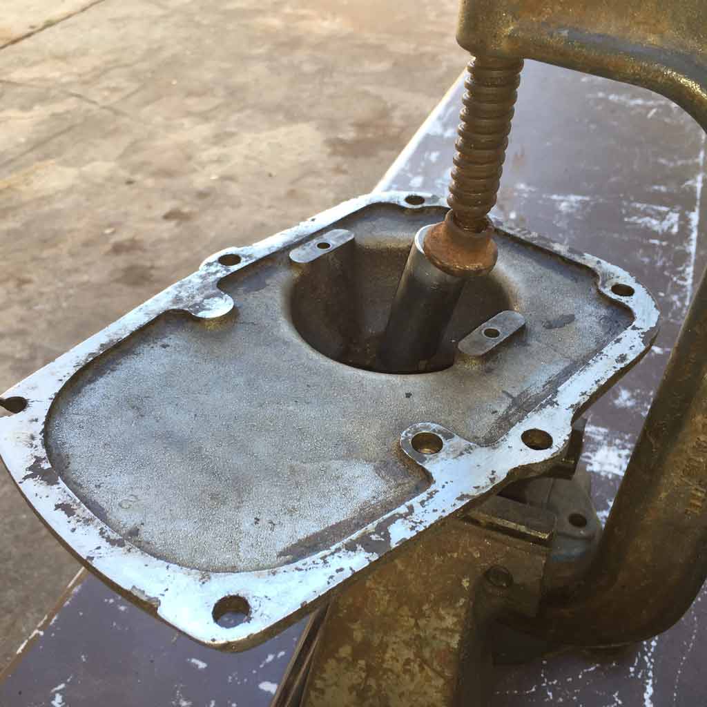

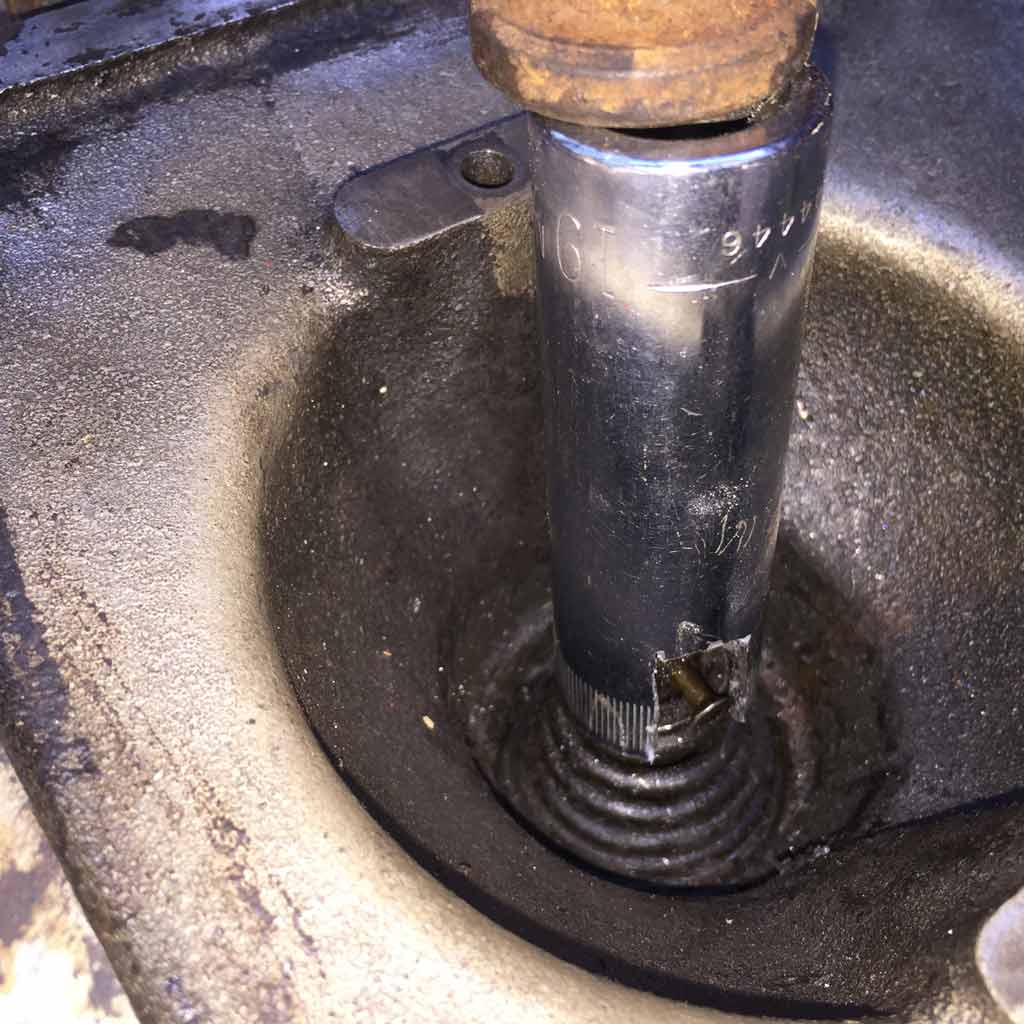

    I see. Good idea. I was thinking about slotting an old metric socket ( I have TONS of duplicate metric sockets from my dad's shop) and and seeing if I could use a clamp to press it down. I gotta say i like the threaded pins a whole lot better than these pressed and staked versions! I might get to sneak out to the shop and see about freeing this sucker up tonight after work.
    Thanks for the detailed pictures! If the slotted socket doesn't work I'll see if I can dig up a piece of pipe and an eye bolt. I may need to run to the store the eye bolt.

    No need to "must use" a eyebolt. I use what I have in a five foot distance from the vise.. :)
    You can use flat stock, L shape with a hole at both ends. One hole on the short leg to bolt to cover, then a bigger hole up top for the bar. Or a short piece of light duty chain, whatever.
    Really would help to have it in a vice, but no matter how you try to hold it, the shifter will move around a bit as you fulcrum it. Nice to have one guy "two hand" the spring compressing, and another to grab the pin before something slips :)

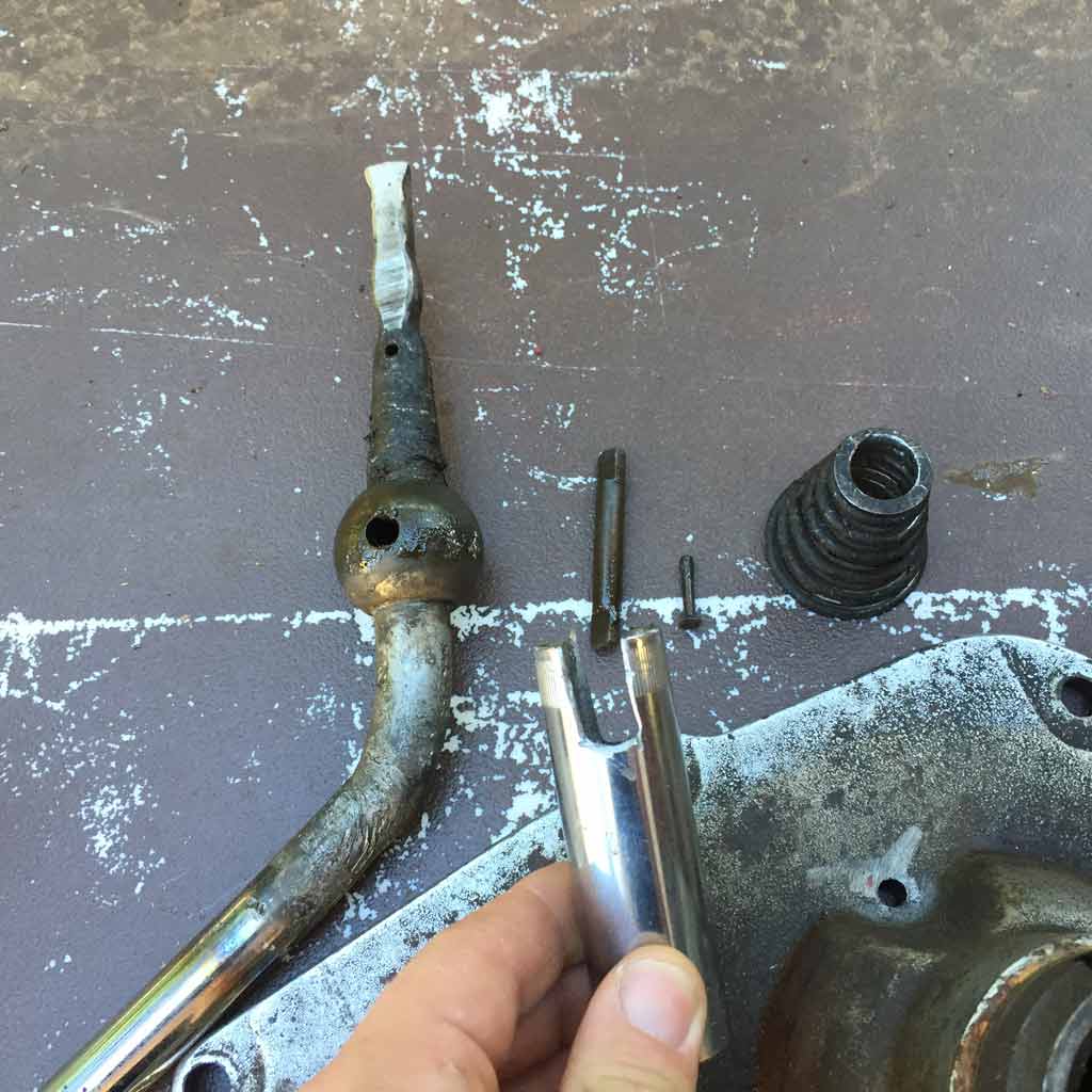

    I'm hoping to get the spring out this morning. My pregnant wife and my 2 year old son should be awake shortly. I'm sure they'd appreciate it if I didn't start up the angle grinder just yet. I'll see if I can find a way to check the spring rate. There must be a formula. As far as material goes... I have no idea. My guess is that there wasn't a lot of exotic material usage in a 1937 Buick. It's probably a fairly standard grade of spring steel.
  18. AD_NAPCO
    Joined: Mar 14, 2008
    Posts: 423
    AD_NAPCO
    Good news... I got the spring out. Based on what I see here, I don't get the impression that the spring is meant to be twisted out, or that the head side of the pin is meant to bind on the spring. The pin sits in a counter sunk hole and the head is ground to where it is flush with the tapered portion of the shifter. When I compressed the spring, it slipped right past and the pin pushed out with nearly zero effort. The grease in there was the only thing keeping any kind of tension on the pin allowing me to grab it with a pair of needle nose pliers rather than have it fall out. Thanks for the ideas on tackling this part of the job. Walt, if you can get info from your 'spring guys' about what they need, I will get you measurements, coil counts, etc. Maybe they can tell you if there is any way to discern the material as well?
