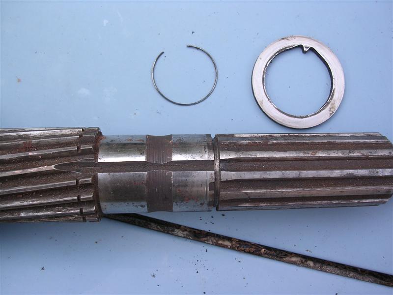

    I don't see any PO grinding mods to the shaft. What I see so far, is a single tooth cut on the spiral teeth for 1/R sliding gear. I believe that is cut like that to be able to get under the thin snap ring that has almost no end gaps...or it might be where the milling operation stopped, when cutting that trough? I'll look at one today.
    Then I see the extended spline groove which is for the tang on the thrust washer for 2nd gear,
    and the lengthwise oil trough under 2nd.
    Did I miss something in the pics?

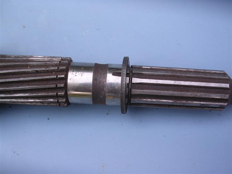

  5. F&J
    Joined: Apr 5, 2007
    Posts: 13,291
    F&J
    Here are pics of the mystery hidden "snap ring" that is under the real snap ring that holds second gear on.
    I did not show the "normal" main snap ring.
    One pic shows how it sits in the bottom of the ring groove (look closely). On that pic, I installed the second gear thrust washer that has the locating tang on the ID. I was wanting to see if it could be installed with the tang 180 off, which might block oil to that long oil groove in the mainshaft surface. Lucky "us" as that oil groove is a bit too shallow to let the tang fit there. That is good news in case we thought we put it in the wrong spot, as this is mostly hidden with 2nd gear installed. The tang only fits that one partially elongated spline.
    Back to that hidden ring. It measures .034" (a used one). It is most likely stainless steel, not tempered. It will hold second gear on if the thrust washer is installed, as the tang won't p*** over it. (as long as the ring gap is not lined up with the tang)
    I just can't figure out what the whole point of this ring is. I thought maybe it keeps 2nd gear on, during a trip down the transmission ***embly line at the factory, but that makes no sense, as the real snap ring would do the same thing. If GM had the groove cut too deep for a standard snap ring, why would they not change the design;... so that's not the answer either.
    Any ideas?? I just don't get it, but I sometimes miss the elephant in the room.

  6. AD_NAPCO
    Joined: Mar 14, 2008
    Posts: 423
    AD_NAPCO
    I checked and these dimensions will definitely work. Thanks for checking on that for me! BTW, how do you like driving your car with this trans? I have not gotten a chance to go through your build thread yet but I will be sure to check it out.
    I have no idea either, Frank, but to be completely honest, as my dad would say, I'm as "green as a gourd" when it comes to transmissions. I'm learning a lot just going through this process, with help from you guys. I know I didn't see a ring like that in this box, but after everything I've run into so far that doesn't surprise me.

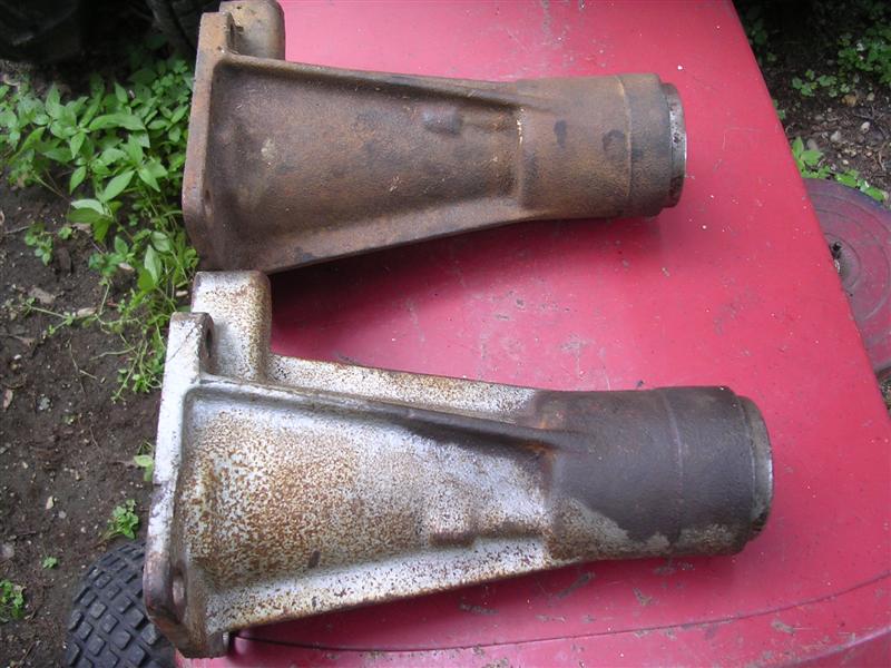

    I've been looking into the Olds transmission tailhousings. I found an odd one that came from a very old modded Buick topshift that has all Olds internals; it came out of New Jersey with no known history...
    This housing is 1/4" longer, not counting differences in seal protuding beyond the tail. It is night/day difference in the cast material to support the rear bearing...

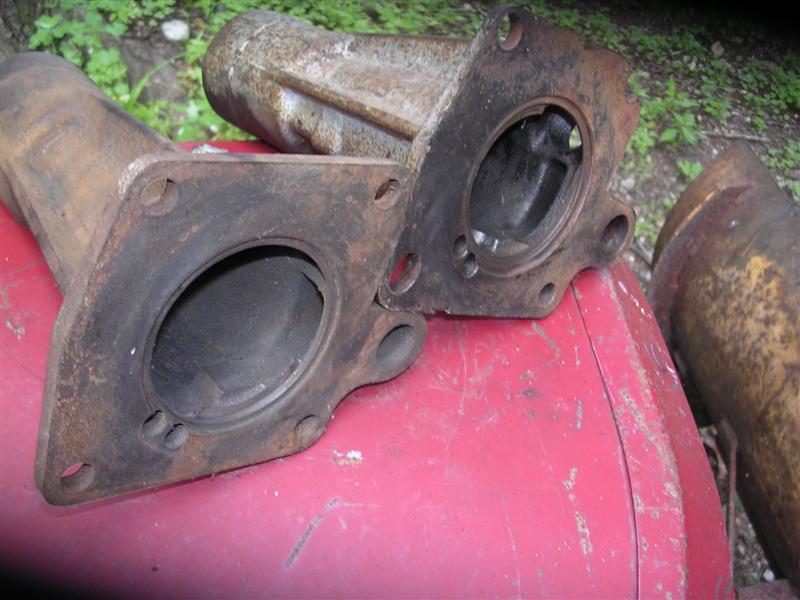

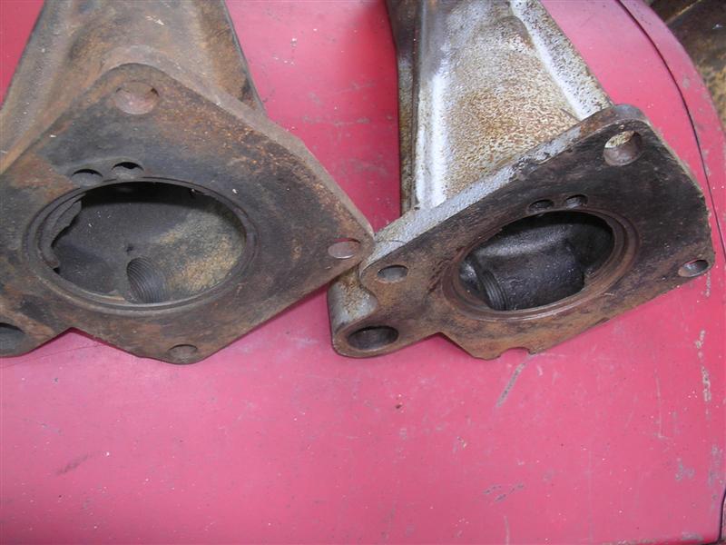

  20. F&J
    Joined: Apr 5, 2007
    Posts: 13,291
    F&J
    Correction to make on part numbers I just posted today;
    The 88/S88 Police/Taxi is the same part number as 1952-1955 98. (98 is supposed to be longer). So, that means the Police one is longer than a regular housing, right? But I don't know how much longer the 98 mainshaft was? It can't be just 1/4" longer, so if that is true, what is my 1/4" longer housing?
    Pics show the silver colored housing, modified for Buick with elongated holes. I tried to show a view so you can see the bearing support part of the casting is close to 1/4" thick. That would be the deeper step. The regular ones vary from a bit over 1/16" to just under 1/8".
    The silver one might look broken in one spot on the bearing support area, but that is the same casting void that was made to clear the speedo drive gear ***'y. The other housing also has that void, and that seems to be where the weaker ones start the cracking.
    The inner "core" casting is different. There is a small raised rectangular cast area, and the silver one has the extra meat going inwards more by looking where that block ends. So, it is different cores, not just a casting shift.

  21. AD_NAPCO

  22. F&J
    Joined: Apr 5, 2007
    Posts: 13,291
    F&J
    Standard trans were rare past 55-56.. I have heard that from many older Olds race guys. So, chances of finding a newer one, go down, rather than up. Also..., I have been glancing at a few 57-58 parts in the book. There was the new bolt-on rear yoke in 57, but there must be a huge change inside; because the rear housing, rear bearing, mainshaft, speedo drive gear, etc etc, all show a new number in 57. I would not chance buying a post-1956 part, unless you can match it in person, but the book says it's different, so why chance anything?
    I took the only "mainshaft measurement" listed in the 58 book; that was 23-3/4" long for a 52-55 98..then measured a random Olds one I had handy, at 19-7/8" approx.
    So, my 1/4" longer housing is for the shorter trans. But what is it from?
    The silver housing casting number is 1165430-1
    The common ones are 1343949-3 (and I have other single digit suffix ones here, like -4)
