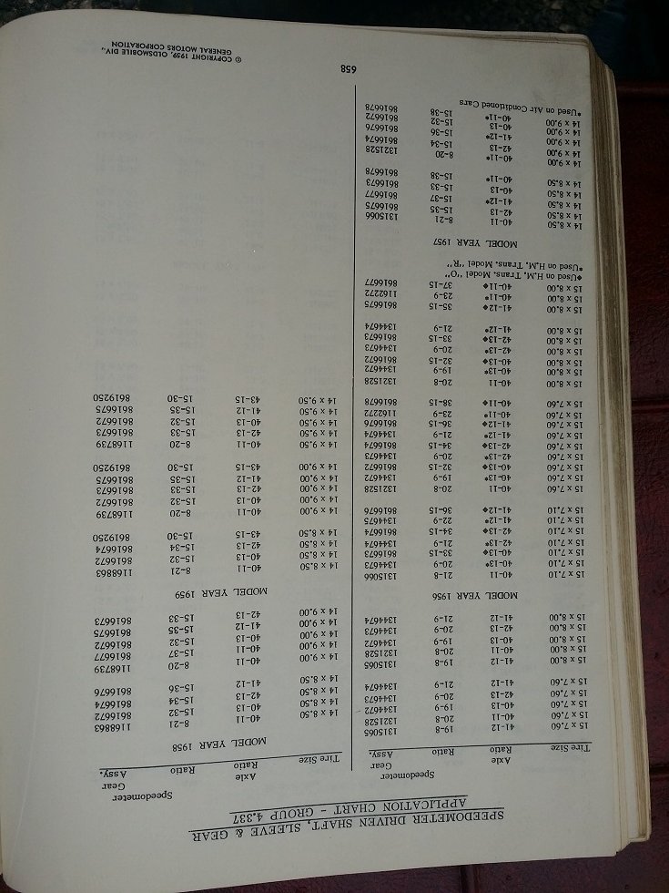

  26. Paul
    Joined: Aug 29, 2002
    Posts: 16,956
    Paul
    Editor
    from the back of the book I think F&J referenced,
    sorry these images are not displaying right side up,
    'tried for fifteen minutes, and I am no computer dummy..

    I tried again this morning to figure out where the heck the "optional" numbers are for the "drive" gears ..
    I simply gave up; Lets look at 1954 for example, this above chart shows on the "ratio" column, that there is 8 and 9 tooth drives? That must be what the 8 and 9 are..
    ..but go to the trans section, look up drive gear for a 54 88/S88 stick trans, and I only see one gear listed...unless I am missing something.
    If there is an 8 and a 9 tooth drive gear for 1954 for example, what group number, or where in the book, is it?
    I don't need to know, I just wanted to know :)
    Maybe I should go back and do page to page, in the back of the book...maybe I missed that group section?
