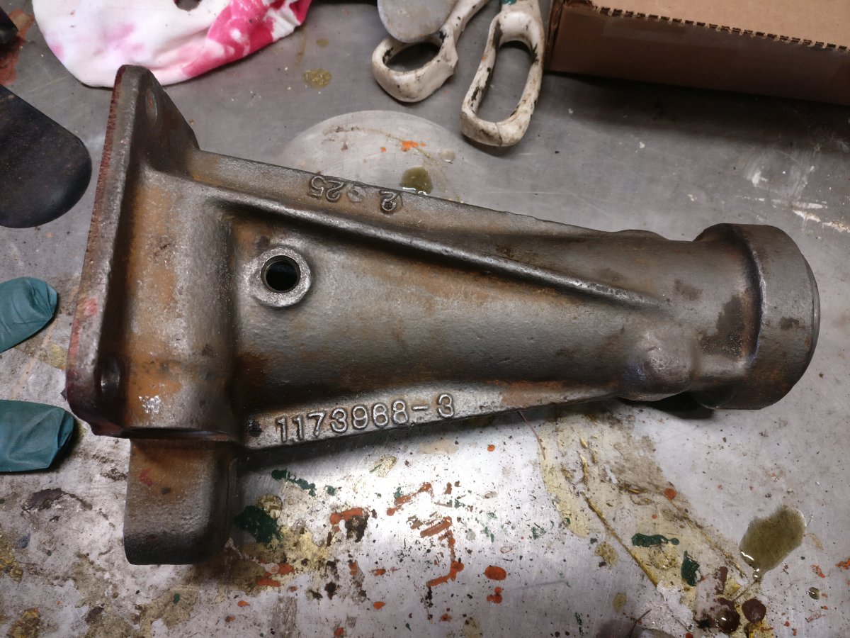

    Found this thread by searching casting number.
    I have an Olds tail housing I am not using, casting #1173968-3. Does anyone need it?

    need pics of the big end to see if the thrust plate is broken and the overall length

    @*****in' Rat Fink I would be interested if it doesn't have the broken thrust surface that mine has, and like Walt says, need the overall length. I can't remember my casting number off the top of my head.

    can't remember seeing one with a pipe plug hole in the tail like that......now I am curious!

    Later this week when I'm in the shop I will get you a length measurement. I haven't looked it over very closely for cracks yet, so I'll do that as well. I will post better pictures below.
    That hole looks to be for the vent on top.

    yep, for the vent! Looked a lot bigger to me in the first smaller pic. Both of those look to be good in the thrust plate area.
