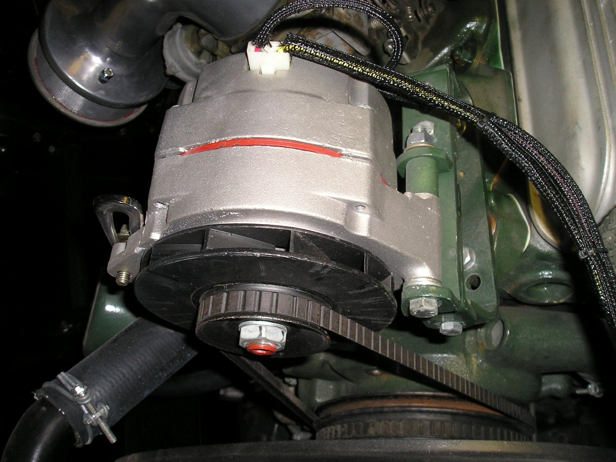

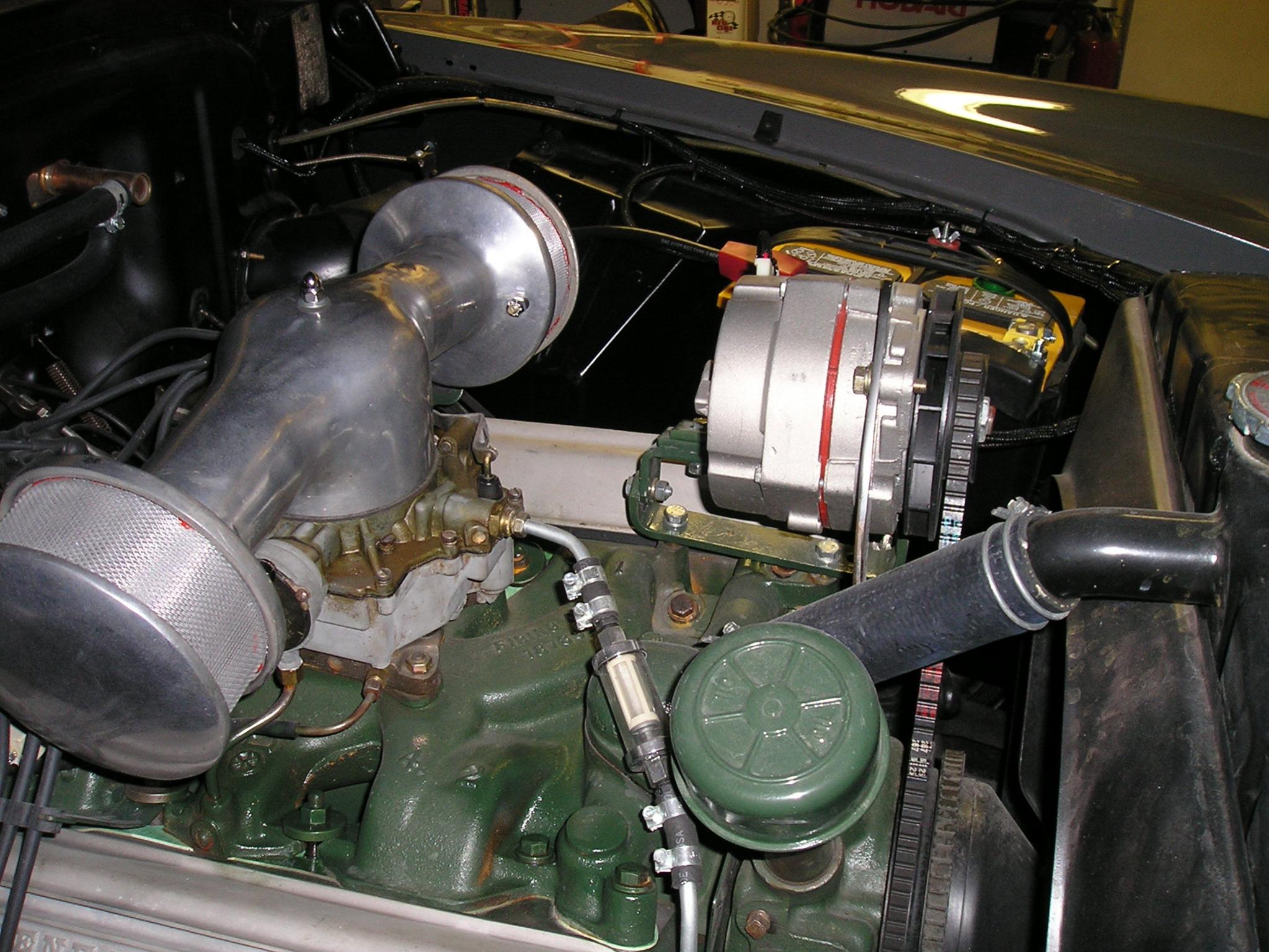

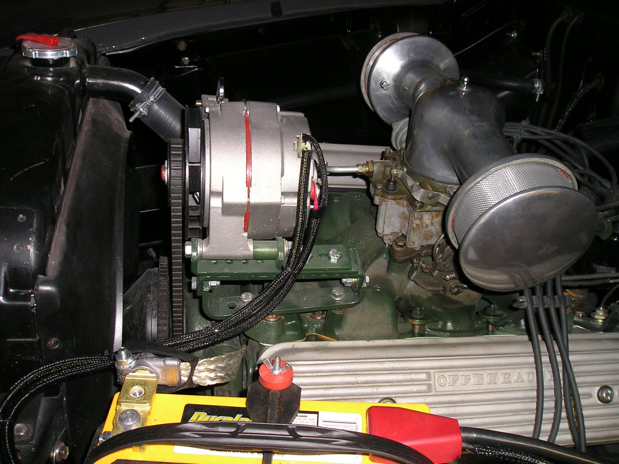

    1950 303 with a 1955 324 top end on it. The 4 bbl did/does have an insulator under it.
    The drilled holes in the 324 intake were for a power steering pump and somewhere on th HAMB I have seen a pic of a power steering pump bracket used for an alternator. The bolt holes in the intake are not parallel with the crankshaft pulley. The power steering bracket is shaped to allow for this. I used the base from a 1950 generator bracket, a part that I got with the alternator and the standard aftermarket Chevy top bracket cut down and redrilled. I had to space up the base bracket to clear one of the intake to head bolts. Pics attached.

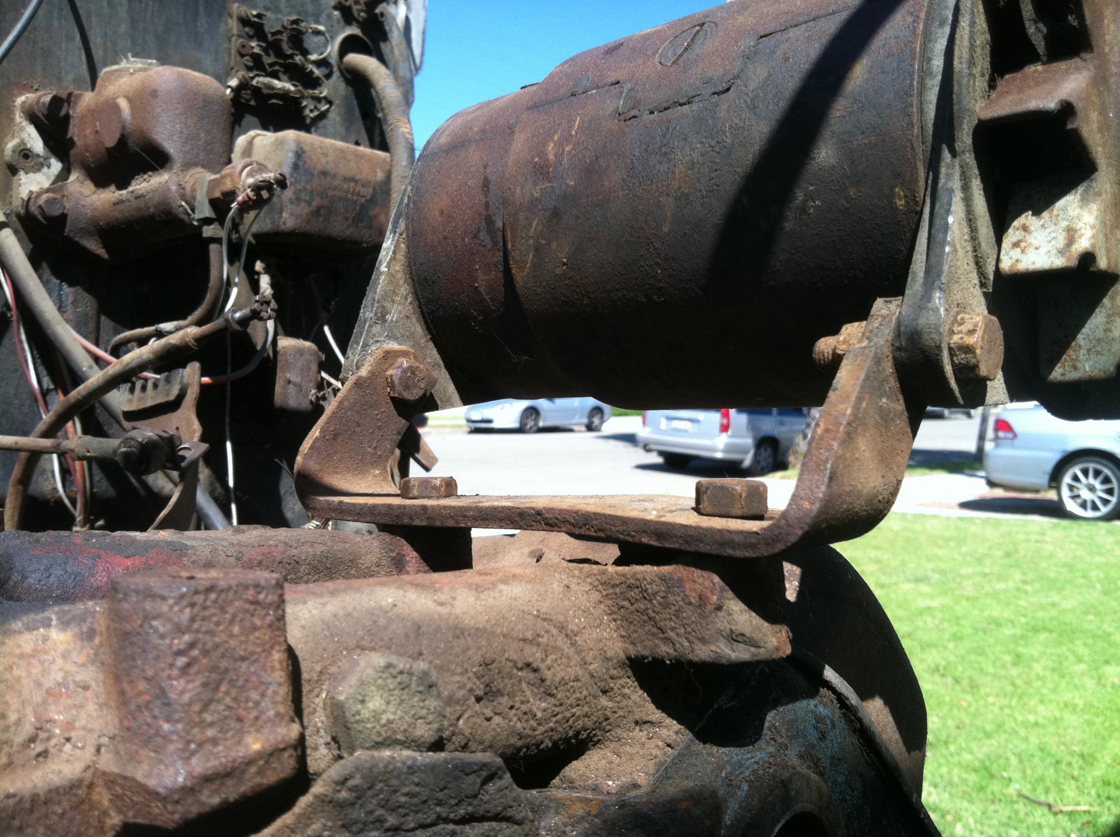

    I went out to look at some of my spare motors, two have the generator mount on top, the rest have them on the side, at least one of the 303 4bbl intakes has no bolts for generator or power steering, at least one that has the generator on the side does look like it uses the same stamped bracket that the two on top versions use, the others use a cast bracket, either bolted to the exhaust manifold 303/324 or the head 371/394. the late 394 has a neat alternator bracket that bolts to the front of the head but because of the block being longer than the early motors it won't work on them.

    550Coupe, that's a great couple of pics, just exactly what I needed and I think that's the way I'm gonna try and go. As it stands now, when I put the generator back on top where it was when I got the truck ,the pulley does not line up. It seems to line up when it's on the side however. The hole on teh water pump is drilled and tapped for an adustment bracket there, it was just full of crud. The local auto parts store has an alternator bracket in stock like the one you show, 550, so I'm gonna go snag that and see about fabbing up a base bracket from a piece of plate steel I have here.
    Bobert, that looks like a pretty slick setup, but as of now I'm going with a generator. I just like the look of the old tech... BTW, what is that air cleaner from? That is wild! I need an aircleaner for mine and the stock style is just too massive...

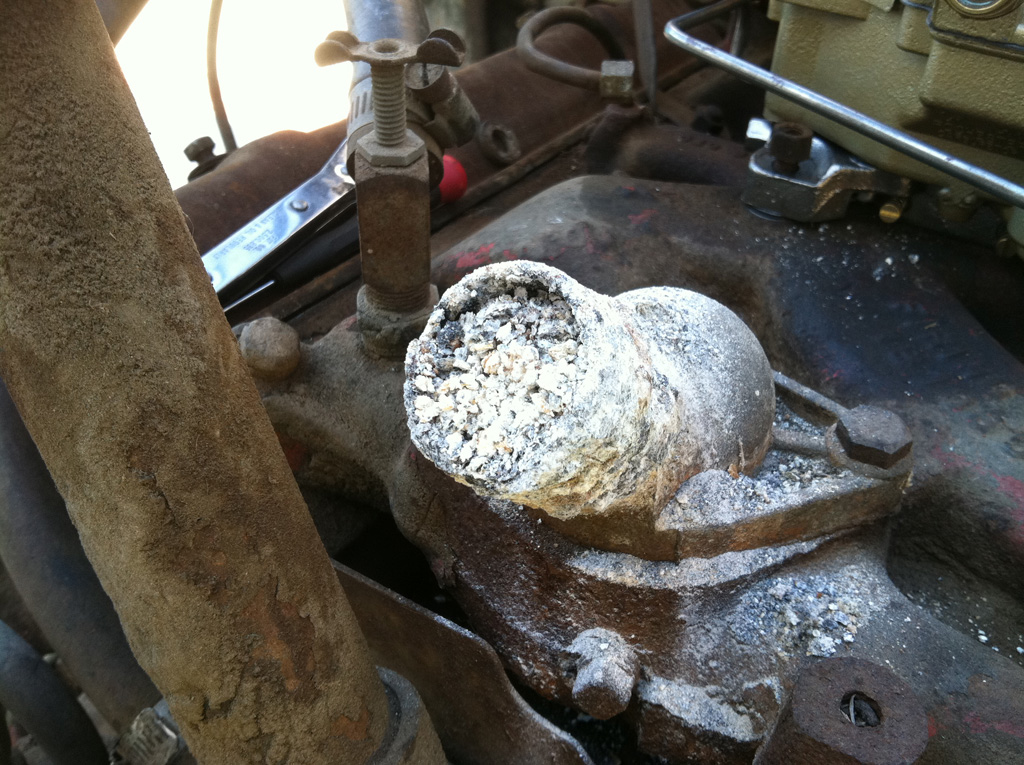

    In other news, in the process of fiddling with the generator I decided to pull the top radiator hose off the thermostat housing and holy shit it's full of what looks like ashes!
    Never seen anything like this before... Vacuumed what I could out, and went to take the bolts loose and of course, they both snap off at the head... Luckily not any lower. Left me just enough to work with. Thermostat housing was aluminum and the neck is eaten to nothing... Gonna need a new one.

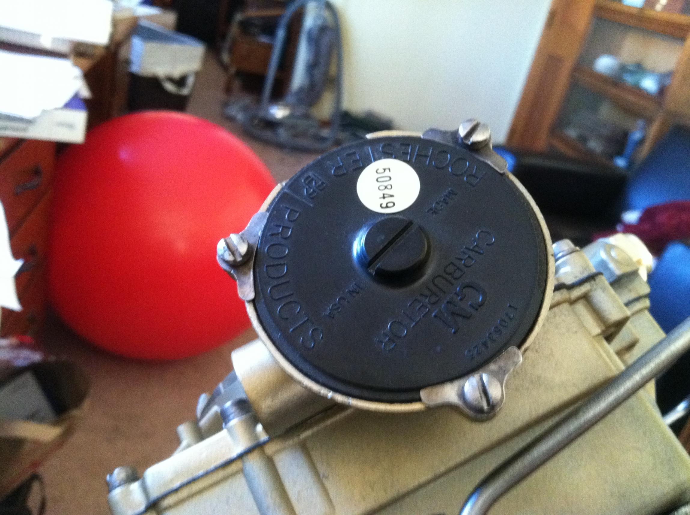

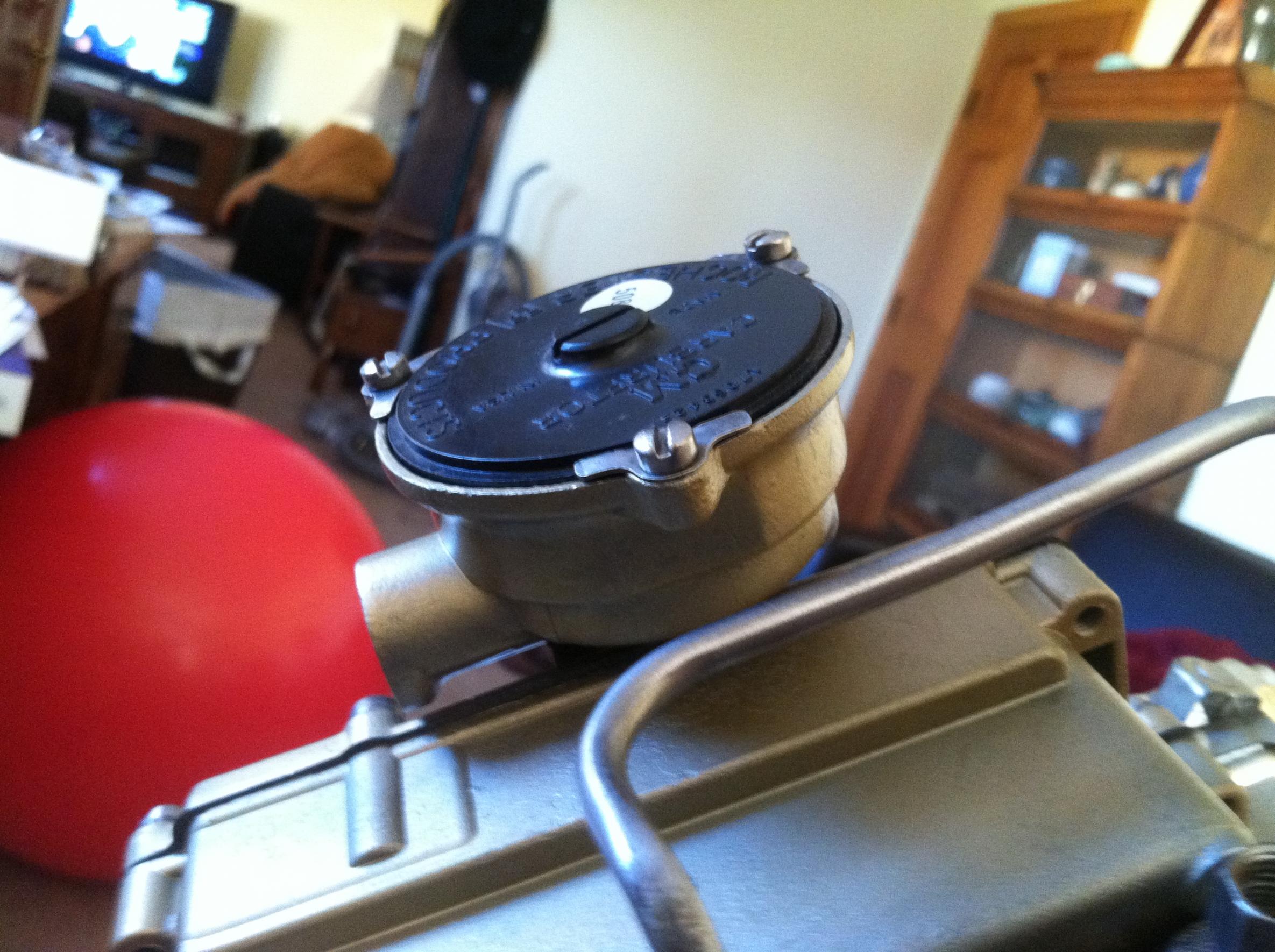

    Also couple questions about the carb I just picked up. It's a #7007221 and It's missing a vacuum port on the choke coil housing that I notice is present on Bobert's rig, as well as a few other's. I have the vacuum line coming from the manifold and it was hooked up on the AFB that was there before.

    They must have change to an aluminum thermostat housing in '56. The '55 is cast iron.
    The air cleaner is a "no name" (somewhere I heard that it was a "Century" produced in New York) that I have on permanent loan from my brother-in-law. I remember him using it on an early 50's Caddy in 1958. I've not seen another like it that fits the early 4bbl. The elements are just wound up window screen for which I need to really get some black prefilter material to put around.
    I changed to the alternator when going from 6 to 12 volts but understand why you want the generator. they do look better. I didn't have enough room on the right side of the engine to hang anything off the '55 exhaust manifold generator mount without modifying the inner fenderwell. the car is a '50 Olds. Left the mount casting on the exhaust manifold for "future generations".
    There isn't a vacuum line on the choke housing. What you see on the choke housing goes to the exhaust hot spot under the carb. The carb is a 1955 and didn't have the linkage dash pot as on the 1956. The vacuum line low on the carb goes to the distributor.

    I don't think my thermostat housing was stock. It didn't mate up properly to the intake anyway. I'm going to need a proper cast iron part to replace this POS.

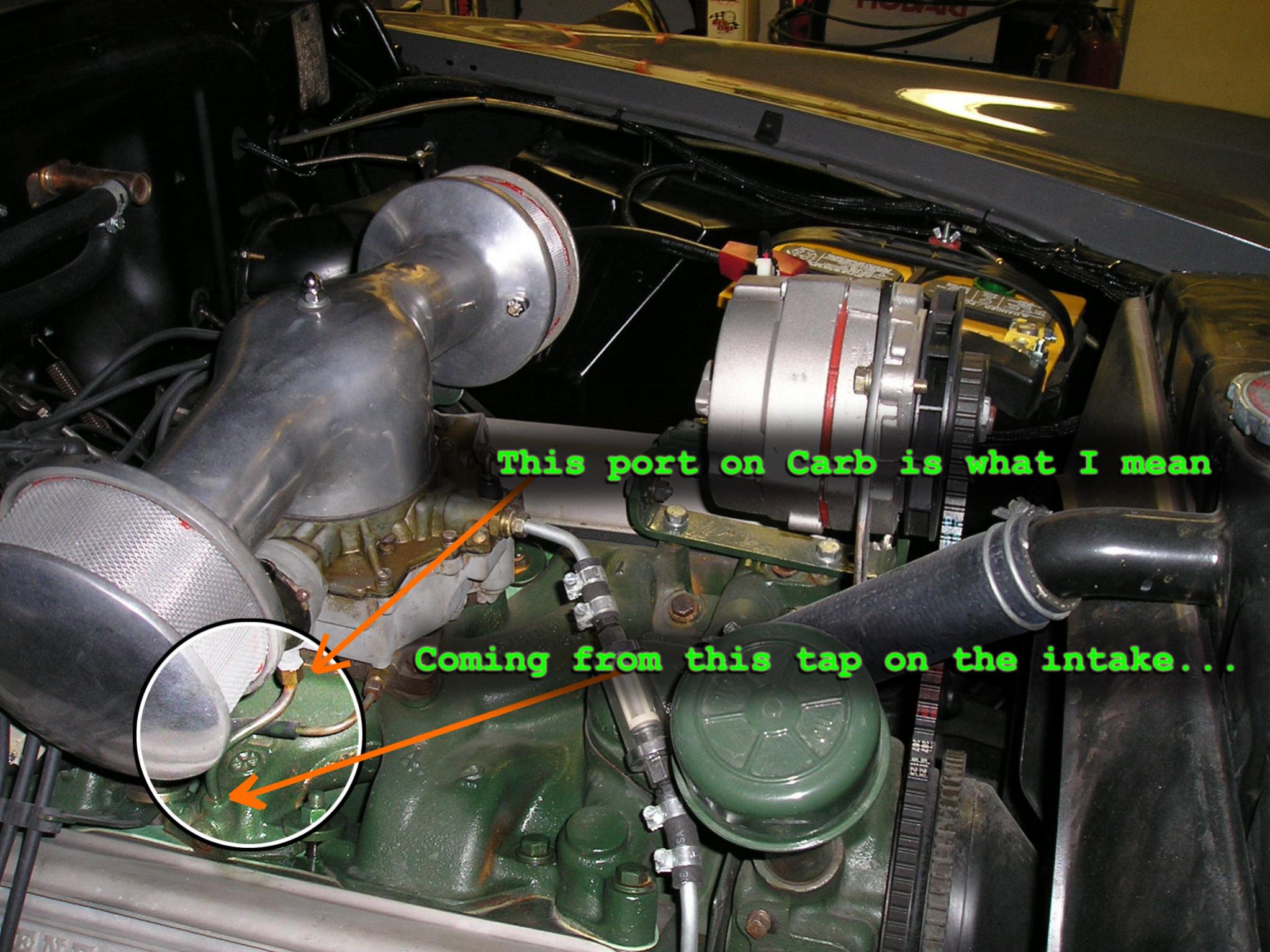

    I'm still confused on the carb to intake vacuum line (I'm assuming it's a vacuum line) issue... So I attached an image to clarify.

    That line is getting it's vacuum from inside the round choke cover. It draws hot air up to the choke bi-metallic spring inside the black cover, then the spring heats up and opens the choke.

    F&J... That's exactly what I thought, which is why I'm confused as to why my carb doesn't seem to have that vacuum port... If you go back to an earlier post you'll see where I'm asking if I need that port or not. I got the carb number to look for form "CarbKing" John of the Carburetor Shop in Missouri, and he said either 7007000, or 7007221 would do the trick. I got a 7007221 and I'm wondering now if it was built correctly.

    I just looked at pic #6 in post 34. I can't see much of the choke. I think I recall from decades ago, some GM carbs had the pre-heat pipe going to the center of the black cover. Do you have a threaded nipple on the center of the cover?
    ...or put up pics of the choke side.. The choke needs to get heat from someplace, either hot air, or electrical terminal if it was converted to electric type.

    F&J... Looks like I get to have a chat with the carb rebuilder... Unless I'm totally missing something, there's no heat to the choke spring.

    you have the wrong cover on your choke housing,
    that housing is meant to have a nipple at the center of the cover where the screw driver slot is

    Yeah... I just sent the carb rebuilder an email asking for a replacement part. We'll see how that goes.

    Jon probably has books to look up that exact number and tell you if the choke housing is wrong or if the cover is wrong.
    I don't trust my long ago memory ...did any GM makes have a 4 barrel with a cover with the heat pipe going into the center? I think I see it in my memory.. :)

    Well, the rebuilder already responded and said he'd send me the right cover, but I'm skeptical because I've seen several pictures of carbs with the housing with the port at the bottom of housing and none with a pipe to the center of the cover... I'll see if Jon will set us straight before I accept the cover... Should I assume the functionality would be the same? Heat to a bi-metal spring is all we are looking for, right?
    EDIT: Google is your friend... Just checked google images and I looked for 7007221 and all the pictures of the core carbs show the threaded nipple at the center of the cover. So, that must be one difference between the 7000, and 7221.

    my '56 shop manual shows the heat riser connection at the center of the housing cover.
    also as per the three bolts on the top of the manifold for bracket mounting,
    apparently these were not for mounting a generator or power steering
    they were for mounting a supercharger :)

    Take a look back at my original post. Show the front of the alternator wedged up to tak care of that. As explained the power steering bracket that was intended to go there took care of the problem with the bracket shape.

    Correct. That bracket is what I used and redrilled for my base.
