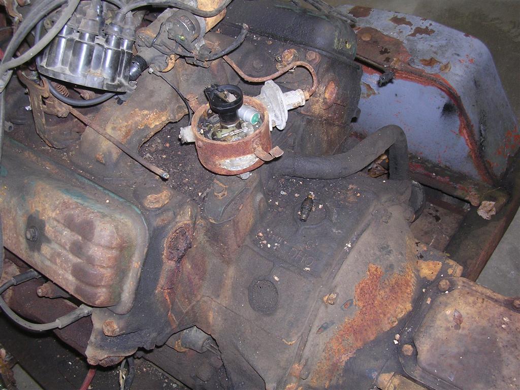

    This one's off a '55. Should be the same as yours. and F&J's right, just a Y shaped piece of metal. About 3.25 inches long, just shy of 3 inches wide at the widest point, and just shy of an inch at the narrow end.

    Thanks for the pics, Canuck... I should have a stock clamp on the way from a guy that was parting a 324.

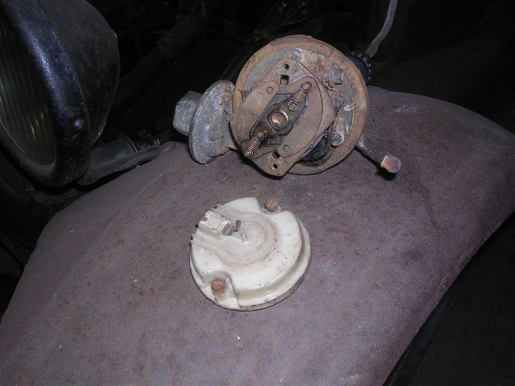

    One thing I just noticed when I took the rotor off is that i have one spring on the mechanical advance weights that is badly stretched. I'm wondering if that could be a big part of my problem seeing as the centrifuge is basically lopsided.
    I have been searching all morning online and have come up with zero sources for a distributor advance kit for a 56 Olds distributor.
    Anyone got a source? Can anyone tell me of another application that they know will work? The local parts robots can't seem to help much.

    I've had that on hot wired engines before. Either use a ballast or a internal resisted coil while test running. If the points are really messed up, it can cause it to misfire and flame up.
    If it is a real 56 dist, it should be close to the SBC design as they both have the window to adjust the points. The springs may be the same or close enough. It would not suprise me if the pull rates were slightly different on the chevy springs, but I think a recurve kit would have several?

    I'm using a ballast resistor and a coil intended for external resistor. I spoke with Jim Lindor "GMC BUBBA" on this board and he said that the basic recurve kit for an SBC or even later 50's or 60's olds will work so I ordered a kit that was actually listed for later 50's Olds from Summit along with a few other bits I'd been needing.
    I'm wondering if I should even attempt anything further until I get the mechanical advance at least properly sprung. Jim did say that the stretched spring would make it really hard to set the timing right, and I did check with a dwell meter last night, and noticed pretty erratic needle movement between 29 and 32 degrees, so I'm thinking I should leave well enough alone until that part of it is figured out.

    Pictures are the least I can do, I've been following this thread intently myself, learning all I can about these old Rockets, so I'm happy to contribute. And I'm glad to hear that you tracked down a stock clamp. Would have offered to ship you my spare otherwise.

    Here is a 56 dist and the earlier 49-55.
    Not sure if you can see the crazy looking circular ballast on top of the coil on pic #2.

    Frank, based on your pics mine is definitely the 56 distributor with the big rotor, thanks for verifying that for me... That ballast resistor on the earlier dist is indeed crazy!
