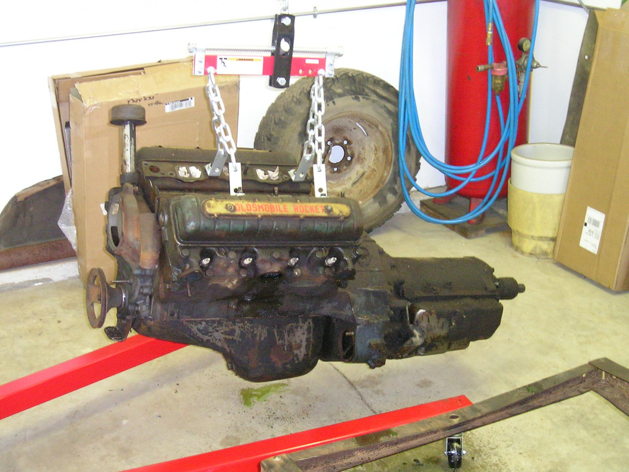

    Well, I feel like ****, but I think I'm sweating it out of my system. I managed to get the engine and trans pulled today. It wasn't that bad. It was a lot worse unhooking all the **** to free it up. Even so, I'm feeling whipped after doing that with a bad cold! Next adventure will be separating the trans.

    Very easy and quick since it is not a stuck motor. I ***ume you already have the lower half bell off to have drained the torus.... so then it's just a bunch of torus bolts, and a few bell bolts..and that's it.

    Actually, I drained the torus through the inspection hole in the flywheel cover. The plug was just about dead center of the hole so I didn't bother pulling the cover or starter. Good to know it's not a big deal!

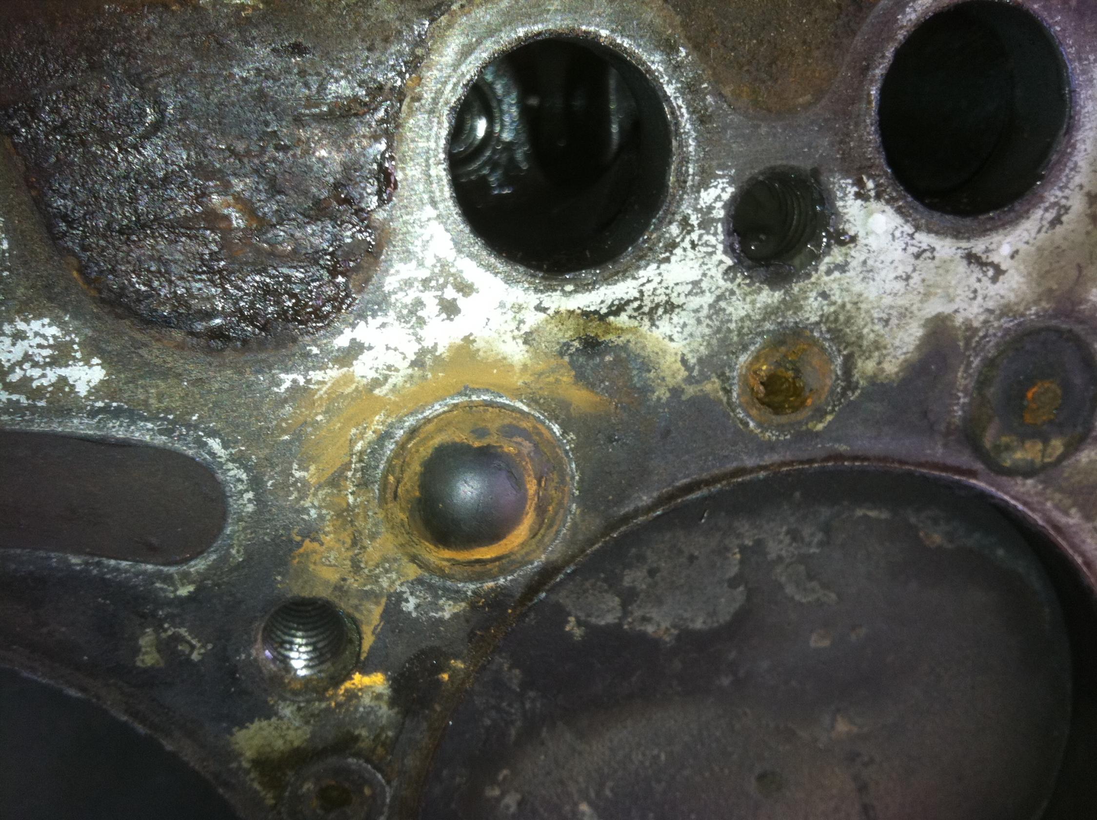

    Well, I got the trans separated, and the engine up on the stand. Got the first head pulled and put a dial caliper on the bores and it appears it's already been bored out to 4" with a pretty good ridge at the top of the bore... I'm not real enthusiastic right now.

    Well, Frank, I found an older thread where you posted some of DON_WOW's numbers.
    My block is V1039451 which appears to be a 54 block. The heads are #10's though.
    I had dad come out and look at the block, and he did the fingernail check and he said he thinks it'll clean up with a ridge reamer so maybe I panicked a little early...
    Do you guys have any idea what the rubber plug is to the left of and above the #2 cylinder? Looks like a water p***age blocked off and certainly doesn't want to come out, not that I've tried to force it. The close up pic is of the plug I'm referring to.
