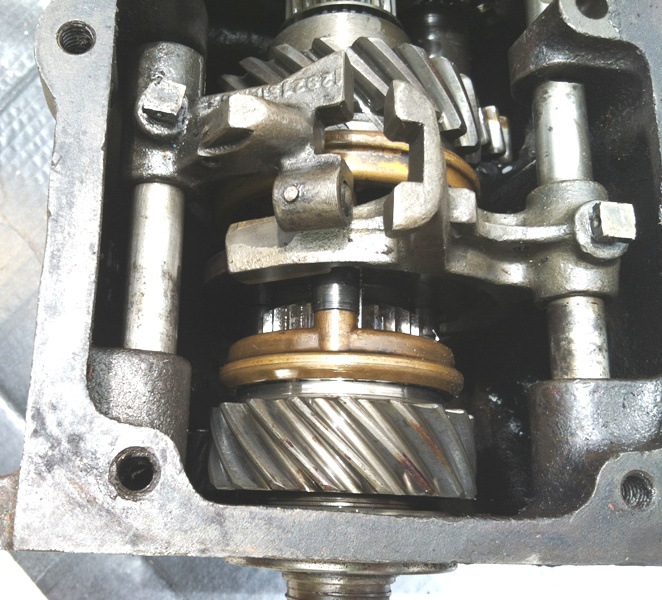

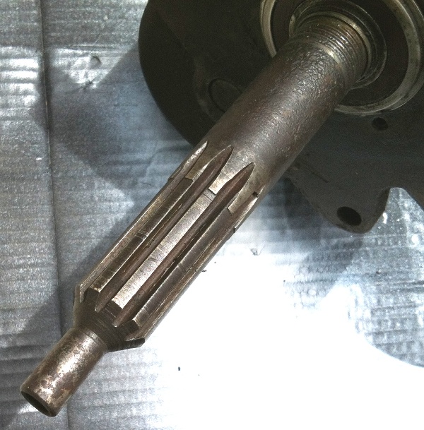

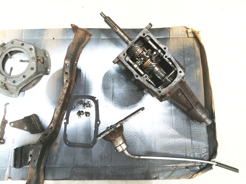

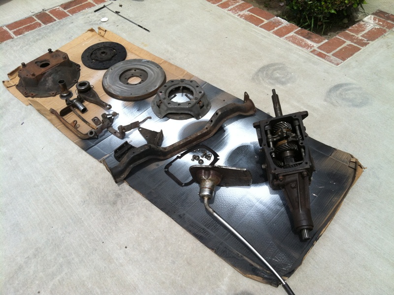

    Hey guys! Sorry for another long silence. My fiance and I left for an Idaho vacation the day that the Buick trans stuff was due to arrive from the UPS man, and I had just enough time to drag the crates into the garage before we rushed out to catch our flight.
    We were gone about eight days into our two weeks up there and got a call that her grandmother had a m***ive stroke. Had to catch the next available flight back down here to SoCal, and spent a little over a week with her family during grandma's p***ing and funeral. Had a few days to recuperate and catch up on things before the bachelor party weekend whitewater rafting in Nor Cal, and after two days recovering from that adventure, I finally got to drag the crates out of the garage and unpack them!
    I think everything is here. Only things I see that are issues are one broken ear on the top cover of the trans, and I don't have any clue how the pedal linkage setup is supposed to work. I'll probably try to adapt the stock GMC pedal ***embly to work with this setup. Anyone know what the proper bolt size on this setup is to hold the clutch and pressure plate on to the flywheel? I may have a tap that I can use to figure it out.

  28. vtwhead
    Joined: Oct 20, 2008
    Posts: 5,304
    vtwhead
    Looks great. Nice package with what appears to be everything you will need to plug and play! That crossmember is from an Olds but you probably already new that. The close up shot of the internals seems to show a snapring that is in the wrong place. Never had a 51+ ****** apart but I have had a 50 apart and I don't remember that snap ring being there. Perhaps F&J will jump in here as he has the identical set up and can speak from his experience with the gears etc.
  29. AD_NAPCO
    Joined: Mar 14, 2008
    Posts: 423
    AD_NAPCO
    Yeah, I'm hoping it all cleans up good and will work fine. I need to find a manual for the 37 Buick so I can figure out what the shift pattern is supposed to be. I think that crossmember is identical to the one I already had in the truck. I don't have a tap that will fit the bolt holes that attache the clutch/pressure plate. I might just take it too the machinist and see if has one. I need to get those two parts and the damper to him so he can balance the motor properly. Anyone know if there is anything special about the bolts that hold the flywheel to the crank? Will the Hydra-Matic bolts work? If not I need to come up with a set.
  30. vtwhead
    Posts: 5,304
    vtwhead
    Should have a std "H" shift pattern like any floor shift. Tony would know what size those bolts are.
