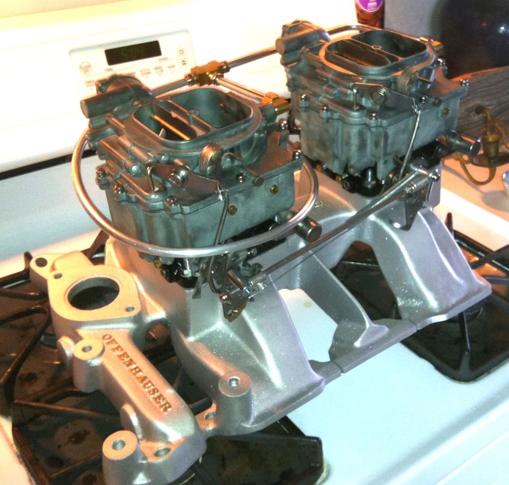

    I think this delivery from ****'s Hot Rod Carbs should motivate the 324 if the machinist ever gets done with it... I went to see him last week. The heads were done. Still hadn't gotten to the block. Patience... Must have patience.
    Dual Stromberg 4A's (53 Buick 4BBL's) on the Offy manifold.
    I'll make sure the wife-to-be doesn't catch me with car parts on the stove top!!

    Liking the 2x4's. I maybe regret not buying an edmunds 2x4 on ebay years ago for 200 b.i.n. It was 303, though. I don't go on that site anymore, so I can't possibly see something I don't really need :)
    That truck is going to really scoot, and should have piles of low end torque.

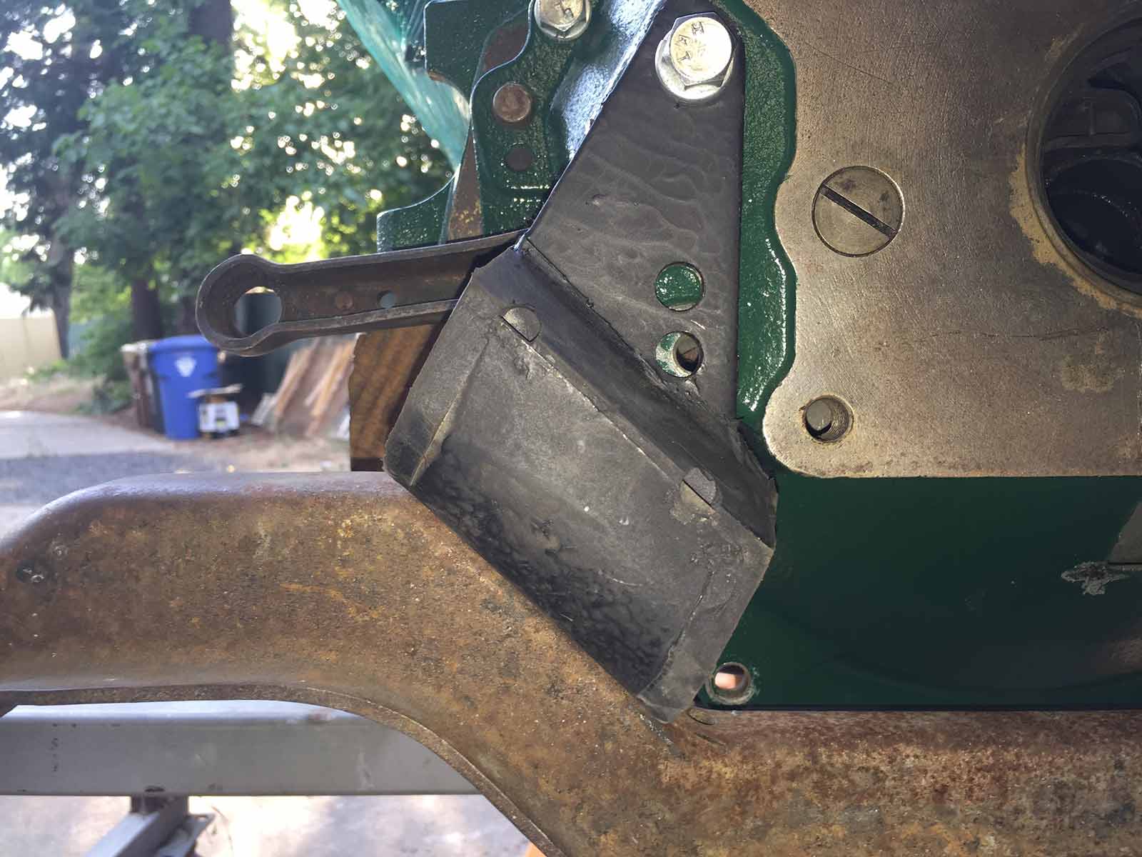

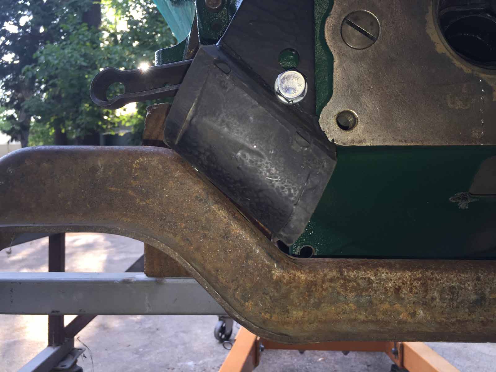

    Thanks, Walt! good to be back. Okay, so the major things that have happened with the truck since last I was active here... I found a much much nicer cab a few hours south of here. Bought that for far less than it would have cost in time and money to rehab what I had. Just sold off the old cab and doors, and got the new one mounted up.
    So the next step I'm going t undertake is solving the issue of the motor mounts and how that changed after I ditched the Hydra-Matic and switched to the 37 Buick 3 speed trans. So something has changed between the rear motor mounts and the cross member. The feet on the motor mounts seem to bee at a different angle than the mount points on the cross member. You'll see in the pictures, I think, what the bind is. In the one picture you'll see that if I have both bolts in the motor mount, I can't bolt the cross member up. If I remove the bottom bolt from the motor mount I can get the cross member bolted up but I'm have a hole off on both sides. I think the solution is to take a very thin pie cut out of the cross member under each mounting surface and lay it down to open up the angle to match the motor mounts. Once I get those angles to match, I'll weld it up and call the cross member done. Anyone see a problem with that line of reasoning?

    Only thing I can think of at the moment is that the AT cross member may be different than one for the std shift Olds. Seems I have run across that before if memory serves me right. F&J would know for sure as he has had much more hands on than I with the Olds trannies and such. Either way you will have to adapt for sure.
