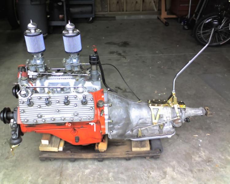

    FORD flathead, Mopar flywheel &starter, GM 700r4 AOD transmission.... 351856-1324949722-e2344e46b095ab119c785e056b14f65c.jpg

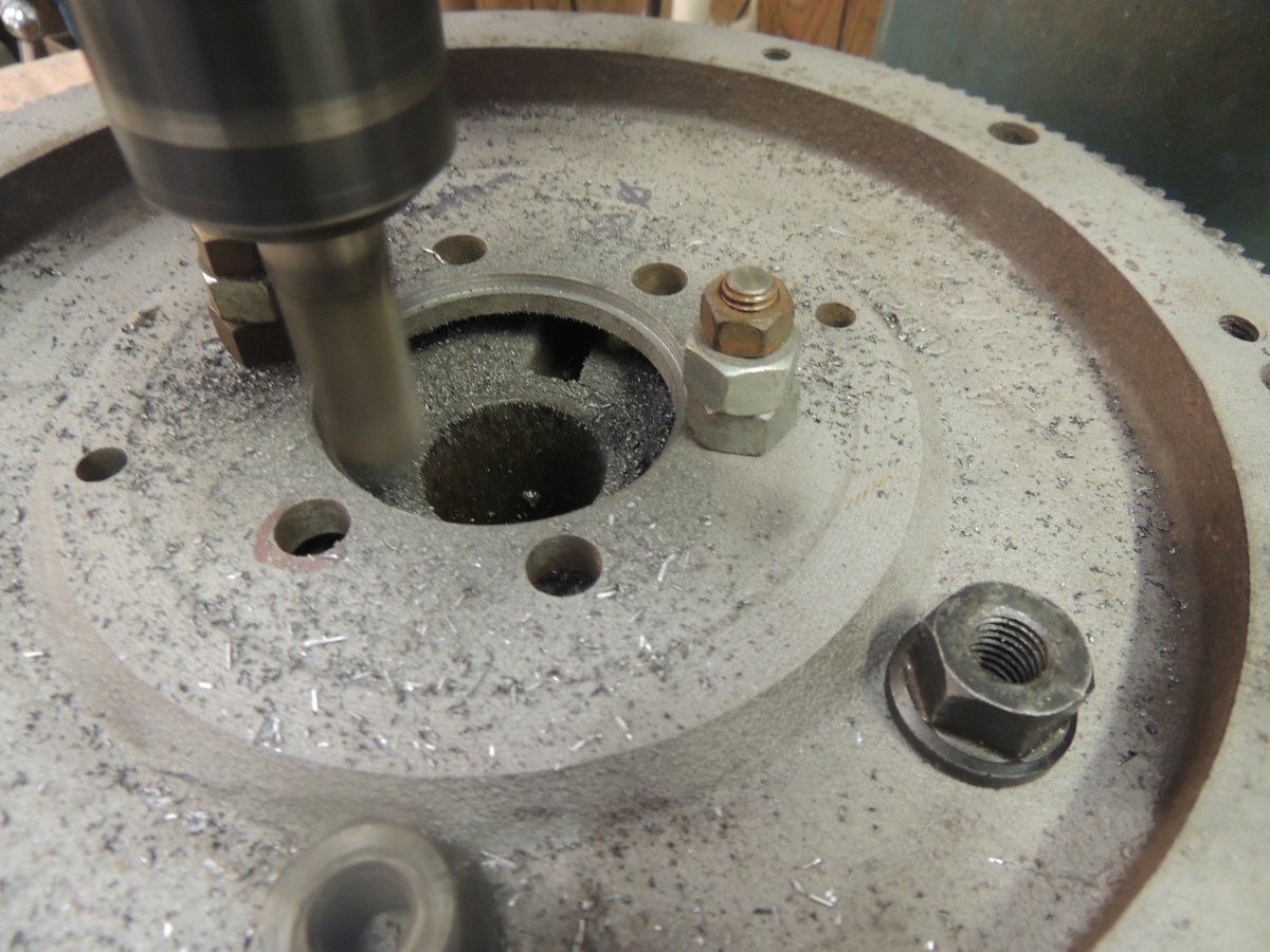

    Not to argue, and I use my lathe a lot..........I'm just saying you can do more things with a milling machine and a rotary table. You can make round and retangular shapes on it. The rotary table is the key to versatility. It may take a little creativity, but generally I can machine large holes in larger things than I can on my lathe.....and its a 15" swing. Recently I wanted to modify a flywheel by drilling a different mounting pattern in it and opening up the center hole. I have a $450 new aftermarket flywheel for a 500 Cadillac. I needed a second flywheel but didn't want to spend a lot. I bought a used Pontiac flywheel for $100. I couldn't get the jaws on my lathe chuck open enough to hold the flywheel and still clear the ways. So I put it on the rotary table and in a little bit I had the hole opened up and the bolt pattern drilled. I didn't bore all the way, only enough to clear the nub on the Cad crank. Now the flywheel fits either a Cad or a Pontiac, and its lighter than the stock Cad. Without the mill I would have had to buy another new flywheel.
    I probably use my lathe more on a daily basis, but most of the time its for small things like making something fit something else. Generally lathe jobs tend (for my use) to be simpler things and a lot of them can be accomplished with a little creativity on my mill. Most of the time anyone who has a mill will shortly start keeping an eye out for a small lathe to compliment it. Bestus is to have both available. I respect your opinion, and as always viewpoints differ. :D
    The same setup would easily resize a bellhousing as well as correctly drilling transmission mounting holes in the right places. Thats why I would prefer a mill. I have no problem with anyone who feels they would prefer a lathe.............but we do agree that having both is always best.;)

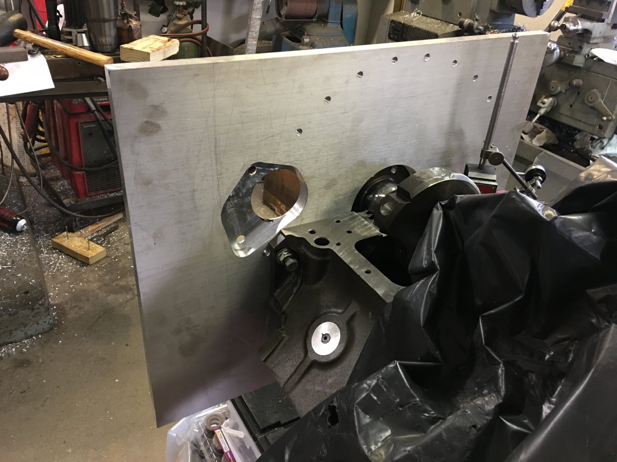

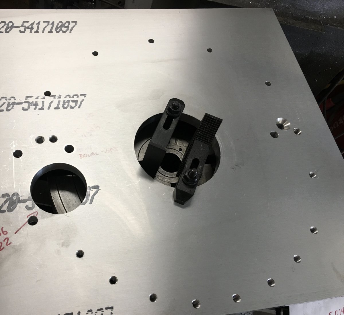

    I agree with ekimneirbo. I have a series2 biridgeport, with a rotary table, and a D.R.O. for locating. There aren’t many things I can’t make with it. I also have a “garage sized” lathe. It won’t allow any part bigger than a 7” diameter. I use this machine frequently for the things it can do, but there is no question that the mill is more of a universal go-to machine when combined with the rotary table. 92157564-9C9C-489B-995C-9FD7A6BFC7A2.jpeg
    This is posted in another thread, but Im making an adapter that mates my early hemi to a Lakewood ****tershield. The ****tersheild will mate to an overdrive version of a clutchflite transmission. I want the adapter to do a few things like eliminate the block saver plate, add mid mounts, mount O/T sensors.
    I bought a 3/4” thick 6061 plate 20x24 for $271.00 the cutoffs will go to other purposes.
