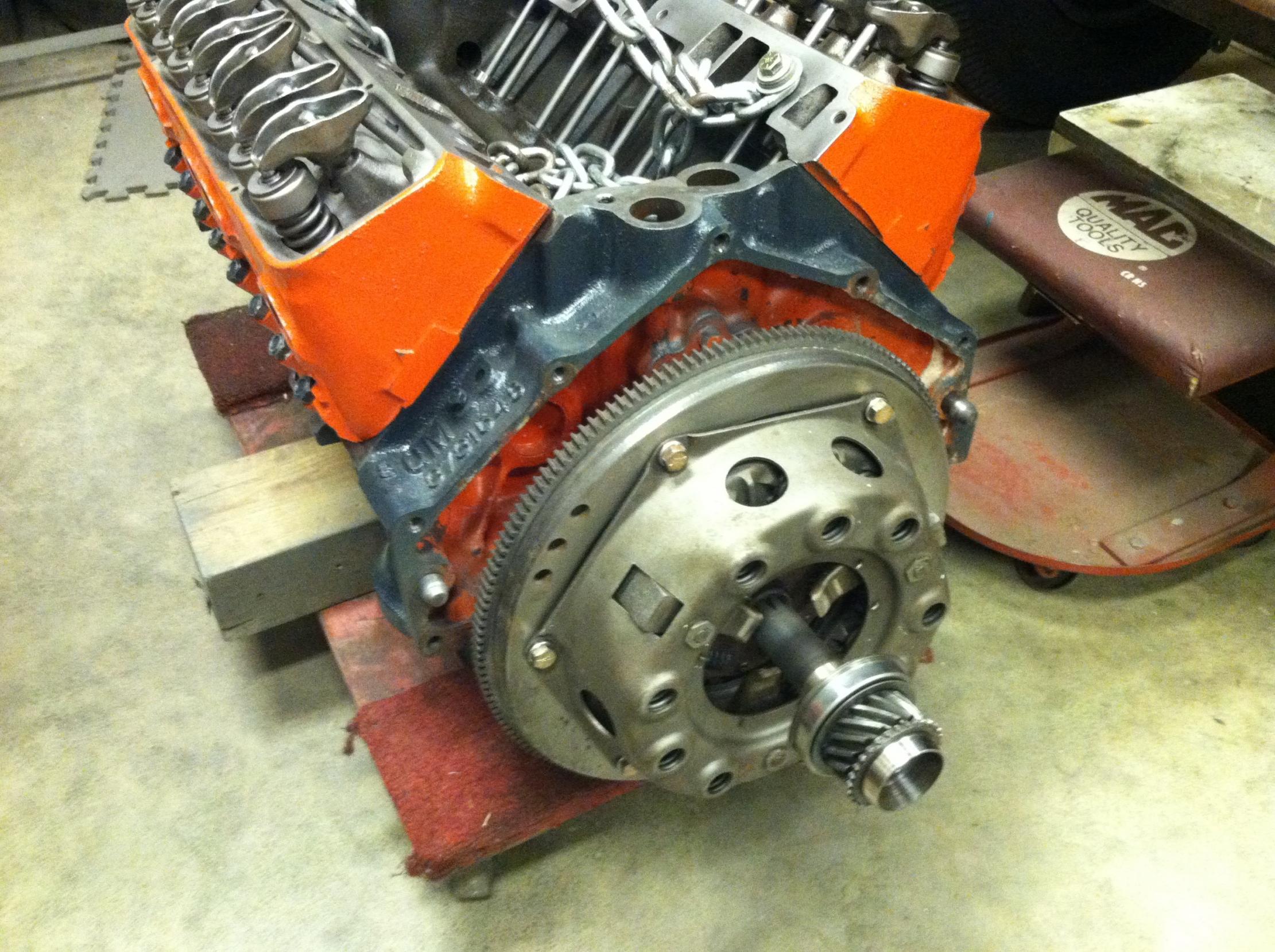

  9. F-6Garagerat
    Joined: Apr 12, 2008
    Posts: 2,652
    F-6Garagerat
    I have a 1957 283 and a 39 style trans. Found a vintage Speed Gems adapter bell housing at the flea market for $30. Score! There are new adapters available still from wilcap etc. but none for the Model A trans probably. Get a 39 style box.
  10. F-6Garagerat
    Posts: 2,652
    F-6Garagerat
    Here ya go. Merc pressure plate. Bolts right to the 153 tooth (10 1/2" I think) flywheel. Use a 39 type clutch disc (I think it's 9 1/2"). I think the chevy PP comes too close to the adapter bell or even hits, that's why you use the Merc. The Merc is also a Borg and Beck style (3 finger) while the chevy is a diaphragm type. With the Merc PP you use the 39 throw out bearing.
