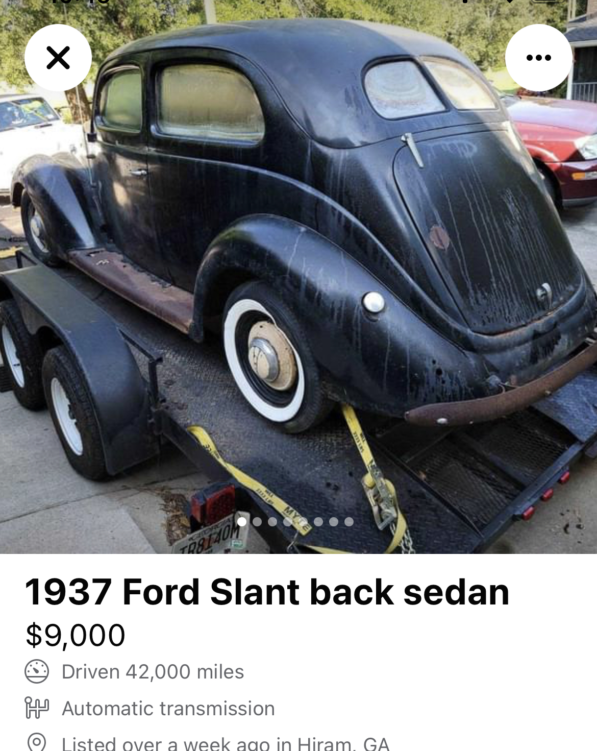

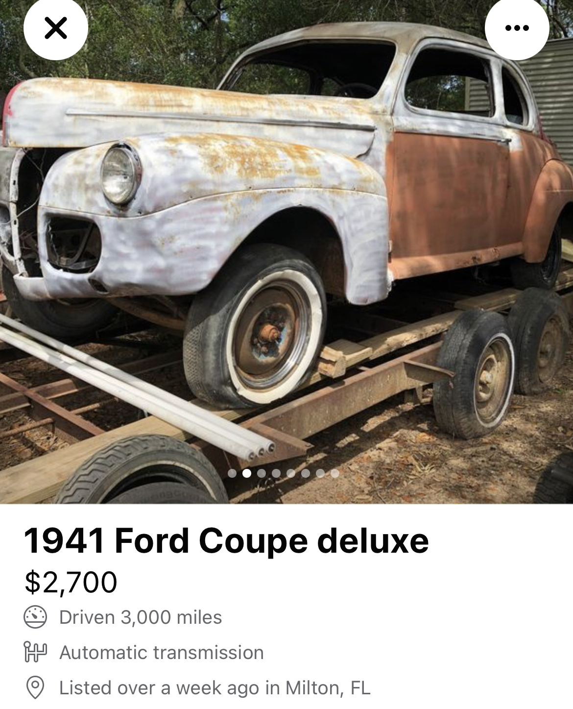

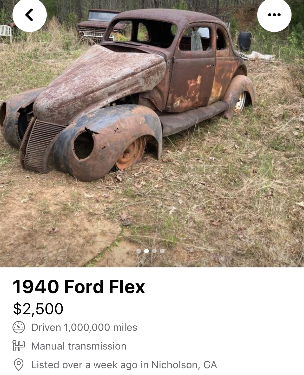

  3. Ok. I’ve seen 34-40 frame under a model A. Old round track beater. Looks awful but was functional for a round track jalopy.
    As far as $$$$$$
    It’s probably more economical to locate a body from 35-40/41( for trucks I think)
    Trucks being the cheaper of those years. Coups in those years are pricey

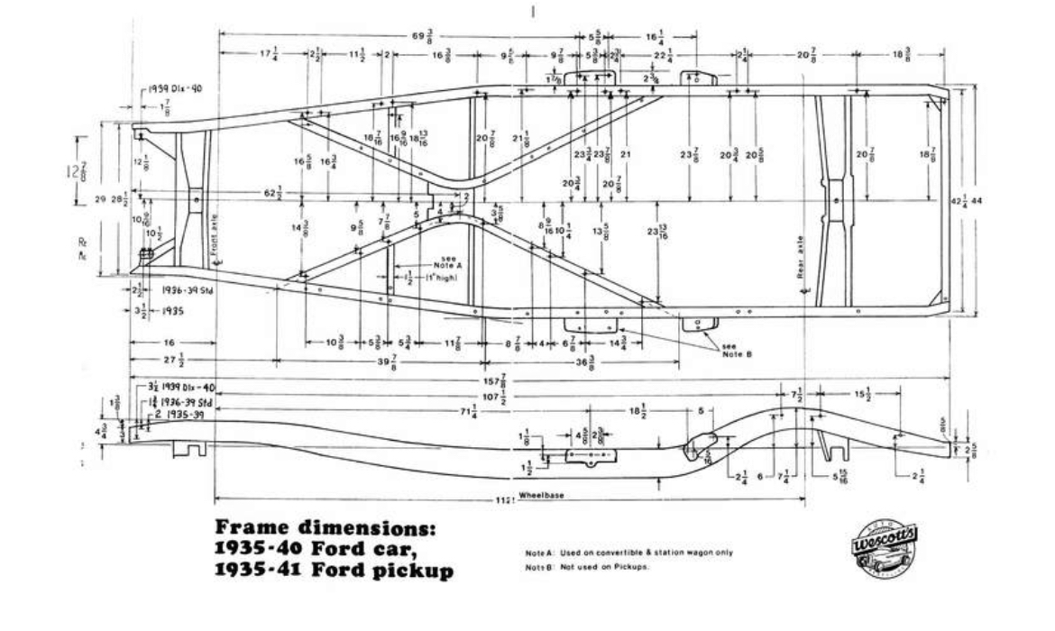

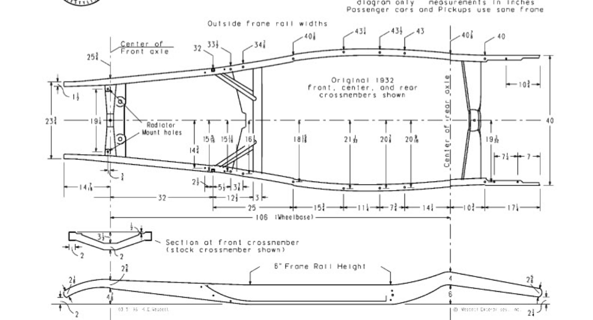

  4. E5226C0C-BEEF-4778-BDBE-9D772740585C.jpeg 53963B89-27AD-4147-994F-ACA75E63F12F.jpeg
    32 on bottom.

    I assume Tampa? Dang, I was gonna get you started with a ‘’36 cab and fenders if near by.
    I think (if I were in your position) I’d be on the hunt for a 35-41 Cab, etc. car bodies can get pricy, but then again I’ve no idea if you want an inexpensive build or a have fun build, etc.
    I think just about all conventional truck cabs/hoods, grille shells are the same for pu’s v 1-1.5 ton trucks. Only difference is the fenders
    i/e you can get a ‘38 1.5 ton cab, hood, grille and put it on your frame. You’d want 1/2? Tin fenders for the smaller wheel openings, although the 1.5 tons will work, but look off for a “pickup “ style flatbed.
