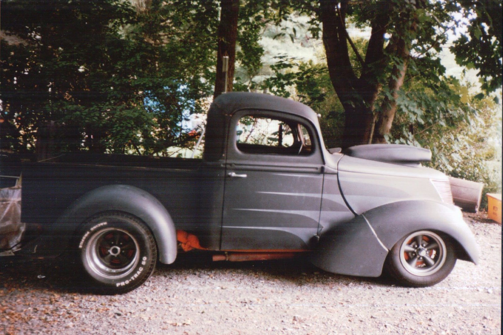

    put a 35/6 ford pickup body on it
    Outback likes this.

    Not true on the box not being wheelbase specific. 1) you don’t put an short bed on a 8 foot box frame or vice versa. 2) Model A’s as well as my ‘48 F1 have bolt holes and indentations at wheel section.
    Outback likes this.
  20. hotrodjack33
    Joined: Aug 19, 2019
    Posts: 4,720
    hotrodjack33
    Agreed, some boxes are wheelbase specific. A '35-'37 Ford box would work perfectly...or, as I mentioned, just build a box. Built the box on my old '40 Ford PU in an afternoon.

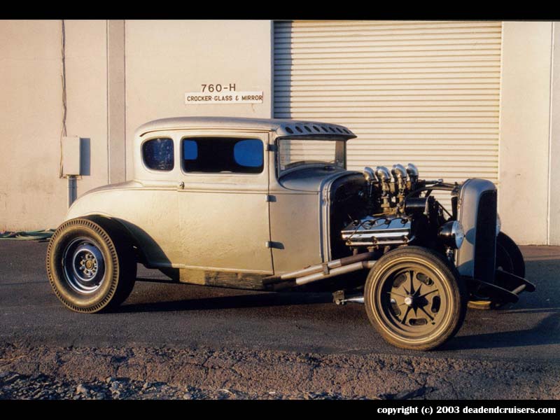

    His Name Escapes me right now but the owner of Circle City Hot Rods has a Model A coupe that he built years ago maybe his first hot rod that has a 35 to 41 frame underneath it I believe with the Hemi in it. It looks good but you can tell it's different
  24. Except Jimmy White has talent and didn't have to ask..........................
  25. Stole it off the internet. It looks to have a lot of cutting done to it to make it fit. Definitely not LEGOs. jwc2.jpg
    Outback likes this.

    Yep that's the one Jimmy White.
    Outback likes this.

    If my memory is still good with Jimmy's car that's not even a Ford frame. (Essex?)
    Now... just go do what you want – you're obviously set on it already.
