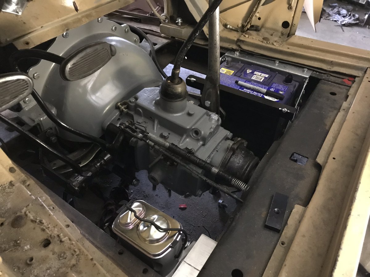

    34128E16-BB5F-4BBE-8D1A-1C94ABA2B781.jpeg I gave up finding an RTS trans and used a 3 speed all synchro mustang with a Jeep t150 shifter adapted to the torque tube ,,cheap strong and it works great,,

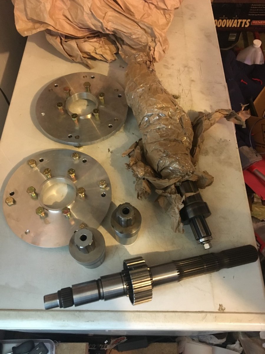

    I have done the jeep t5 using kato kings kit, I have also had World cl*** custom made T5 mainshafts made for the jeep T5. I made my own adapter based on kato kings design to fit my custom mainshaft. I am currently working on a World Cl*** s10 4x4 based closed driveline setup. Trouble with the T5 closed drive setup is Your only option has always only been in a Non world cl*** transmission. Both of my jeep T5 Closed driveline setups are world cl*** and so will my S10 setup that I am working on for my 34 3 window. If you look at the 3 splined adapters you see in my pics The one on left is from kato kings and the other two I made for my 2 custom mainshafts.

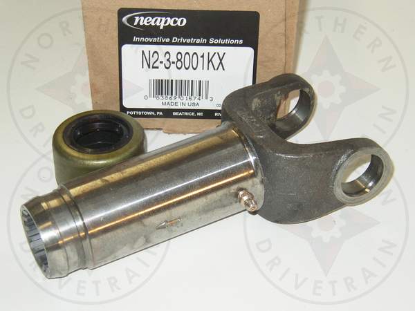

    I looked up the part numbers you posted here or on the Ford Barn in the past and wondered how the N3-53-1181 tube shaft was connected to the original Ford driveshaft (or if a tube driveshaft was used) along with wondering what, if any, modifications had to be done to slip yoke but the thread died with no further info.

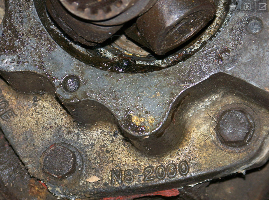

  12. That adapter was built by Nance engineering, I have one on the shelf. The casting has bosses in it so you can either bolt up the GM TT or the Ford TT.
