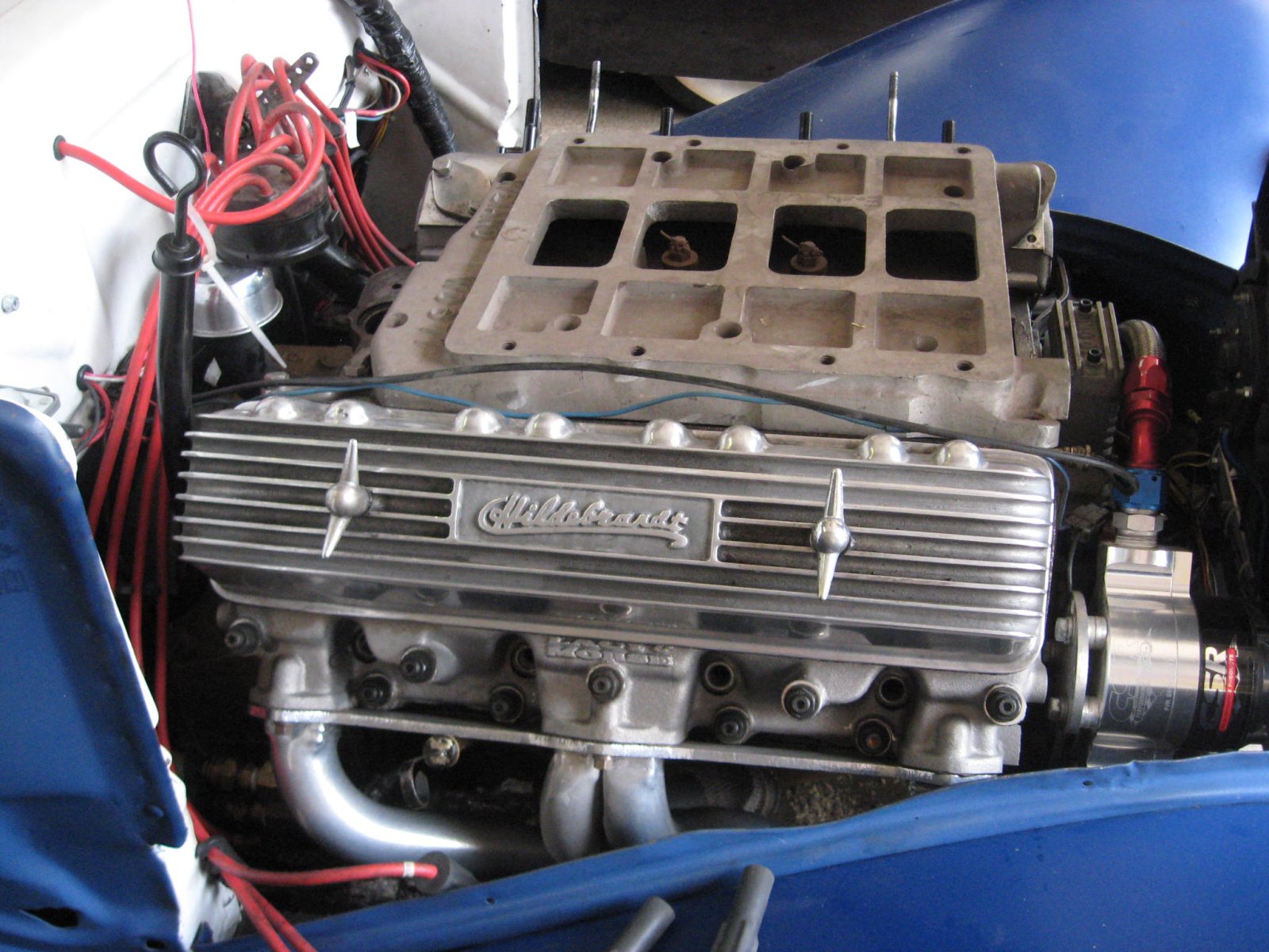

    I did the opposite, put a pair of Hildebrandt Caddy valve covers on a 371 Olds. Just had to put a little zig zag on the studs to line them up. They worked fine.

  19. 550Coupe
    Joined: Jul 21, 2009
    Posts: 914
    550Coupe
    These are what I have. Bought them back in the 80's. They never fit quite right. Had to offset the studs to line up with the bolt holes. Was told they were Cadillac. Top corners are more "square" than Olds

    according to this old thread what you have are poorly made Olds valve covers. I think that you posted on pg 2 of that thread. It was stated there that the caddy with ctr bolt covers have a bolt spacing of 14 inches
