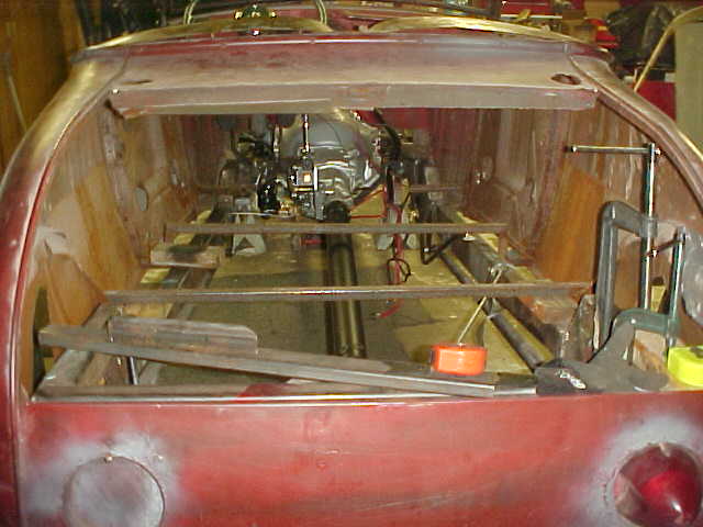

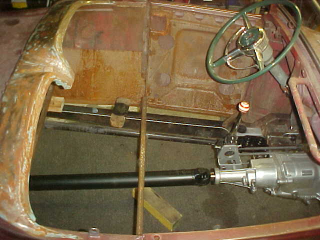

    My model A has a completely gutted floor and supports from the firewall back. The body is channeled, and I will be building body mounts, braces and floors front to back very soon. Has anyone taken aftermarket floorpans and simply hacked them to fit? For instance, one can purchase 55-57 complete floors with tunnel. I saw a post when I searched using beaded panels, what is there an easier way? What's your thought on modifying a complete floor pan to fit? I'm a good fabricator, but don't have bead rollers, and fancy sheetmetal equipment-just the basics.

    I have used Direct Sheet Metal's floors in my A Coupe, although I did not channel it and because I used a C4 behind the flathead with Flat-O-Matic adapter I didn't need to modify the floors at all.
    The floors fit very well and you will need to put the body cross rails back as the floors fit into them just like stock.................I don't see why you couldn't fab a tunnel for the full length....................it would sure save a lot of work using already made floors with rolled edges.

    The car is narrow...the crossmembers will be plentiful...the driveline hump is there to act as a central stiffening rib.
    You can always lay out some interesting designs into the remaining flat areas, free hand over...say the open jaws of a big vise...or if you want duplication to be reliable from side to side...a wooden hammerform.
    Beadrollers aren't a necessity...they're a convenience. ;)

    I just started the subframe on my '33 truck cab on a Model A frame (channeled 4"). I decided to use a wood/sheet metal hybrid for the floor & center hump. The more wood here, the better. As a general rule, I try to shy away from pre-formed pieces, because I usually end up altering them so much they don't look anything like what came in the mail. I just get flat generic pieces & custom fit it all. I only have rudimentary tools. No bead roller. I just muddle through it.

    Making your floorpans isn't as difficult as you may think. I used 16 gauge for the flats and 20 guage for the curves all with a diegrinder. The cab is channed 6". Wrap your driveshaft tunnel around your MIG welding gas cylinder to get the curve and make your ****** tunnel in 2 or 3 pieces to get a "cone" affect.
