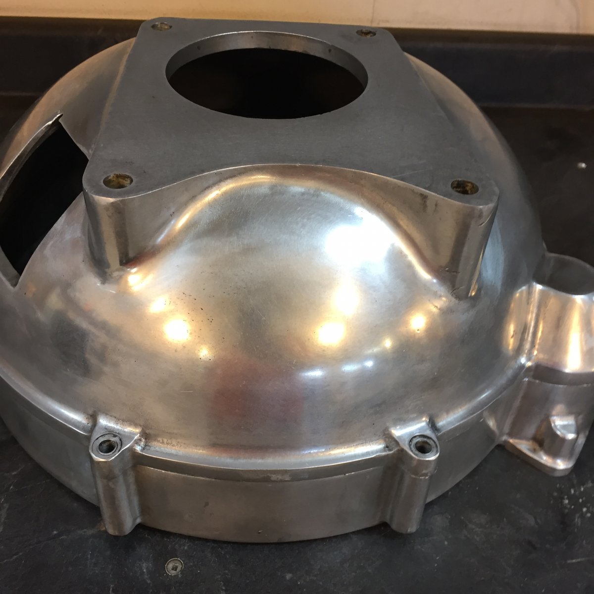

    If using the early Hemi ( 392 ) and use a Lasalle transmission.
    I know a adaptor for sale ( no name, so
    not ex Hildenbrant ) but starter at std side = not good for a 32 frame/steeringbox ) but is was market ’early Hemi to Lasalle’ but if that mean the baby Hemi pre 55 with the incast bell or the 392 - I don’t know.
    I do know it did not fit to a 392 block.
    Seller had no idea why.
    I suspect one should use the std adapter ring this engine might has (?)
    I saw this in a book.
    Look like starter at p***anger side ?
    3 bolt rows to get this togheter.
    Se picture of the adaptor for sale.
    Ideas.

    It might be a Trans-Dapt housing. If it is, it will have a part number cast on it somewhere (like HC-27) that will identify it. It wouldn't bolt directly to the engine block; it would bolt to the original thick aluminum plate that mounts the starter.

    Ok so I try to find a std Chrysler manual shift bolt-on plate.

    I don't believe that the plate has to be from a standard shift car. I used to have a Trans-Dapt bell housing that allowed the use of General Motors 4 speeds behind a '54-'58 Chrysler hemi, and it worked in conjunction with the factory plate from an automatic.

    I bought a short bellhousing 331 that has a very similar adapter to that. It has the starter on the p***enger side. It also came with an aluminum flywheel and a Long-style pressure plate setup. I couldn't find any identifying marks anywhere on it, not even a part number.
