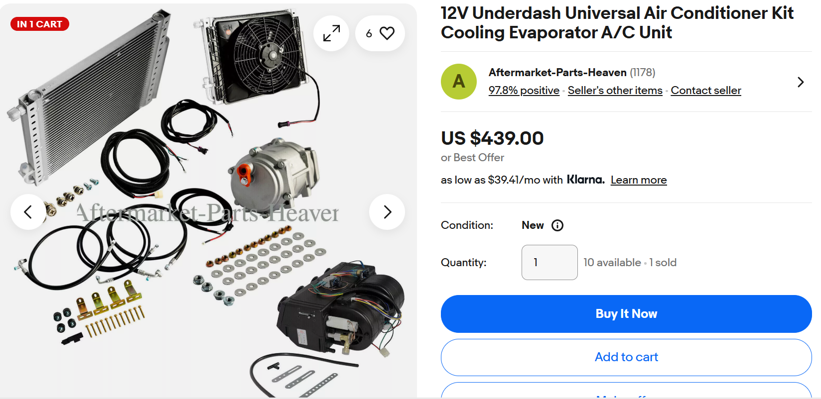

    Vintage Air makes retro looking under dash units around $500.
    Add a compressor/condenser/dryer (i saw a cheap kit on line for $237.
    Or you can go uber cheap and get everything for $439.
  19. Budget36
