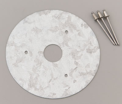

    Has anyone ever used a water pump that has a disc attached to the impeller?
    I am curious if the addition of the disc would be beneficial with circulation and possibly reduce cavitation.
    I was looking at water pumps on line and noticed the add on disc and then found a water pump with and with out the disc.
    Anyone have any first hand knowledge? HRP

    low budget way to help improve cooling by adding disc to impeller: 20210522_161550.jpg 20210522_161657.jpg

    Some of the Chevy six water pumps used with the Zips have the disc already installed. Different brands come with are without. Used to could buy the disc but I couldn’t find one the last two times I added the Zips pump. Auto store I used only offered the new pump and no disc. Used a plated electrical box cover to make one.

    I have the Zips adapter on a 350. New pump that came with setup was advertised as Hi volume no disc on it. Just for an experiment I ran it with no disc and about a month later added the disc to pump with pop rivets. I could tell no difference in cooling or anything else.
