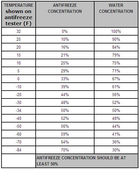

    I would like to thank all of you for your info. Checking antifreeze is not that easy on a car that does not have good access to the coolant. I would have to crawl through the snow, drain some into a cup and test it. Mathematically speaking if 2 gallons would give a 50/50 mix approximately... then a 1 gallon should give me a 25/75. If 50/50 is -40 then 25/75 should be -20 Approximately. Temp did not drop down below 0 last night but wind-chill is -10 or so. I did add the dipstick oil heater last night. I think it would have to help. The car is covered with a tarp and I banked snow up all around it. Usually we don't have to worry about -20 degree weather till end of January - February...but Mother Nature has been messing with us. I don not own a pressure tester, so not an option. I really like the belt/pulley/drill method. Just need to get through another cold one tonight and then its supposed to warm up a little.
  15. You're logic and math don't correspond with any published antifreeze concentration chart.

    I understand I was just ball parkin'. You would think it would be a proportionate ratio.

    You guys are making too much of this. If you ever filled a car with antifreeze you know 1 gallon of antifreeze and 1 gallon of water is the typical mix and this is enough to fill most cars. If he poured a gallon of pure antifreeze in there it is not going to freeze no matter what was in there to begin with. So just forget it until spring.
    If for some crazy reason you want to fill a car up that does not even run just use 50-50 mix. Or if you want to totally waste some money fill it with pure antifreeze. It will mix by itself, eventually. If you don't believe me half fill a jar with water then fill up with antifreeze and see if they mix themselves.
  25. Rusty O'Toole
    Joined: Sep 17, 2006
    Posts: 9,756
    Rusty O'Toole
    I should also point out that even a weak antifreeze mix does not freeze solid right away. It turns slushy. It will not crack a block until it freezes solid. I would guess a 25% or 35% mix would prevent damage in Utica.
