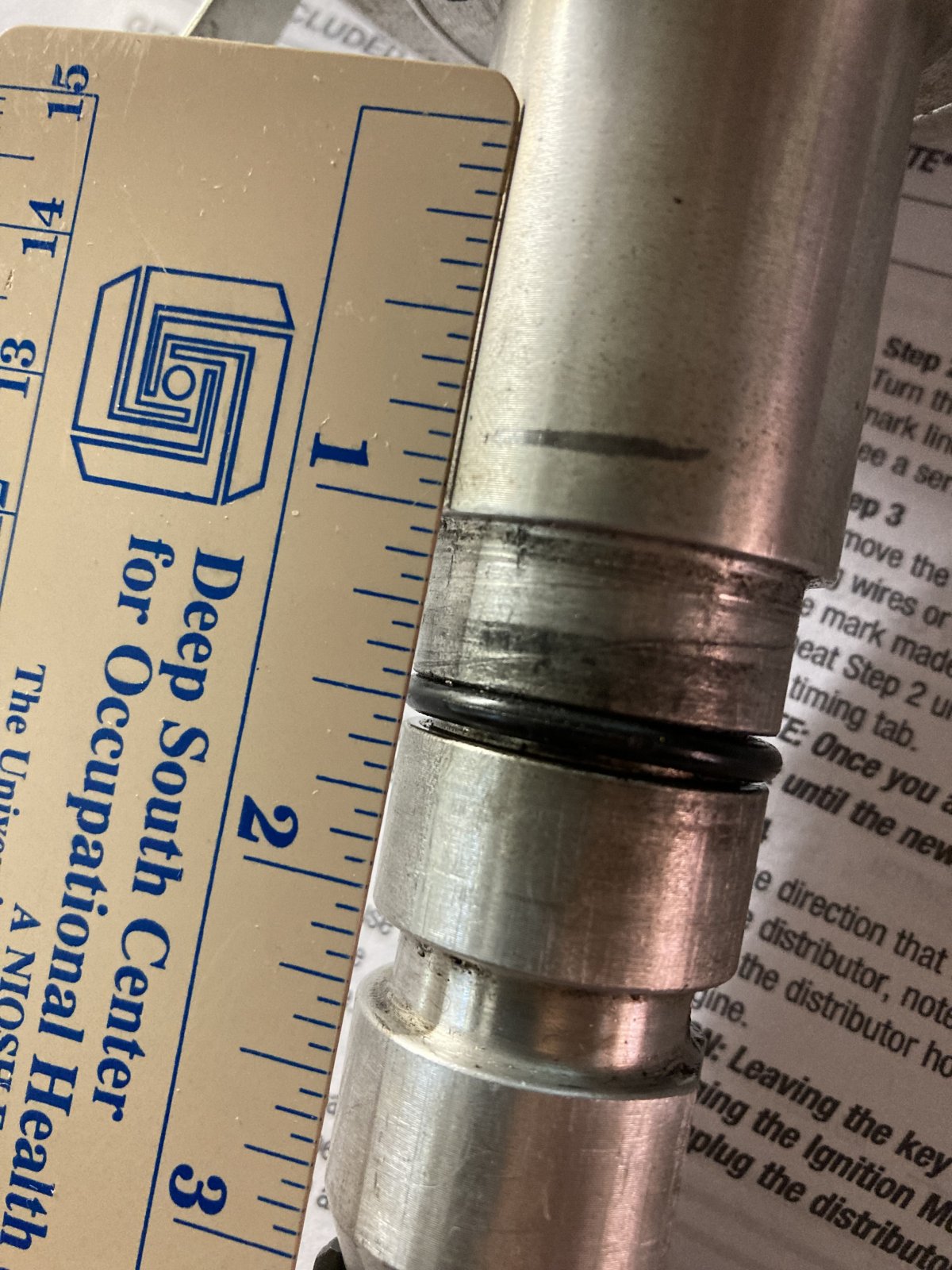

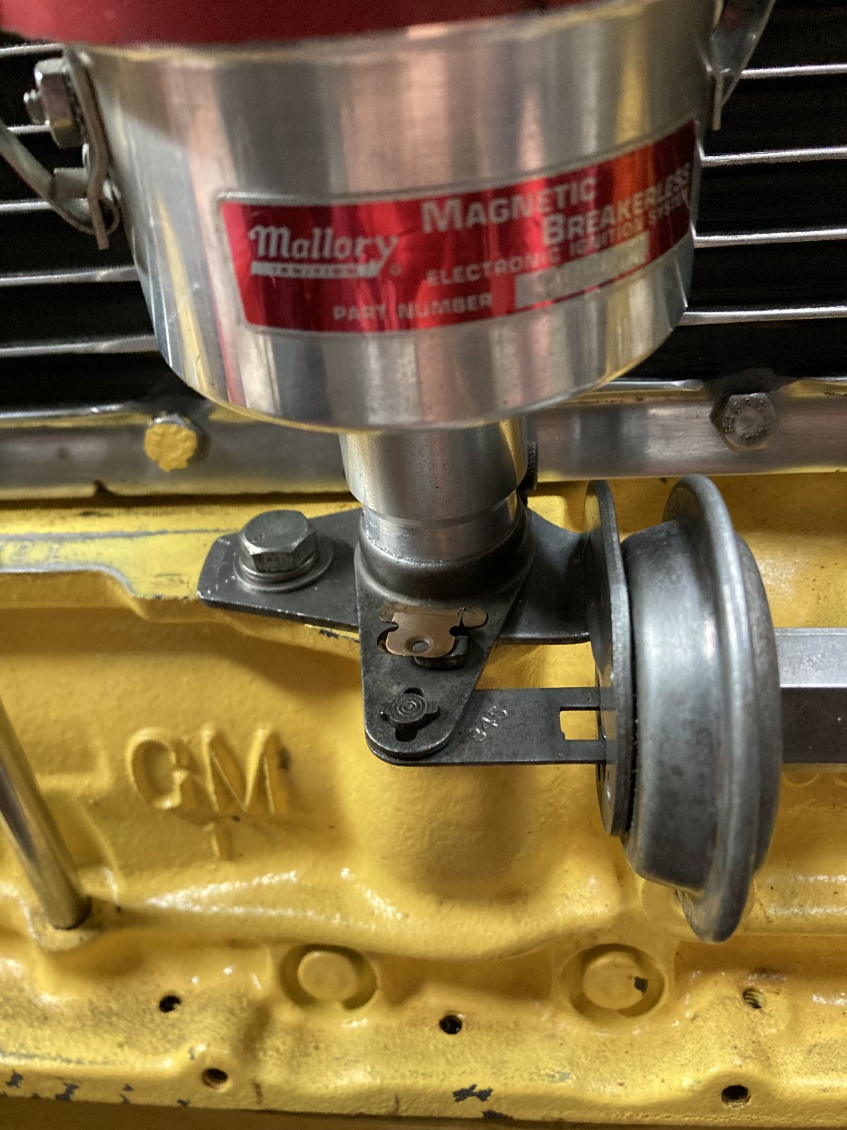

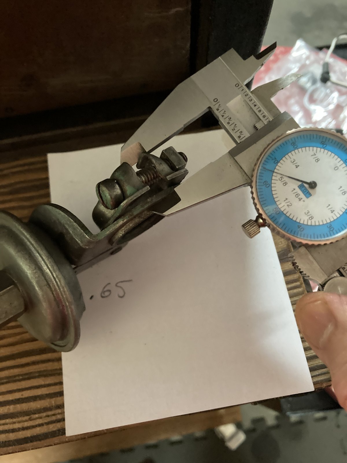

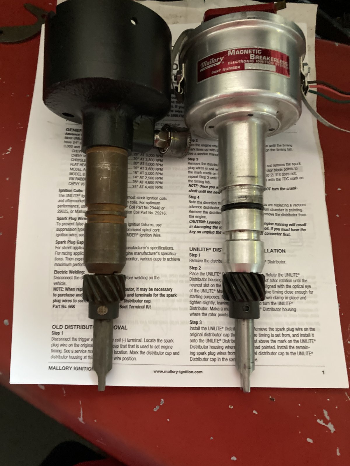

    Top picture, Stock on left, Mallory on right
    2nd picture, pencil mark approximately .21”above step, lathe to remove material to accommodate clamp/vac advance
    3rd picture, width of clamp/vacuum advance

    Might need to eliminate the O ring to let it turn easily? And how does the OD of the new one compare to the original, where it fits into the hole in the block?
    Cosmo49 likes this.

    Agree on possible elimination of O ring. It's a perfect fit, I've run the engine with the Mallory distributor. I just need a little more room to mount the Clamp/Vacuum Advance.

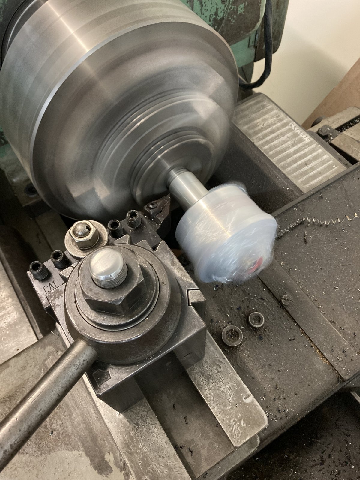

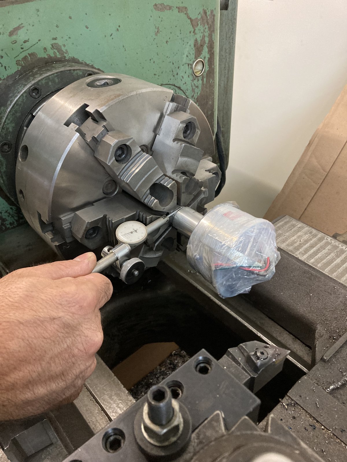

    Setting up the distributor for the shaft reduction.
    Milling
    Finish looks as good as original.
    Great fit, vacuum clamp on distributor turns with ease.

    I hope the lathe is big enough to handle the job :)
