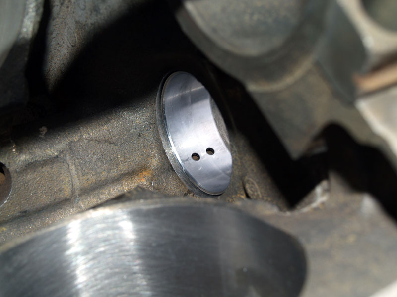

    Importance of Lifter Position
    [​IMG]If the position of the lifter on the camshaft lobe is anywhere other than on the heel (note image above) where there is NO ramp contact when making adjustments, the lash setting will be incorrect. This position is required for each valve before you attempt to perform adjustments. The chart and procedure above ensures that the lifter is on the backside of the cam lobe for each valve.
    In the past we were often instructed by the auto shop teacher or service manual to position each cylinder at TDC (piston at Top Dead Center), and then adjust both valves for that cylinder. However, we often find that this is not the correct procedure to obtain the proper lash setting, especially on modern engines or agressive camshaft profiles. The image at right shows the required position of the cam lobe relationship to the lifter that ensures correct valve lash adjustment.
    Ensuring that the lifter is positioned on the heel of the cam lobe will guarantee that the valve you are adjusting is fully closed. Any other position and adjustments will NOT be accurate.
