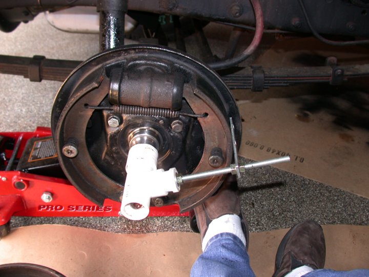

  4. You should get yourself a manual off Ebay. Well worth it. Minor adjustments are no problem, but major adjustment, or new shoes, requires the use of a special shoe aligning tool to centre the arc of the shoes. If you dont use it you'll only have part of the shoe contacting the drum. The manual will explain all this.
