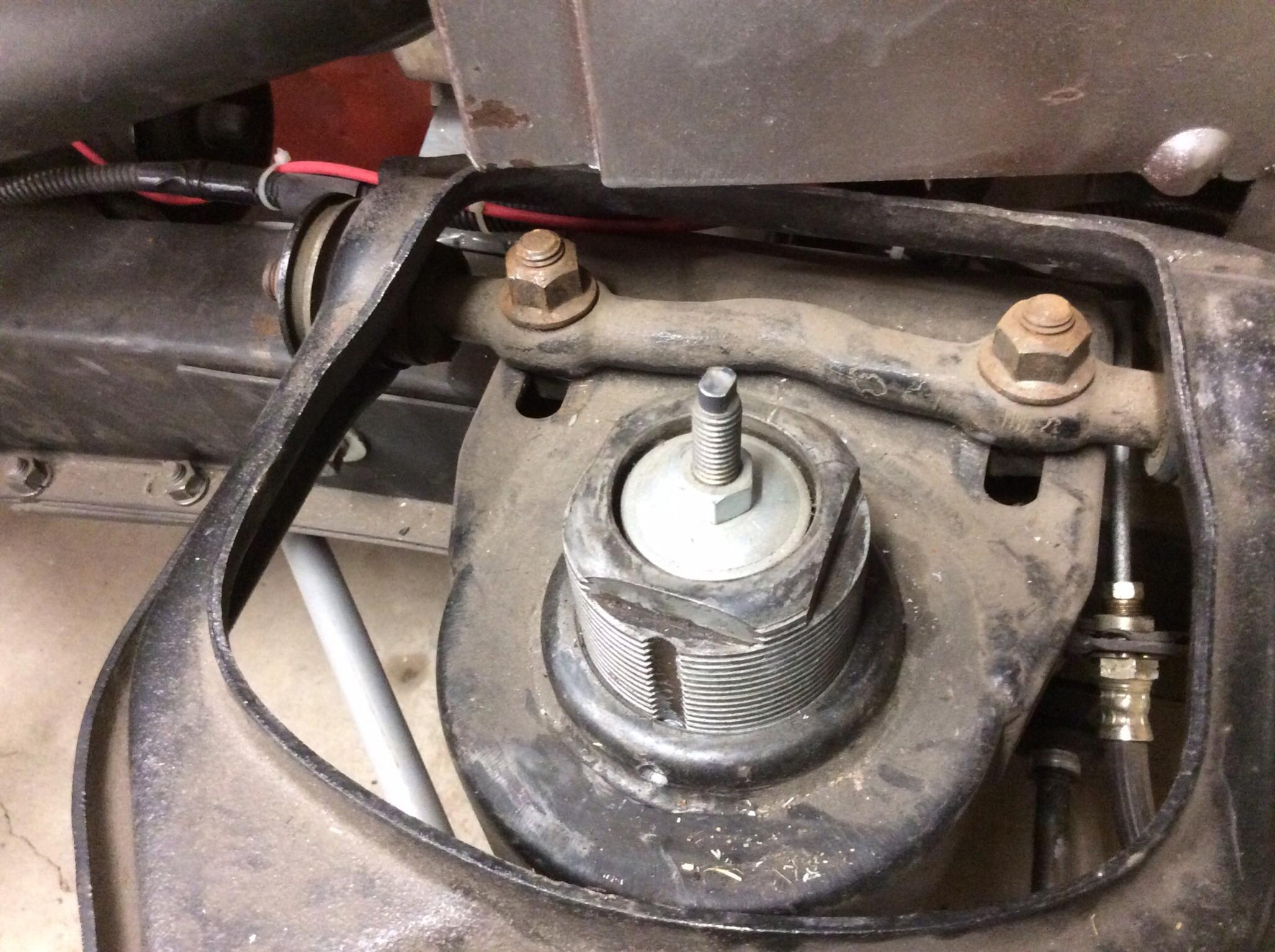

    This is my first attempt at setting the camber and castor in 69 years:) It appears that I need some sort of tool to separately pull each side on the upper A-frame. I have started fabricating one but, maybe there is a simple way to do it that I am unaware of.
    This is a ch***is engineering crossmember with Mustang II parts.
    Thanks

    The original tools (Mac cc624 for example) require a hole in the frame which isn't there because the configuration is different. The OTC tools (at least with my feeble mechanical skills) have nothing to "pin" to that I can see.

    You can always drill a 1/4" or 5/16" hole behind each slot.
    If you aren't familiar with the adjustment, scribe some lines behind the arm so if the arm slips, you can find your way back to being close to where you were.

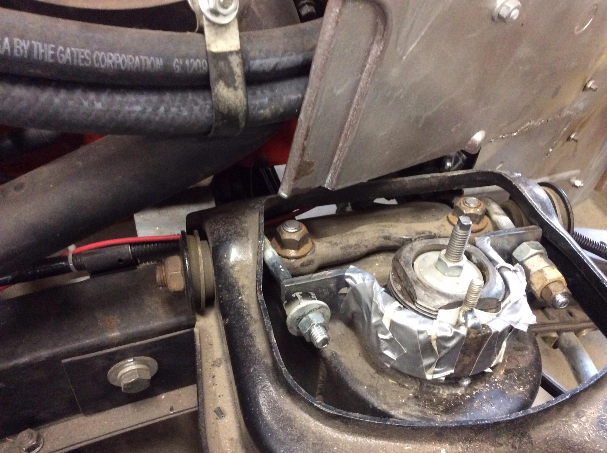

    I went ahead and finished fabricating a tool that was similar to the ones that I had seen online. I took a couple of three eights inch bolts and cut their heads off and then bent a U-shaped end on each of them and took a piece of strap iron and heated and bent it to follow the shape of the adjusting screw in the ch***is. I welded a quarter inch bolt onto the strap so that it sat in the slot in the adjusting screw so the strap wouldn't turn as I tightened the adjusting bolts.
    The duct tape is to protect the threads on the ride height adjusting screws.
    It works and is cheap, just not pretty:)

    If you can fab a bit you can probably make your own tools to move the A arm with out of a couple of bolts and some pieces of s**** metal out of the s**** bucket. Google OTC 7010 and you can probably come up with some ideas on how to do it. You will have to drill a pair of holes to the inside and a ways from the end of the slot to hook the tool in.
