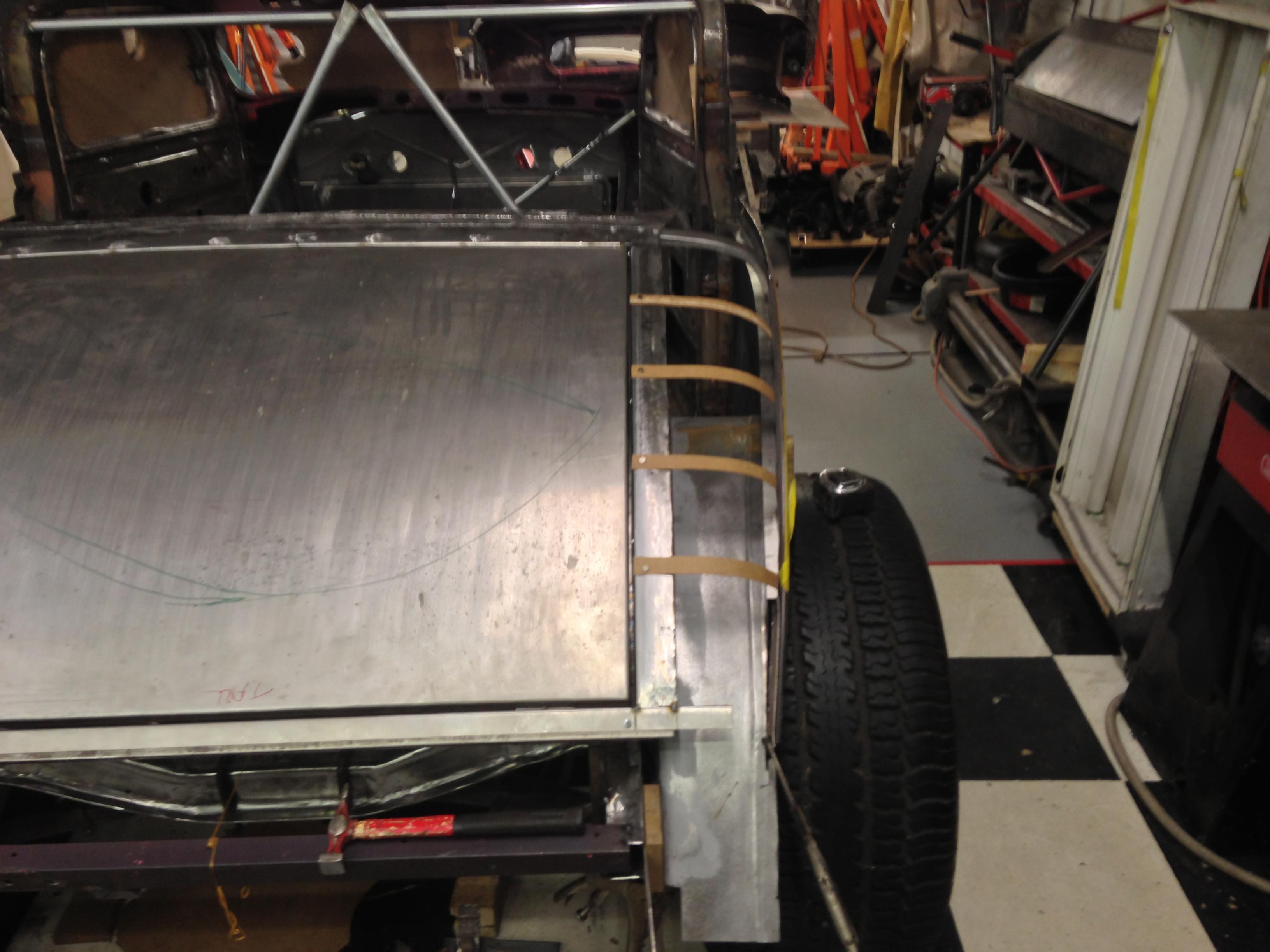

  4. While it was quiet, and nobody was looking ...
    Now the big part of the 1/4 behind the door is really really out of wack, lol
    The line and flow of the bead is much better in this pic and even better now as I've played with it some more. Still playing with clamps but that's 1-1/2 smaller at the tail here.

  11. I've got the bead almost where I need it on the top view.
    But messing with it throws this side view of the line off, right now it looks like the tail needs to come down a little, but the bead has to still come out a little.
    It's got my wheel house off by 1-1/2 " now! remember that they were made to fit where it was before I cut it apart. 1-1/2" might as well be a mile.

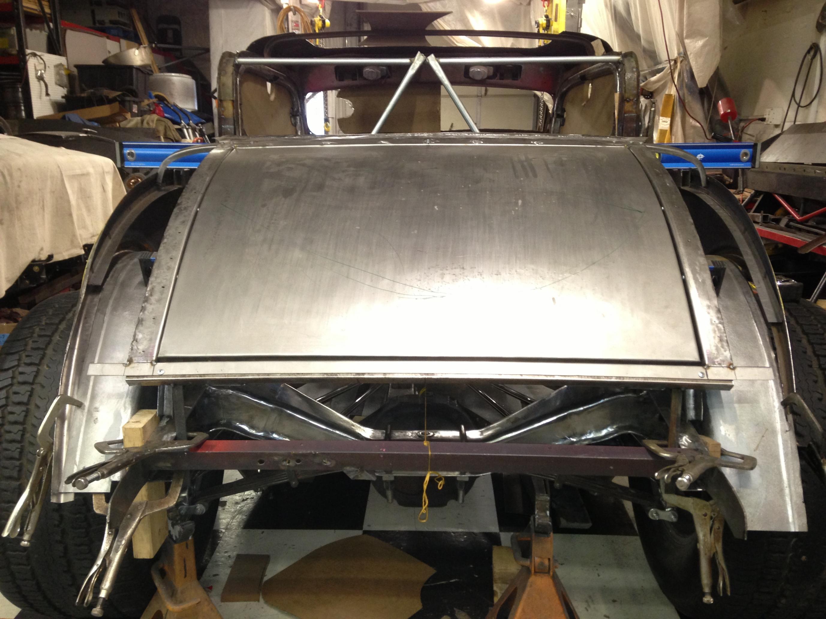

  15. Slow going - lining up the 1/4s took for ever !
    But there's some
    I needed to make a 1/2 x 1 and shrink stretch the profiles I wanted and then tacked them to the noodle like 1/4s . Both sides the same. Exactly the same ugghhhh
  16. Here's how I got there.
    Measure measure measure and measure some more.
    Then plot those points.
    With a pieces of 3/8 x 1 oak, we bent it to catch all the points we could. This creates a natural flowing curve, kinda****y too.
    Then make that 1/2 x 1 follow the lines.
  17. Those curves need to flow natural from the doors out into thin air.
    They sort of tell you were they want to be. Just getting them even side to side at about 20 different pints is really time consuming and makes me want to throw***** unless I walk away for a while. Just when you think you got it, I'd measure something else and find something not right enough.
    Wound up cutting 3/4 up from the bead and 2" off the deck lid.
    This was this morning and finally the 1/4s are where they are staying.
  18. The rest of the day was screwing around moving the deck lid opening around to match the side profile. But that's set now too.

  21. This is the deck lid profile line i mentioned earlier after it was moved. It was all cattywhompasses and wound up bringing the tail down over an inch and moving the frame back about 1/2".
    That wasnt fun because it was braced well, then remove the braces and you have a jello like structure you are attempting place precisely.
