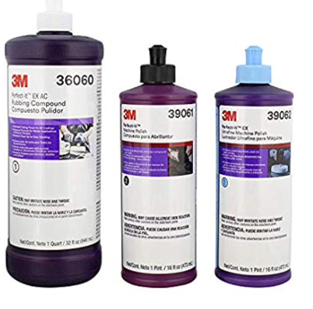

  4. This is the 3m we use
    Post a pic of the compound. If there is something new I’m gonna talk to my supplier.
    As far as single stage being all ya need, ya can’t do what ya just did to single stage metallic

    I don't have the jug, they gave me a coke can full. It's green, you can see it on the window frame above.
    I'll most likely do the other stages when I go back to cl*** in January, probably after it's back together and driveable.

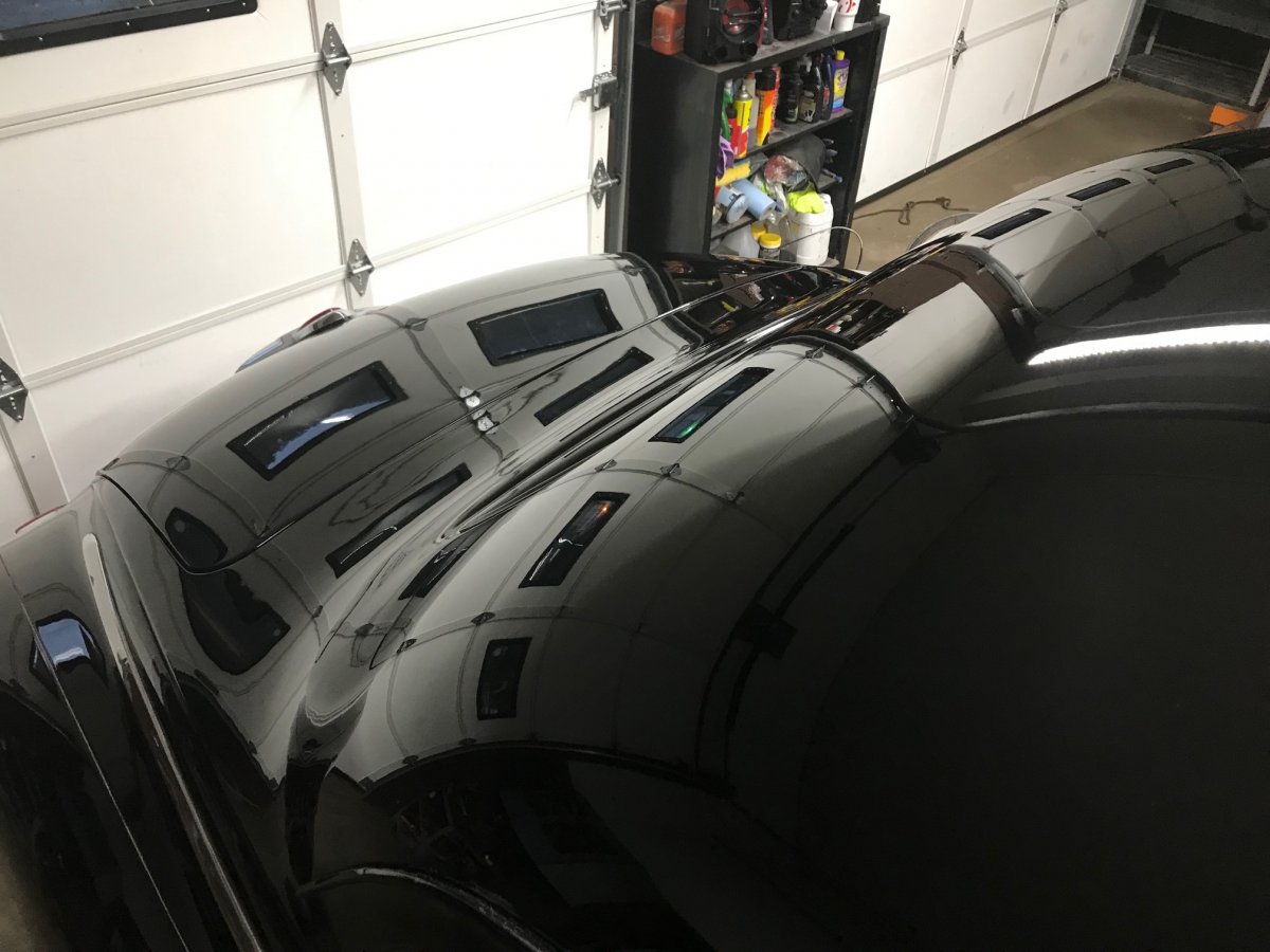

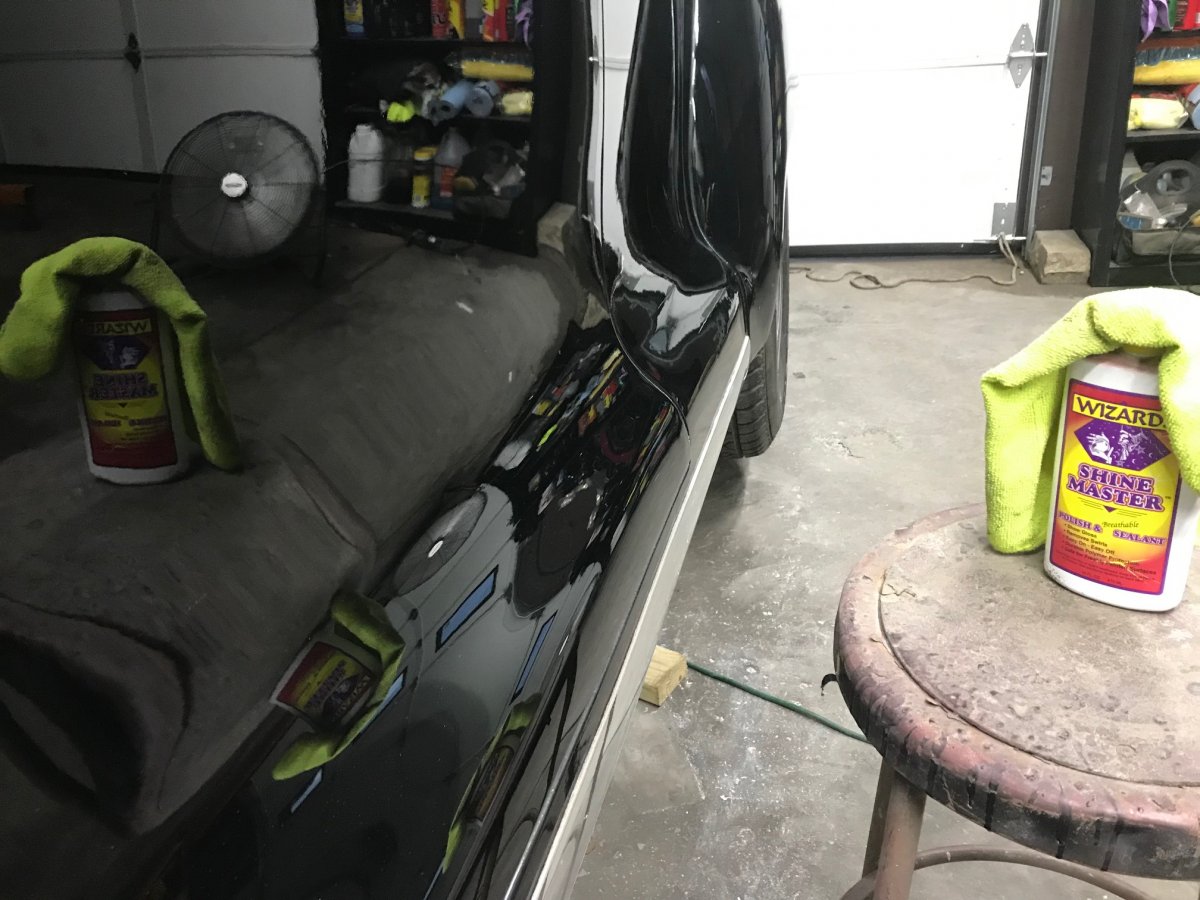

    I use Wizards exclusively, I used to use 3M but I think Wizards does a better job at a lot better price. I start with Turbo Cut with a white foam pad, then Finish Cut on a black foam pad, then hand polish with Shine Master. IMG_3123 (002).jpg IMG_3124.jpg
