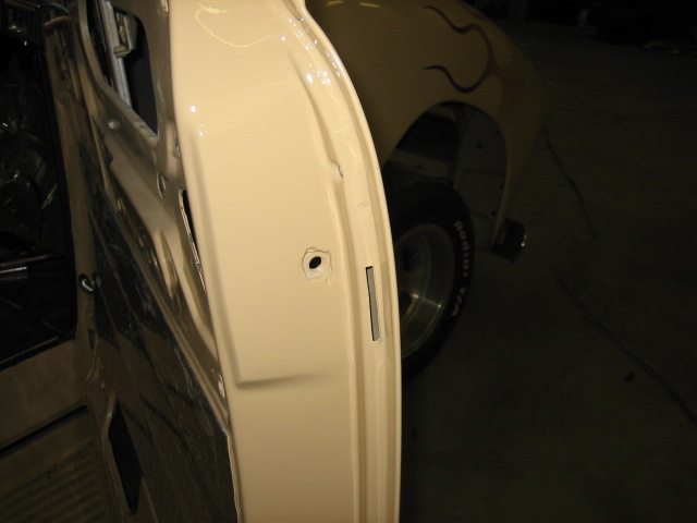

    Back before they were offered by the after market people we used to use bear claw latched from the salvage yards and used two types of installation. For electric we put the latch in the pillar and the striker pin on the door; this allowed an easy install of an emergency release cable and kept the working guts from being banged each time the door was closed. On mechanical the latch was in the door and striker on pillar. Cream colored truck had latches pulled for painting.
    bear claw latches 008.jpg bear claw latches 009.jpg Jack\'s interior 001.jpg Jack\'s interior 003.jpg
    RICH B likes this.
