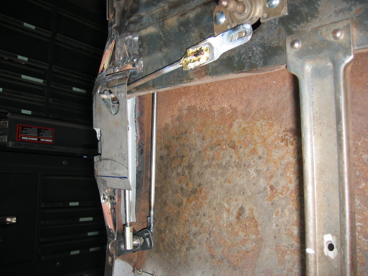

    There is a solution for those that don't like the hair trigger action of the latches.
    When I was laying out the linkage for my latches, I added a slide area on each release arm that the handle has to travel through against the spring in the handle before the latch releases. The inside and outside handles are nearly at the end of their travel before the latch releases. In the attached picture you can see the slide area for the inside handle in the ugly looking brazed piece of metal. The outside handle slide area is in the bell-crank in the lower part of the picture.
    This install is on a Model A Ford, that necessitates the linkage going down under the window then back up to the latch. The inside release is a 48 Chevy. The latches are "Eberhart 9-400-R and 9-400-L" that feature dual arms so you can have inside and outside release handles.
