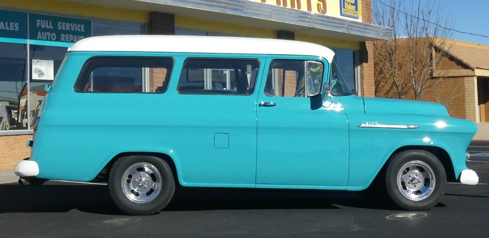

    for reference, this is one I built starting in 1998, then didn't get around to finishing until 2013. I drove it for a few years, then sold it, because it just didn't have the comfort I wanted on long drives (mostly to do with seating and HVAC)
    57sit.jpg This has a 70s Camaro front clip, and modified rear suspension, using the original springs mounted under the axle, moved under the frame rails and supported by the original front spring hangers/shackles. It drives decently, and sits right. Note the front wheel looks like it sits about where it should. If it were lowered more it would need the front wheel moved forward.
    If I were starting over, I probably would not use a Camaro clip, but at the time it was an easy thing to do.

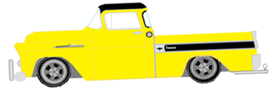

    upload_2025-6-25_4-7-26.png I liked orange and the thought was that it could be rented out as a Halloween display for those m***ive teenage parties along the So Cal coastline, or outdoor malls that were just starting up all over the whole metropolitan area.
    Hello,
    This 1958 Chevy Cameo Carrier was in our sights as a tow truck and parts runner. We have always liked custom trucks, as our sights were set on a 1956 F100 Ford Tahitian Red chopped, custom truck since it popped up in our Westside of Long Beach neighborhood. Trucks are/were handy as obviously there is plenty of room in the back pick up bed. Even inside, there is room behind the seat and the cab is/was quite wide. Definitely, 3 people comfortably seating on the bench seat, maybe 4 people a possibility.
    This Chevy truck was a hit from the beginning with the stylish rear fender and bed. No more extra rear fender sticking out and the pick up bed having a smooth side cargo space. Even though the Cameo is Orange, my brother had a liking for Yellow station wagons and/or trucks, if we went that way for a tow truck for our 1940 Willys Coupe in the C/Gas Supercharged Cl***. Anything Yellow would have worked, including this yellow 1958 Chevy Cameo Carrier.
    upload_2025-6-25_4-8-51.png Not much would be needed. a good set of round tires, suspension upgrades, custom mags and a lowered stance. etc.

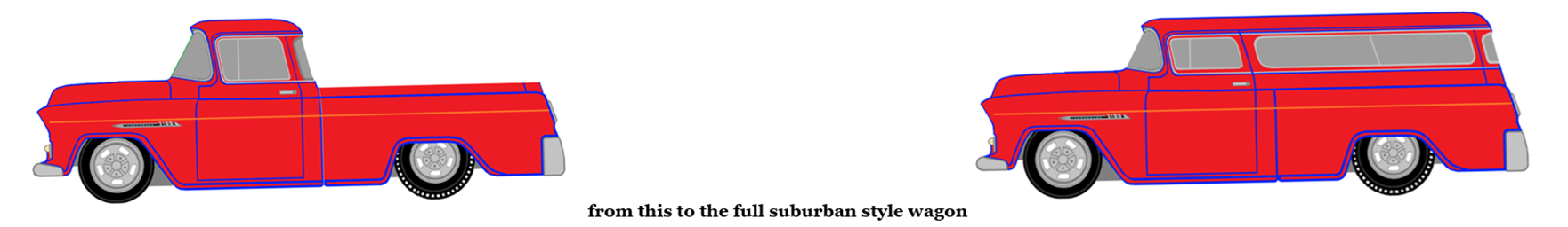

    So, the Yellow Cameo Carrier could have had its own haircut, too. Add in a slight chop to get the proportions adjusted... Push, Pull, or cruise… YRMV
    But, if you decide to go all out in modifications, a solid steel shell welded in makes a cool suburban type of hot rod wagon. All one piece, usable overnight accommodations, but a lot of work.

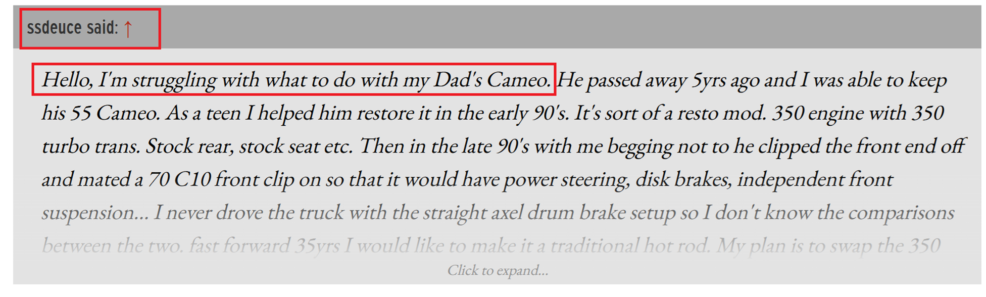

    You see things the way that does not agree with your ideas. How in the world can one answer such a great question from the original post? (Hello, I’m struggling with what to do with my Dad’s Cameo…) I am following along with the request and the answer is similar to his post. It starts off with "Hello,"
    For me, it has always been paragraphs to separate various parts of a topic. “What to do with my Dad’s Cameo...” was asked by @ssdeuce and the answers start with the above post by @NoSurf and continues on with other similar posts.
    The format is specific “letter” format. I do not know folks here on the HAMB personally. I have met some wonderful people through discussions and helping each other with photos, film, topics and history. So, it is appropriate to write back in “letter” format. That starts with Hello, But, for everyone, it is then a post of history, research and art work to emphasize the topic.

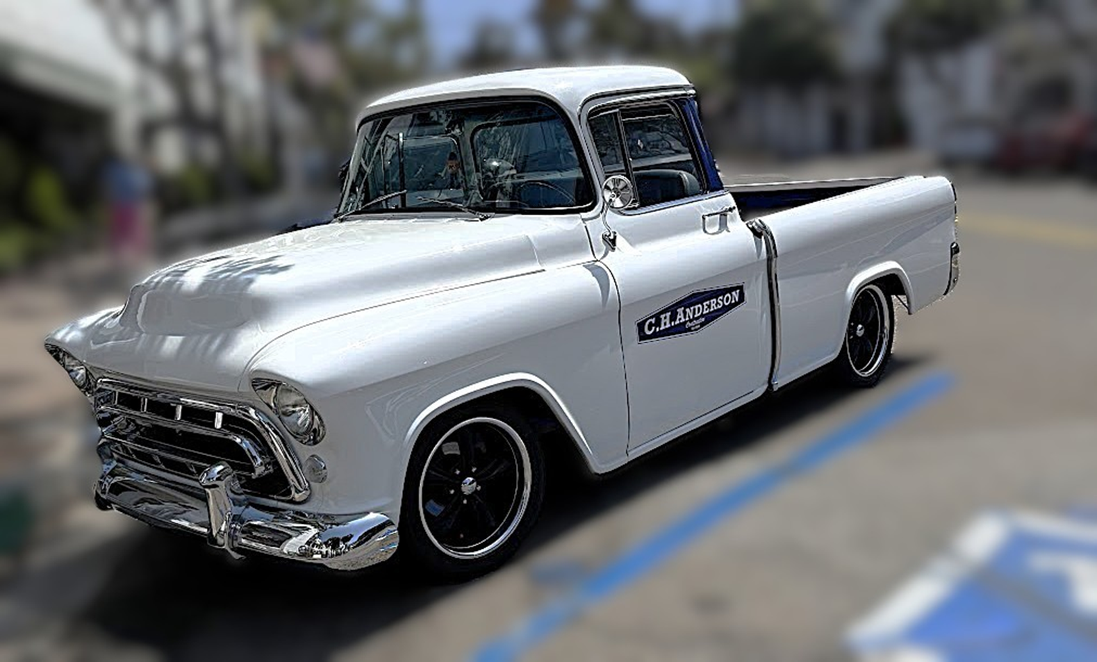

    Hello,
    Without further ado, a cool lowered rake Cameo Carrier seen recently. (And, photographed by my wife.) Clean lines, simple wheels and a daily driver for a local company. It was the stance that drew my wife to the truck, then she proceeded to take a few photographs.
    It was a nice shopping day in a little row of shops on the main street in town. The cool thing is that a nice hot rod sedan or truck is either driving down the street to the ocean or parked on one of the rare open spaces to go dining or shopping.
