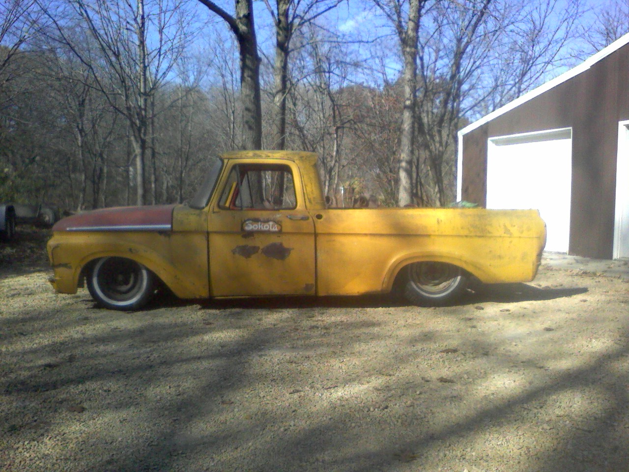

  17. Kato Kings
    Joined: Aug 22, 2006
    Posts: 707
    Kato Kings
    from Minnesota
    It really depends on how low you want to go. The narrower the better if you want to go really low. 78 camaro is 61.5 wide the same as the stock 61 f100. I don't know what a 95 crown vic is. The 03 and up crown vics are way to wide. I checked all possibilities out before putting a camaro clip in my SWB 62 uni. Here is a pic of my uni mocked up before I blew it apart for finishing.
