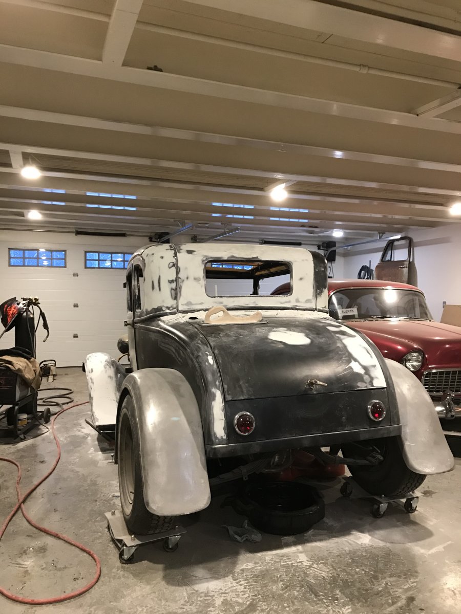

    Hi, I'm after a bit of advice on if a chop is "era correct" for my build.
    Full fendered 1928 A Model coupe running a 3" dropped A axle, A Model torque tube and banjo rear, 24 stud flathead with Edelbrock Slingshot manifold, wheels Ford wires 7.00x17 rear 5.50x16 front.
    What do you think?

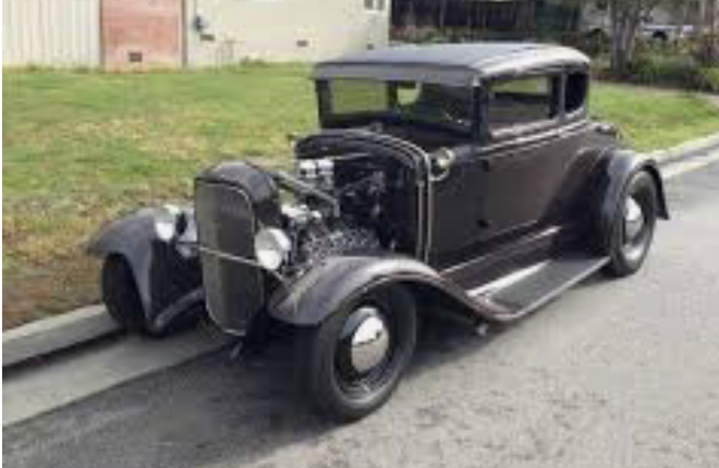

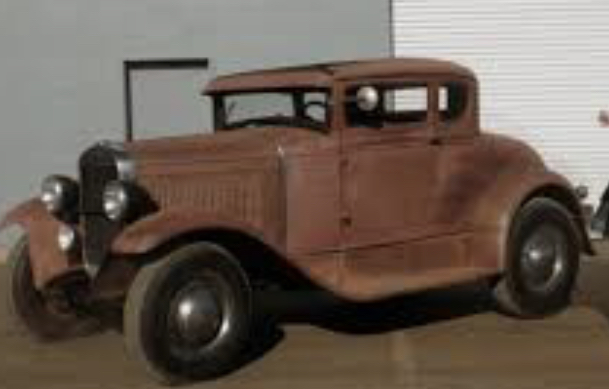

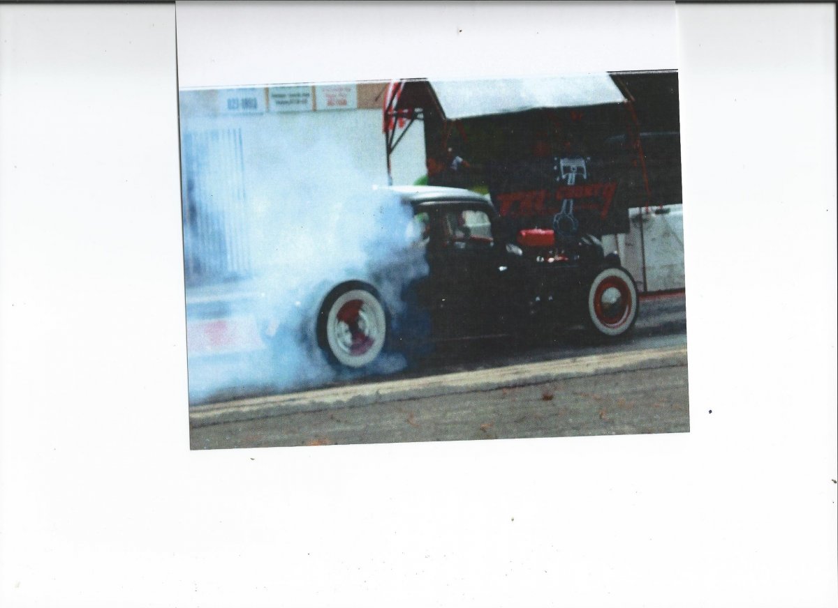

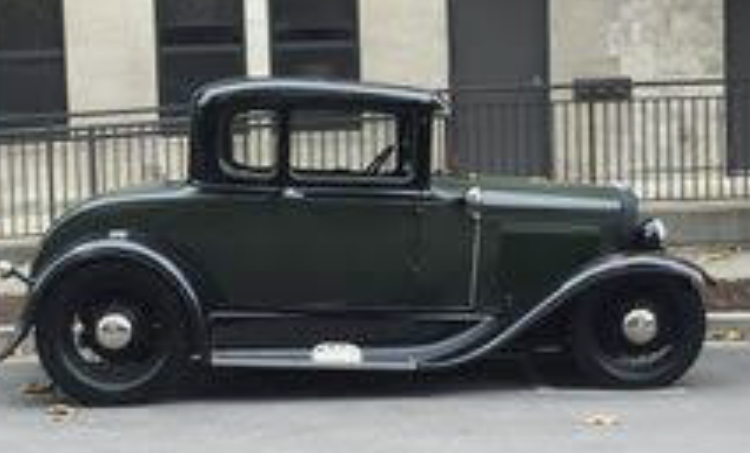

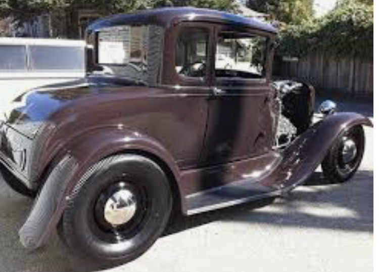

  6. I love chopped coups. Hard to beat these un cut examples
    0768B009-CAA4-4211-BB31-21F75E2960CD.jpeg 175DFA54-0E1A-423F-A42E-B5BC6F9707DA.jpeg
    here are some chopped examples
    DF25953F-C5A1-4031-B1B6-B46EC2D4836F.jpeg 07EF7FD0-DAA0-46F7-8EB0-F7B84C5EAA82.jpeg 860A398B-A69B-4B83-8E7E-7A39D2FE9DE7.jpeg
    the last one misses the mark for me

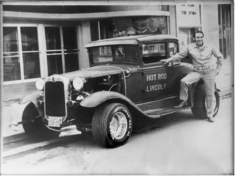

    Not 40's and not an A but Don Frews 3 window in 1952.
    adam401 and akoutlaw like this.

    The chop may have been done in 55 but the picture with those tires was not in 55!

    The Sting came out in 1973, that fits those tires a bit better.
