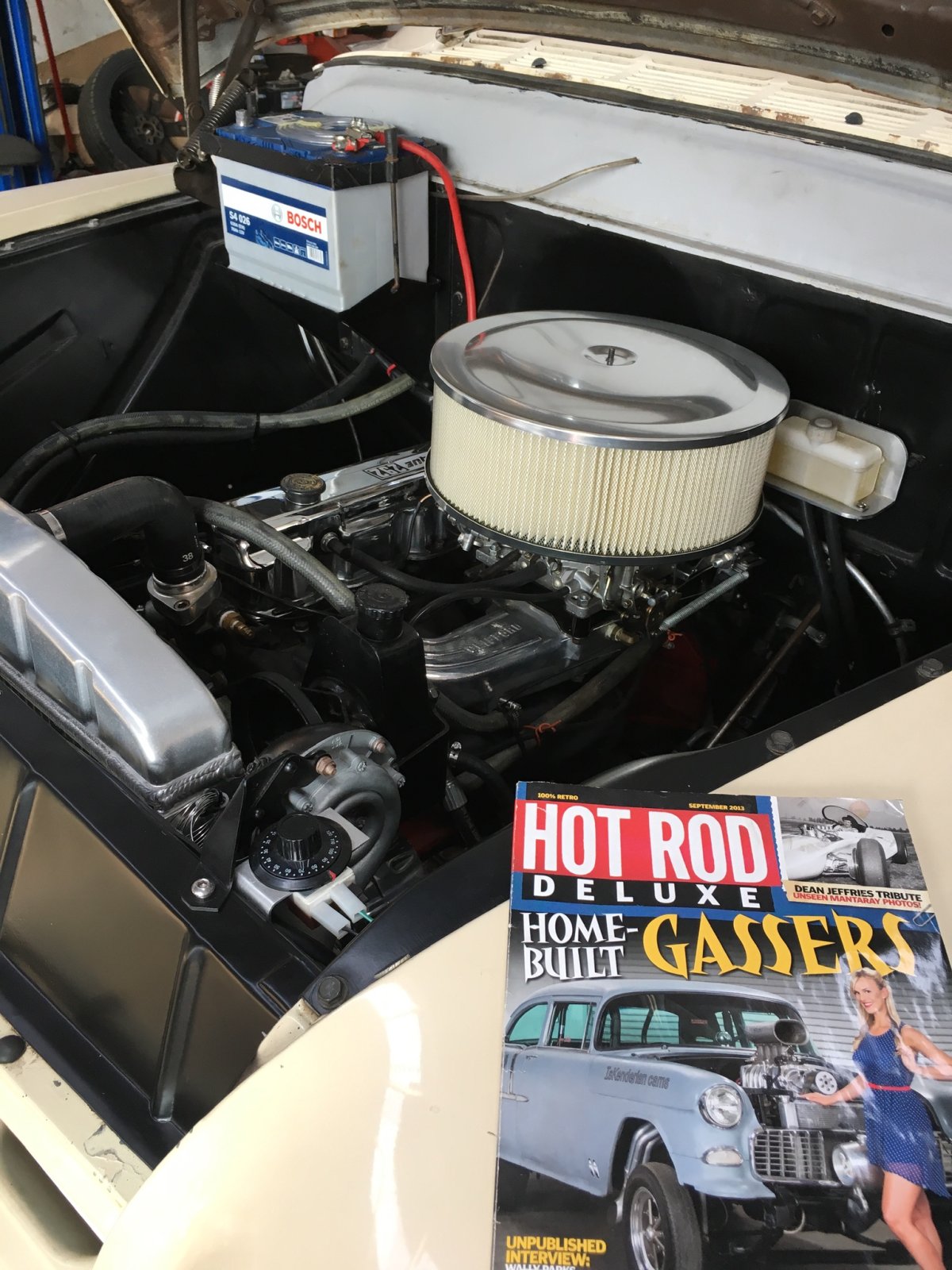

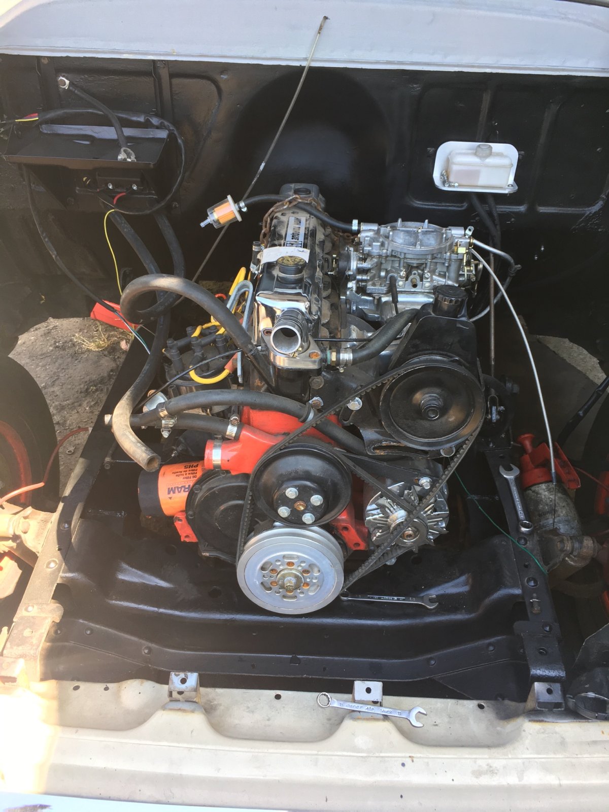

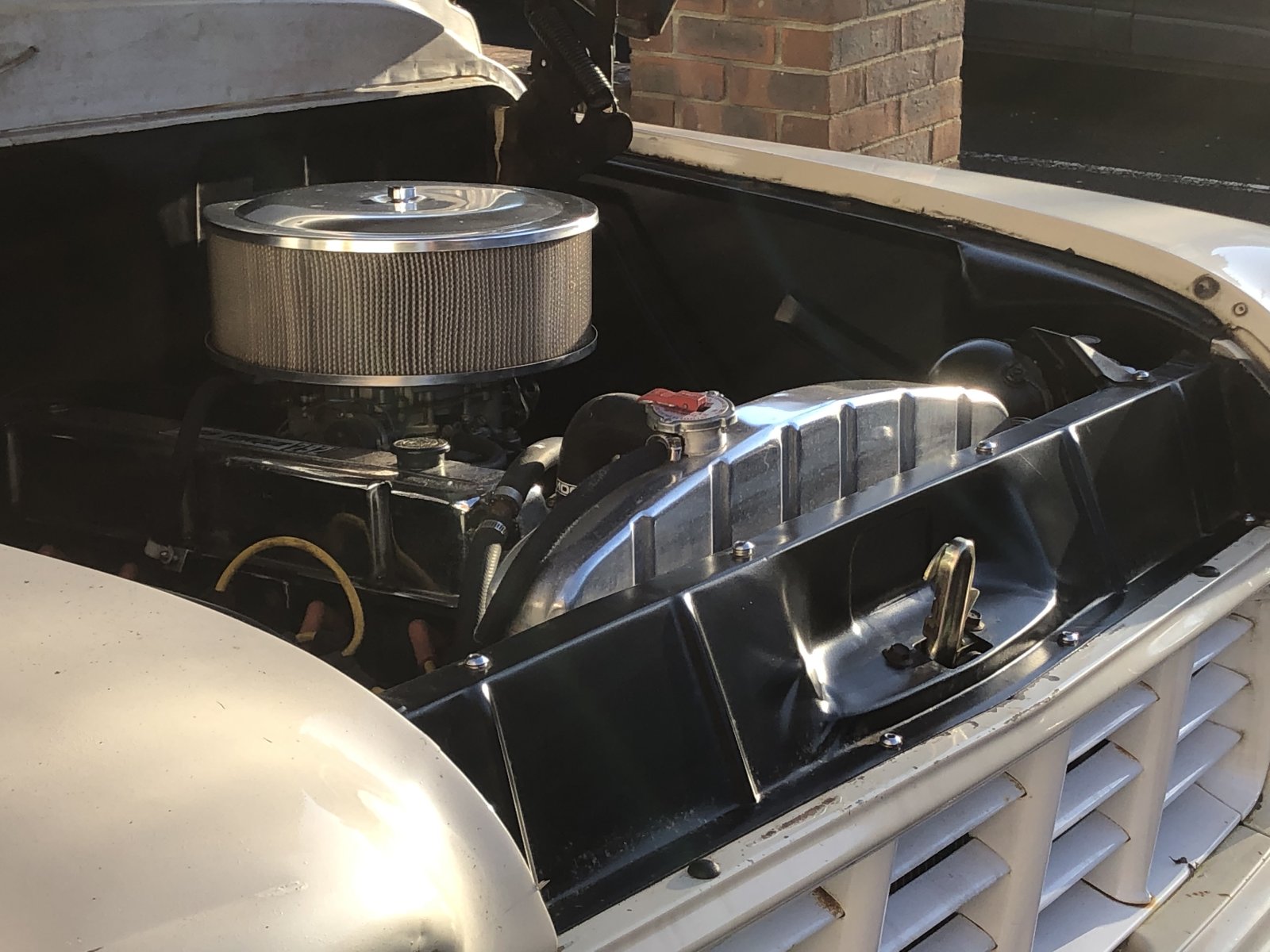

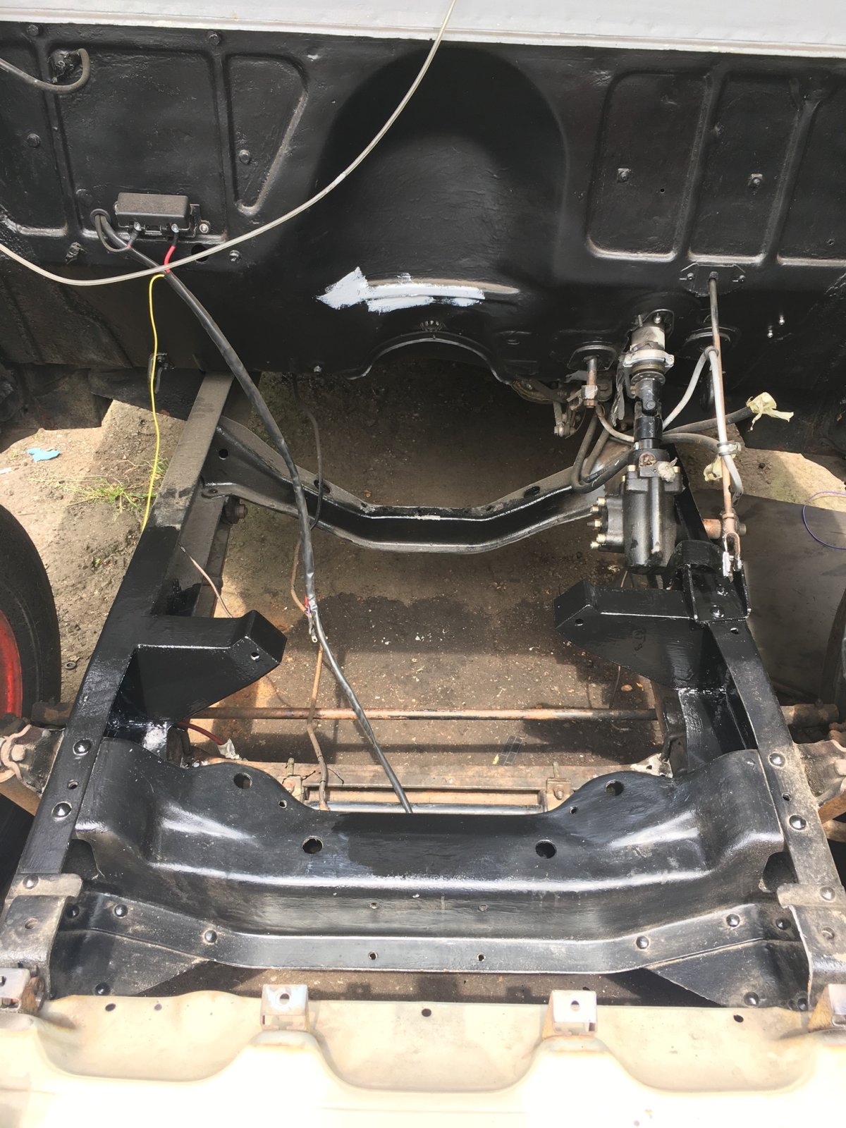

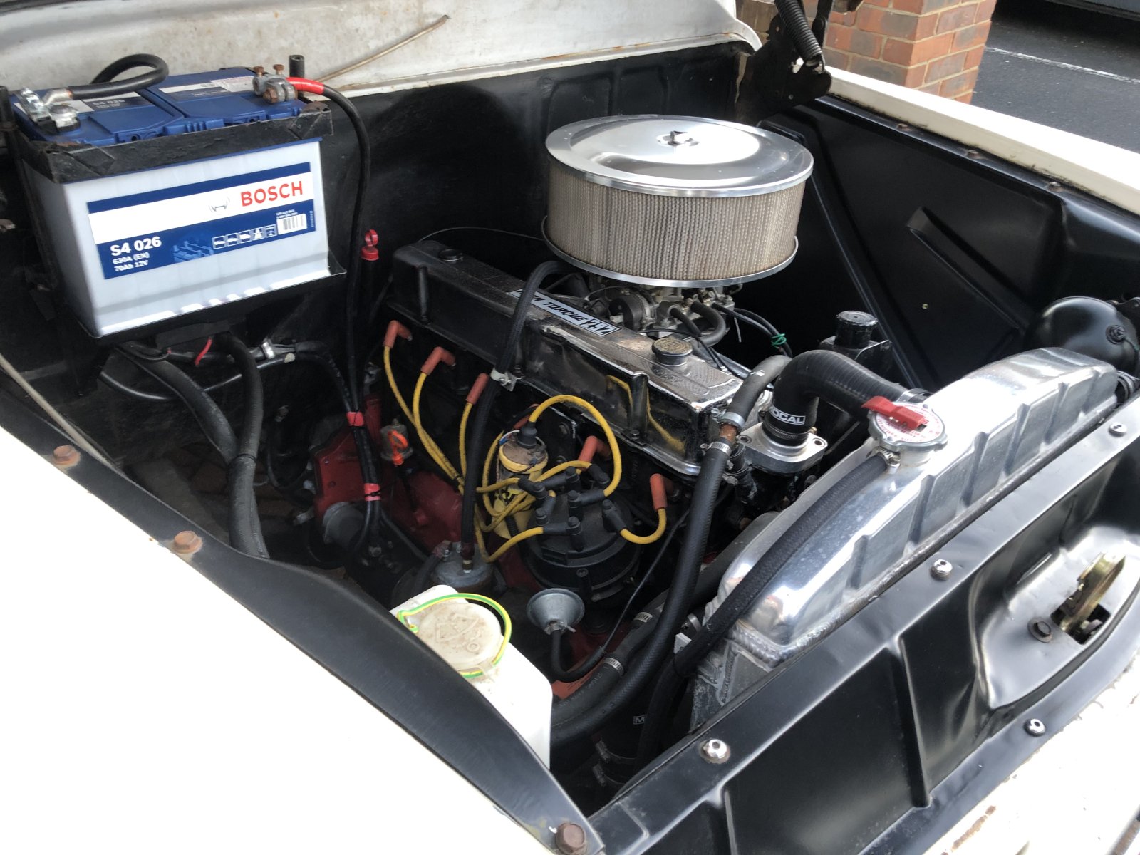

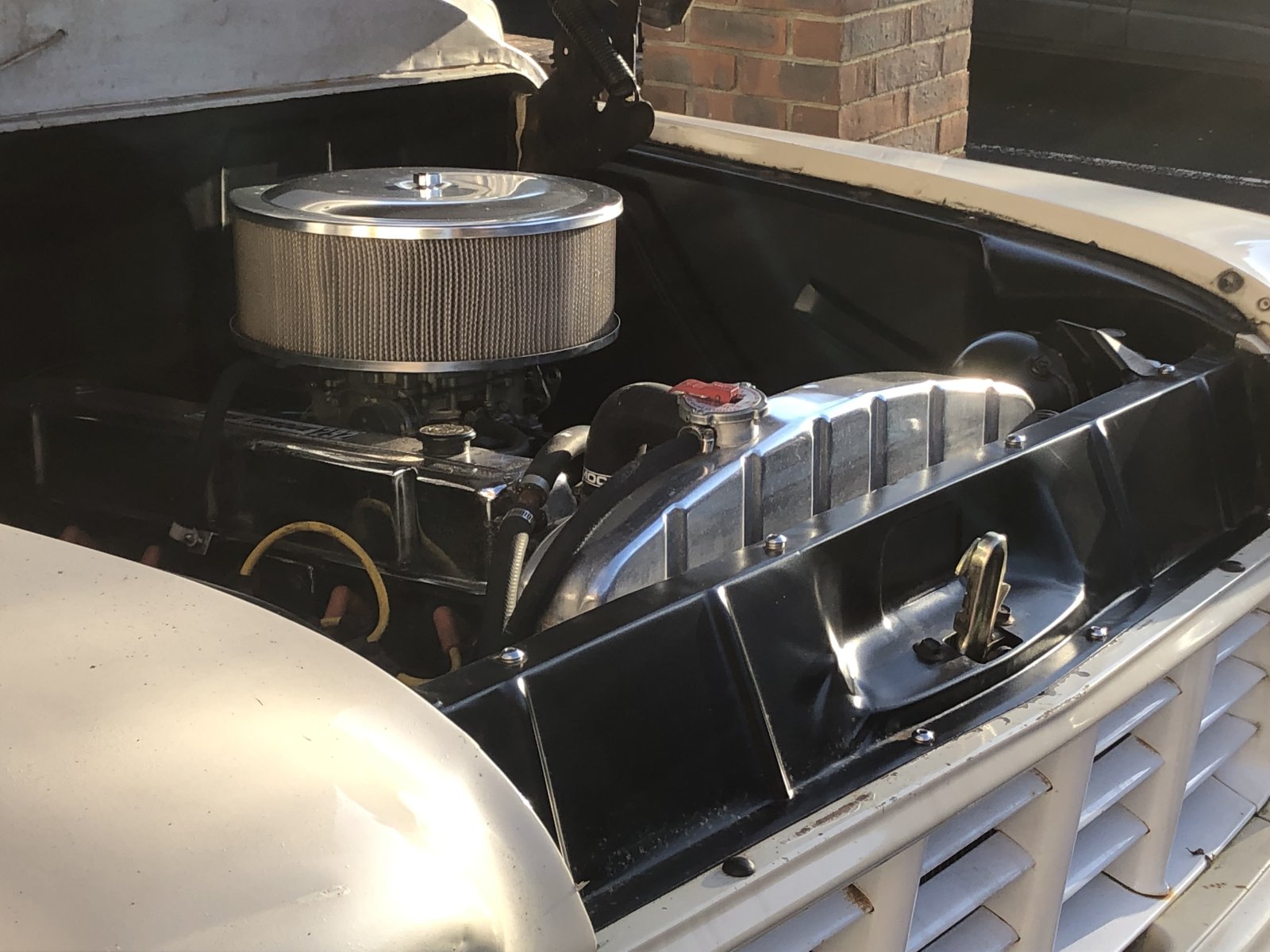

    The prices for these blocks are going up. They are the big block of the in-line Chevy range of engines. They are robust and built to last. There are some performance pieces around. I use Clifford on my own 65 292. There are others.
    You can trace the engine number for clues as to what vintage.
    If the motor being sold has had proven work done and it’s a turnkey ready to go with all the ancillaries, that’s a good deal, in my humble opinion.
  25. Mr poopy pants
    Joined: Dec 3, 2005
    Posts: 139
    Mr poopy pants
    The 230-250+292 can interchange heads I believe. So they are all the same length. The bigger 292 motor is about an inch taller to allow for the longer stroke. Straight forward swap good luck
  26. Mr poopy pants
    Joined: Dec 3, 2005
    Posts: 139
    Mr poopy pants
    I used stock V8 SBC motor mounts. Easy to find and lots of quality options. The 292 has different versions of motor mounts. An inch taller and also I’d say an inch longer depending on the water pump and ancillary set up.

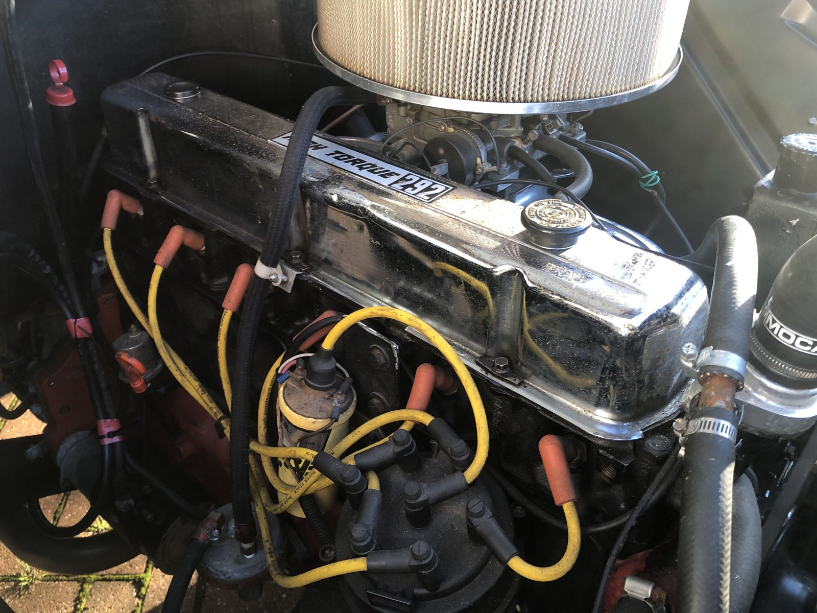

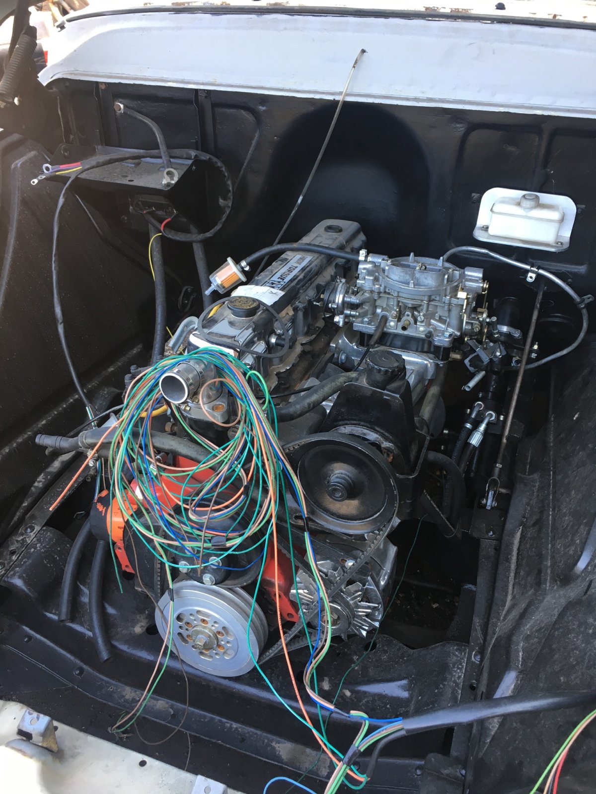

    Mr poopy pants
    54E3DB3E-38B3-4816-B8BF-686EE3FB0194.jpeg E265E69E-C797-4649-95D6-D18AD3113ADC.jpeg 7CC04DB2-D633-47AC-9426-DA6B79251B93.jpeg 234F610E-AE45-4266-A81F-30911D28EFD4.jpeg A few engine bay snaps
  28. Mr poopy pants
    Joined: Dec 3, 2005
    Posts: 139
    Mr poopy pants
    292 engine mounts. These take standard V8 SBC mounts.
  29. Mr poopy pants
    Joined: Dec 3, 2005
    Posts: 139
    Mr poopy pants
    I guess with a little Hotrod enginuity anything can fit 386F662F-935A-4D08-B32A-CEF279ECB7FB.jpeg
