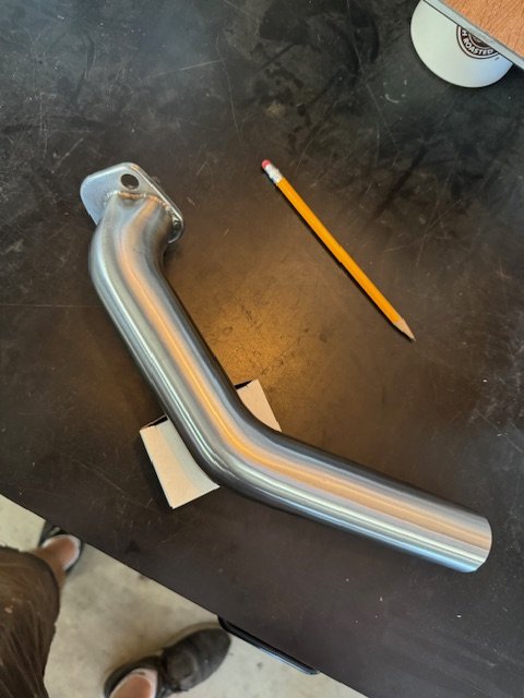

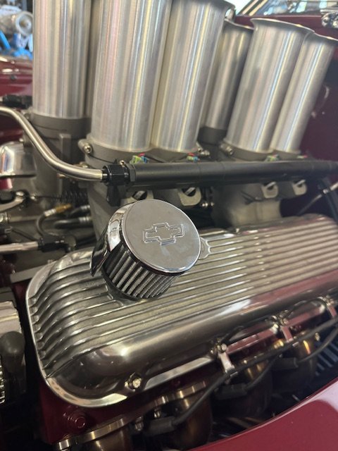

  1. I've been working on a Hilborn Injected BBC and have a blow by issue. There's no way I know of to setup a PCV so I have as much breathers as I can on the engine but it doesn't seem to be enough. Under load it'll still try and push the dip stick tube out and oil as well. It also oils around the distributor. So now I'm beginning to explore other options. I currently have a breather on both valve covers, one sorta on the valley & made a plate for the fuel pump boss up to another breather. Any other practical Ideas???????

    Depending on your exhaust system, you could run a header evac setup, but it's not the best thing on the street by a long shot. You could run that valley breather fitting to either a belt mounted vac pump or an electric-even in the trunk if you really want it clean. But maybe it's best to start off with a leak down test to make sure the mill is tight.

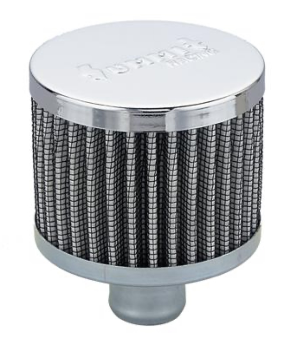

    I suspect your current breathers are restrictive, maybe open element breathers as shown below would help. IMG_1897.jpeg IMG_1898.jpeg

  15. I stuck these breathers on that I had laying around to see if it made a difference. Seemed to have helped especially with the oil coming out of the dip stick tube but I'm still getting quite a but from around the distributor.

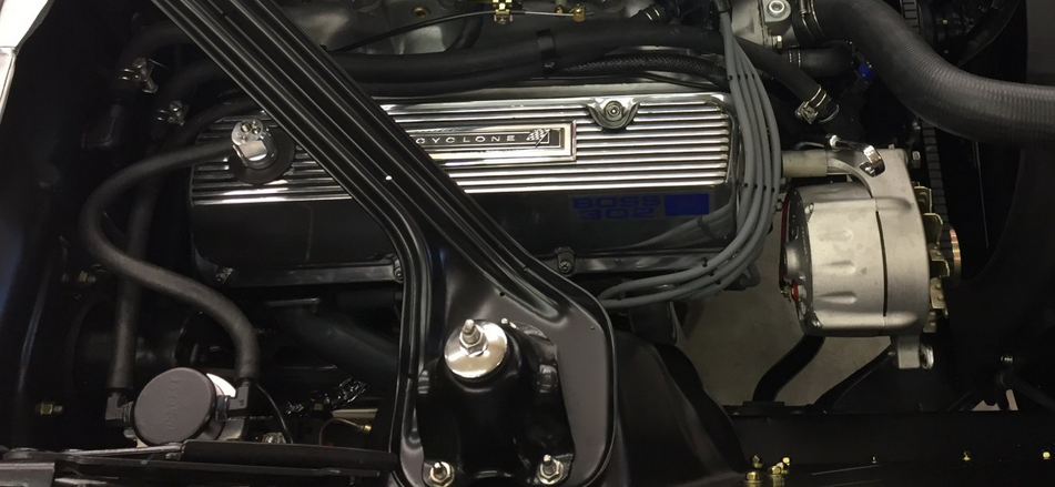

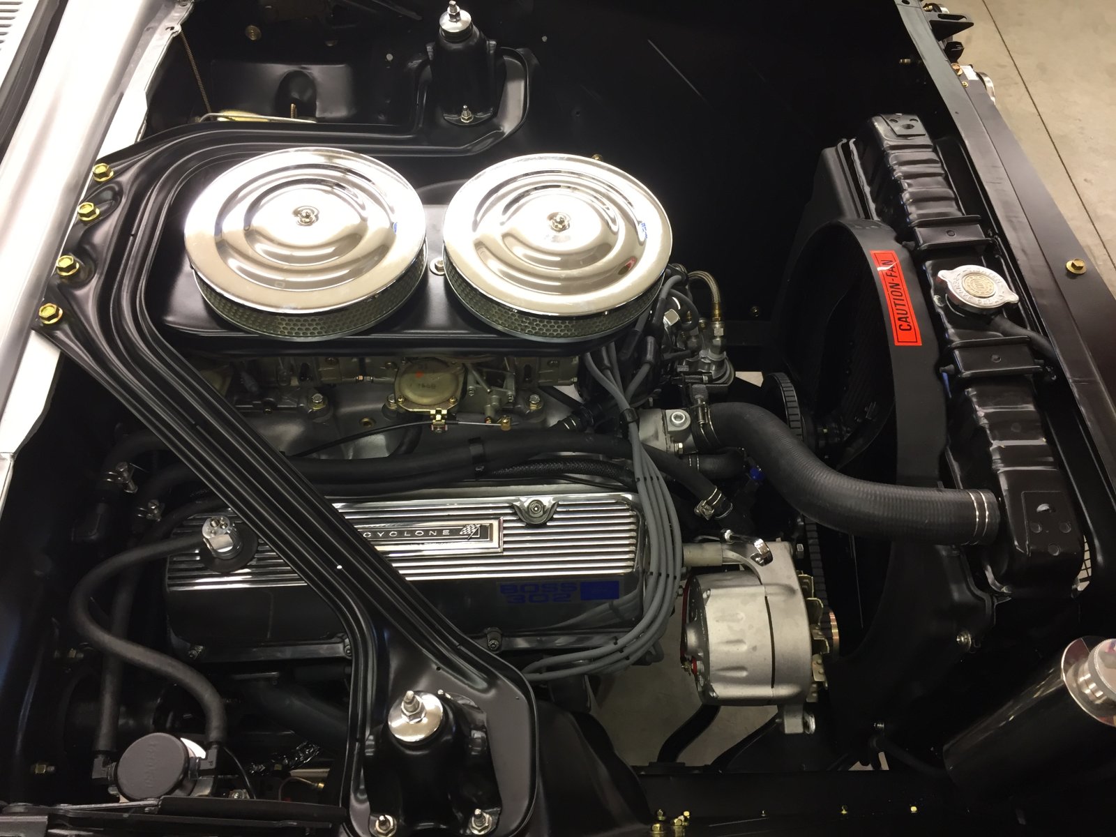

    I you confirm the engine itself is in good condition with no excessive crankcase pressure the Wagner PCV valve may be a good option. I installed one on the mild built Boss engine in my Comet and it has worked well.
    https://mewagner.com/?p=444
    Here is the valve in the RH valve cover, it is plumbed to a small oil separator then to the base of the rear carb.

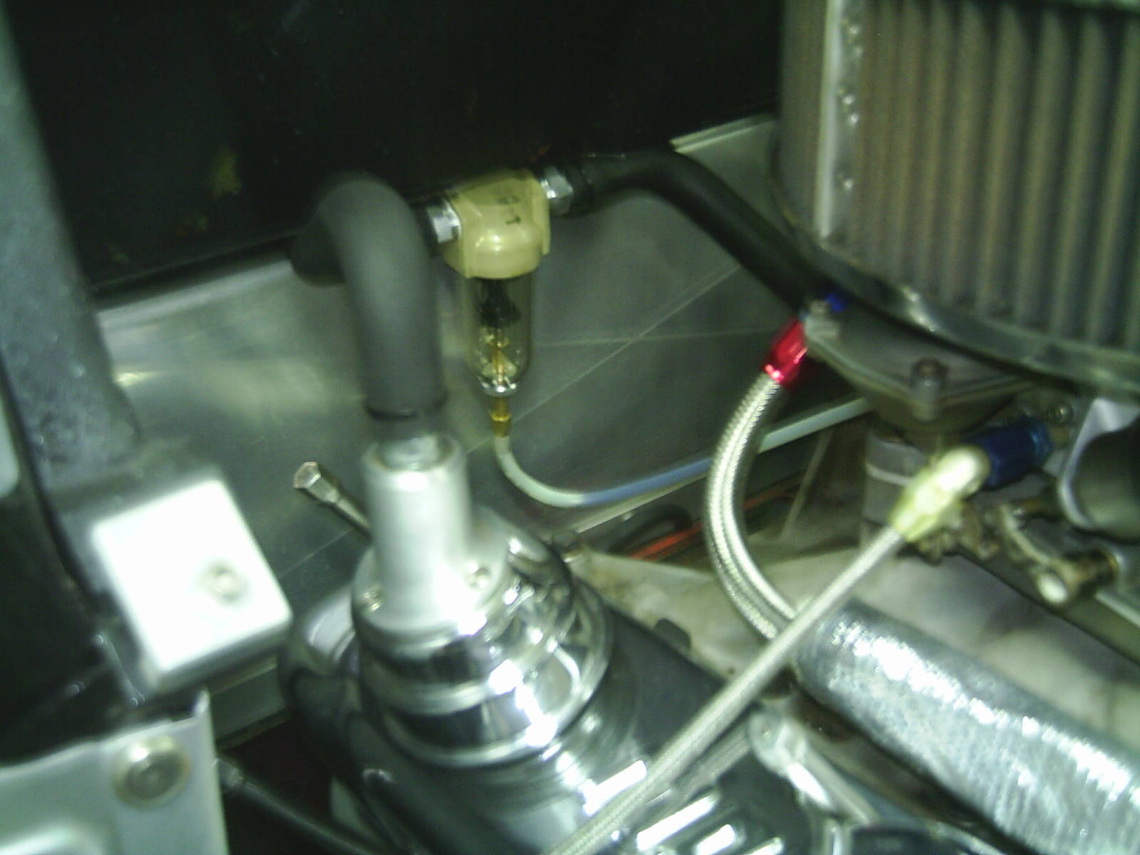

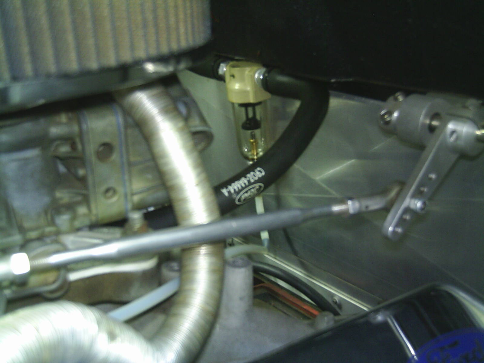

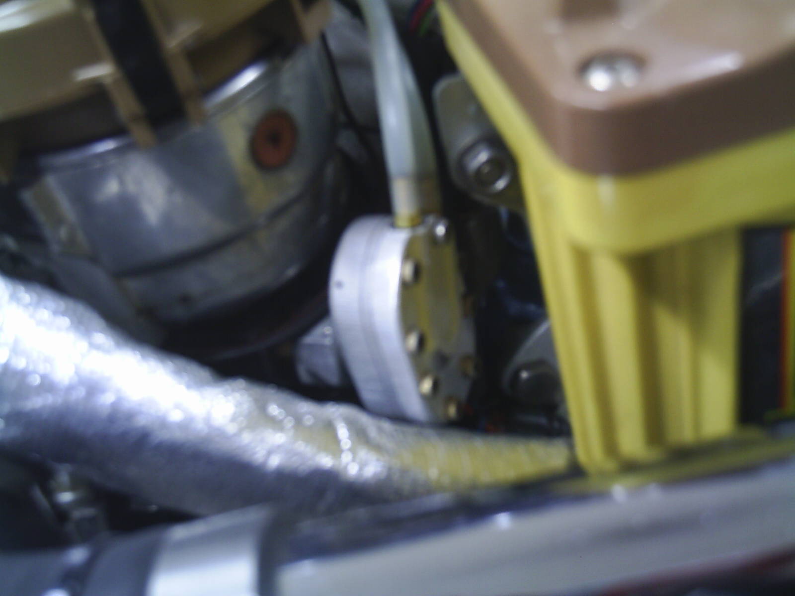

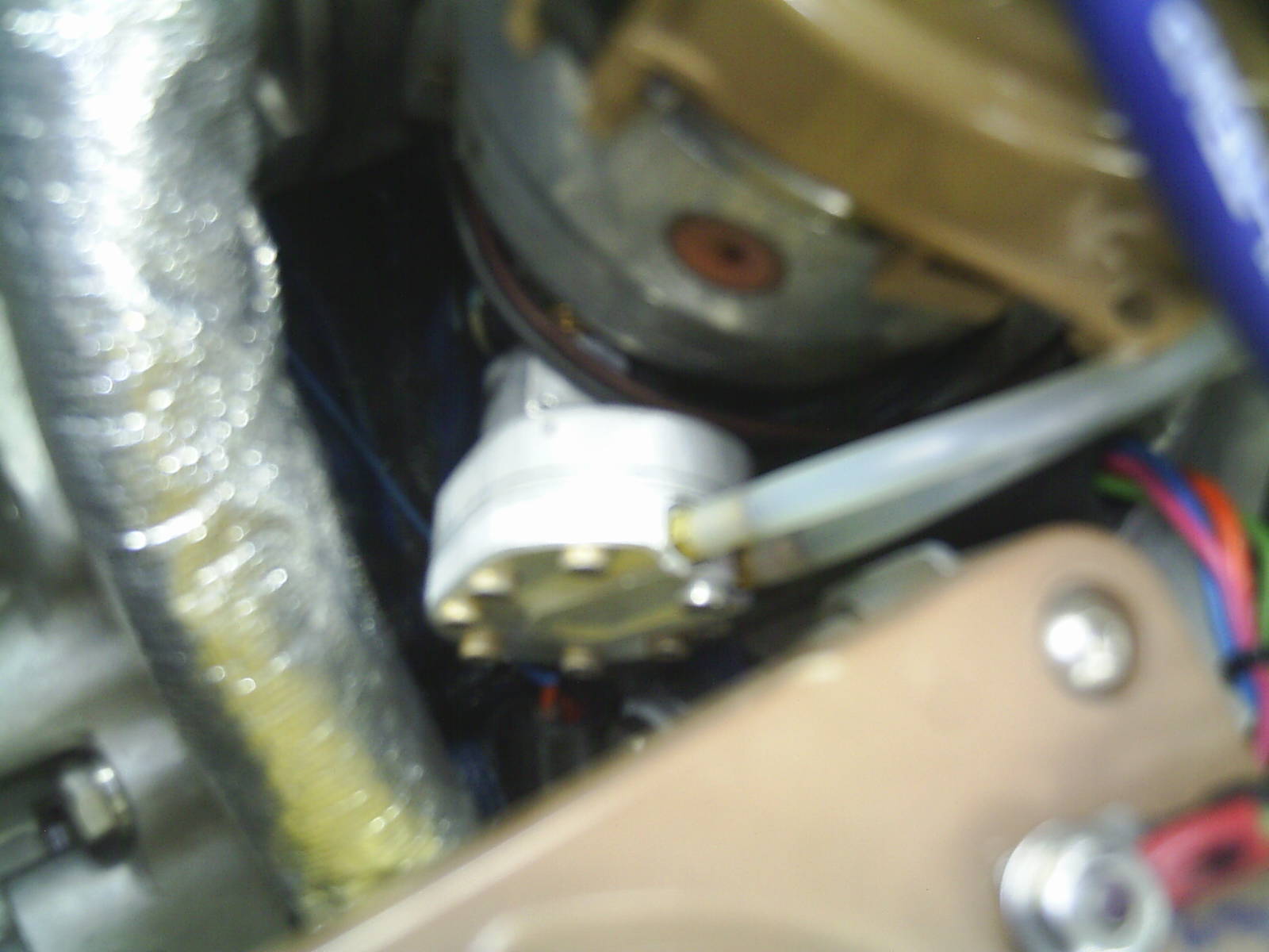

    PCV oil evac 001.jpg PCV oil evac 002.jpg PCV oil evac 003.jpg PCV oil evac 004.jpg PCV oil evac 005.jpg I noticed a lot of oil going into intake from PCV valve, not from blow by as blocking the other valve cover PCV intake would show crankcase vacuum. So I put separator in line. It did the job well but as bowl filled it would p*** oil through. So to continuously empty bowl I added a scavenge oil pump. First pic [top to bottom] PCV valve to separator. Second pic from separator to intake vacuum source. Third pic is small gear oil pump mounted to dist tach drive. Forth pic oil line from bottom of separator bowl that goes to dist mounted pump. Fifth pic is another view of pump. Exit oil line goes to old dipstick tube hole and some oil is metered through the mount into the dist to lube the gears. Cut oil loss/use by about 80%. Been working for over 20 years.

    Trick setup! How much air do you think the gear oil pump pulls into the crank case with the oil?
