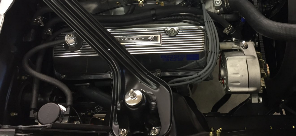

  1. I think the Idea with the collar is so you can adjust based on the valley on various setups. This is what they sent from Hilborn because of the 3 piece intake and shallow valley pan I believe.

    Now that you changed the Breather to More Free flowing then fist Pic,
    Do you Valve covers have the baffles under Breathers ?
