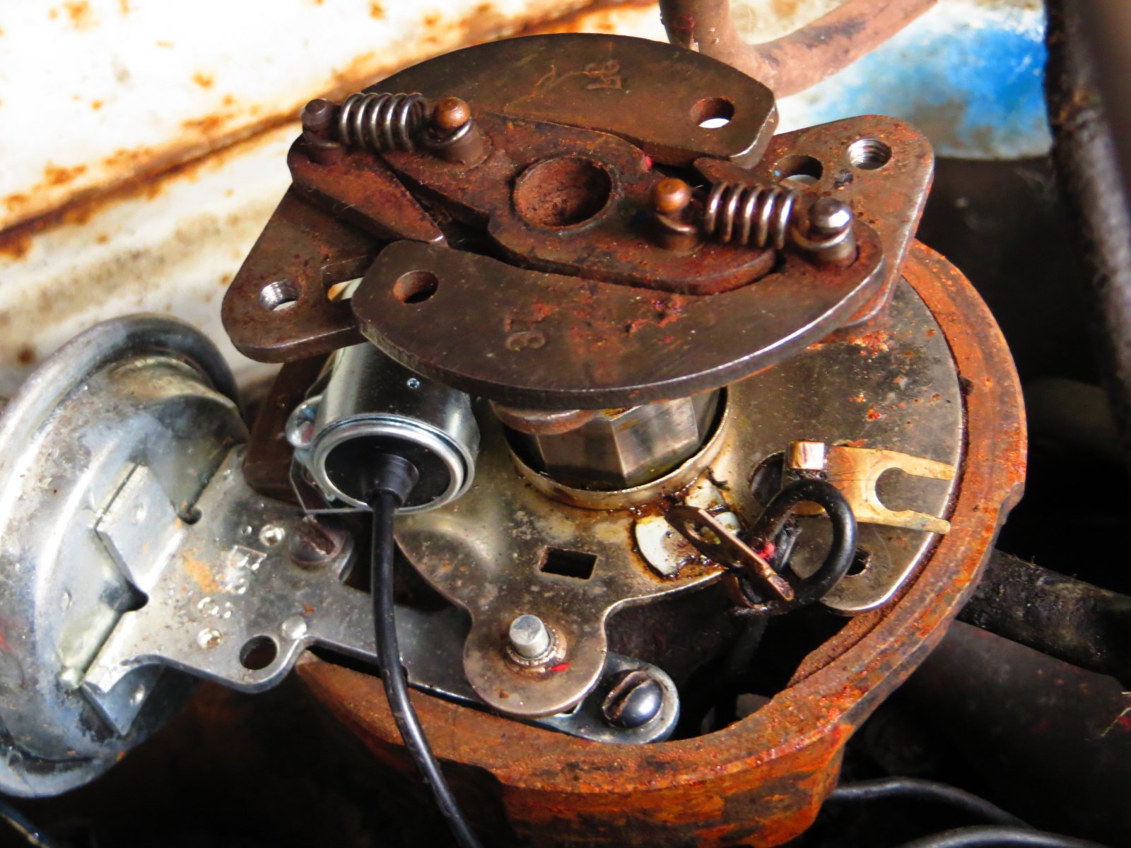

    Let's begin with the distributor now. I am aware this cap needs to be replaced. Rotor has been replaced though.
    Soo umm, this doesn't look good lol. I might have to replace this whole thing? :( I replaced the condenser there. I may have to look up a re-builder in Oregon. Do you guys know of one?

    I use metal fuel filters and the distributor really doesn’t look very bad…also I’m a big fan of the original Carter’s over Edelbrocks but if it works it works.

    On the distributor Make sure you can rotate the top portion against the springs and that it springs back, if it springs back that's good if not it can be fixed. then try to move the shaft side to side, if real loose that's bad but it can be fixed also.

    Not seeing any points in that distributor.
