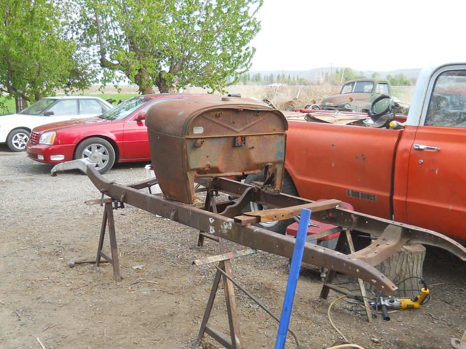

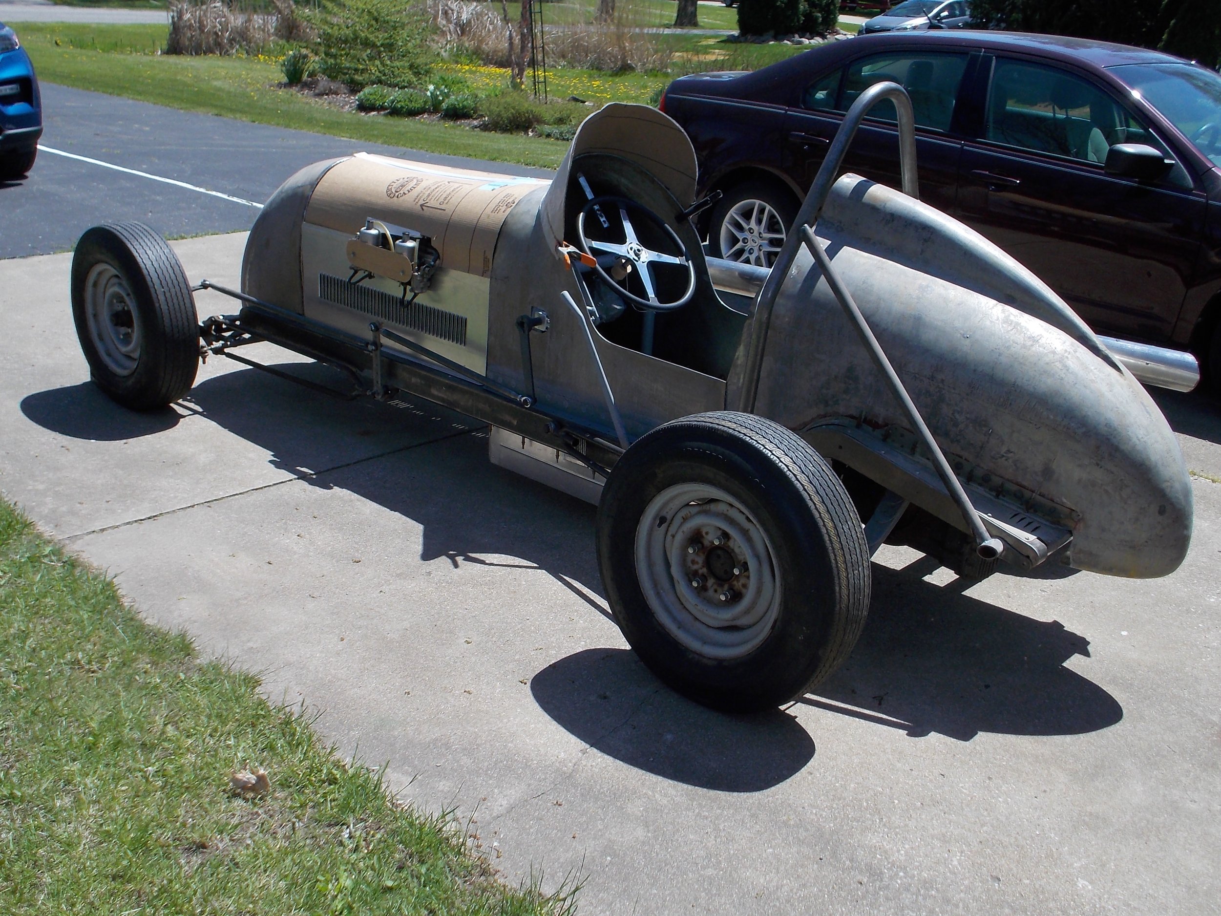

    I'm using a late 20's Chevy frame on my boat tail that is supposed to end up looking like an old two seat race car.
    I rescued the frame from a rat rod dude and then because the rear panel had been hacked out pulled the rails in so the rear springs will be parallel to each other.
    The whole idea is that it looks like an early/mid 30s two seat race car when done.

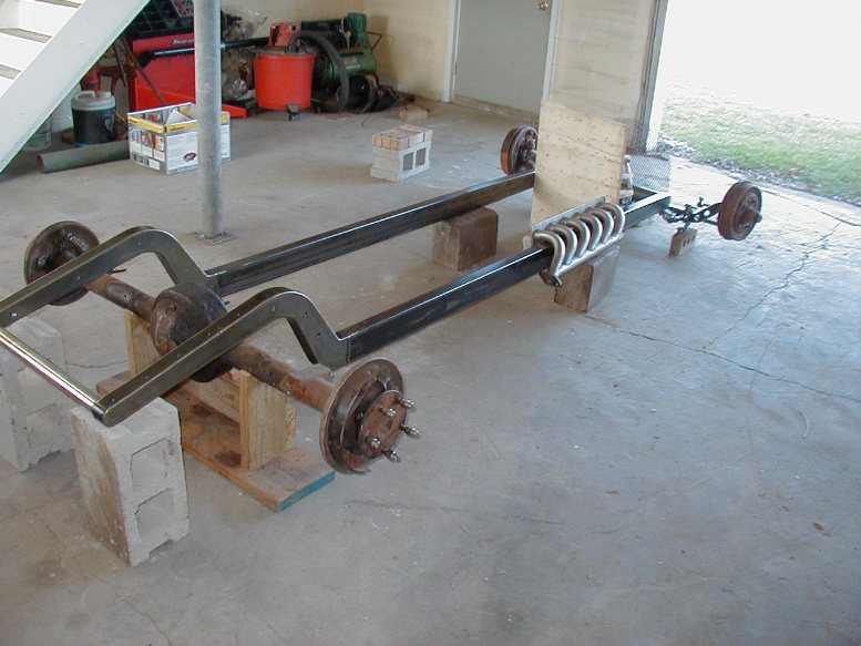

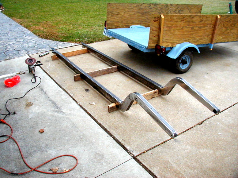

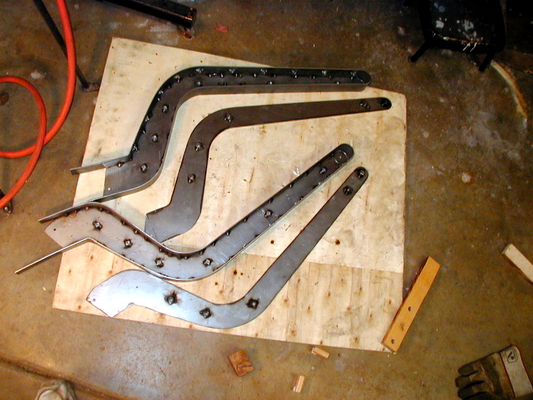

    For my '30s era champ car I used a combination of 2 x 4 rectangular tube and flat plate sections for the rear kickup. I welded in weld nuts where I needed anchorage for shocks, exhaust, pumps, etc. I pie cut the front of the tube to pinch it down to 3" at the front crossmember, starting where the hairpins attach to the frame.
    I used a Ford 9" rear beacuse it is universally used with lots of aftermarket support. I doubt if it is appreciably heavier than weaker, less popular units. Mine has a QC grafted on for the look.
    Good luck with your project. Check out my nearly identical build below.

    Hey flyer very nice job. I'll check out the build thread when I have more time. You did a nice job adding those rear horns to the frame. Back to the dozer today and then cleaning up trees, t******* and cleaning up river bank. Have a great weekend. Vintage Indy, Clyde

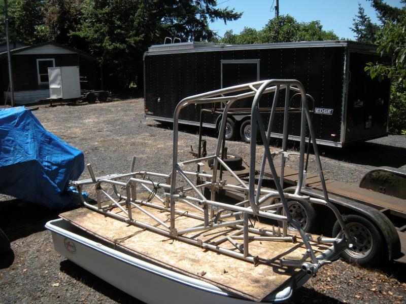

    IMG_8465.jpeg IMG_8465.jpeg IMG_8465.jpeg There was an Aluminum WOW 410 car t the Chili Bowl this year they had to reinforce the rea frame at the torsion bar mounts because it twisted it’s owned by Shane Carson out of OK city. It was so light the WOW circuit promptly declared it illegal and added a minimum weight rule. It was built by Don Nance. IMG_8465.jpeg
