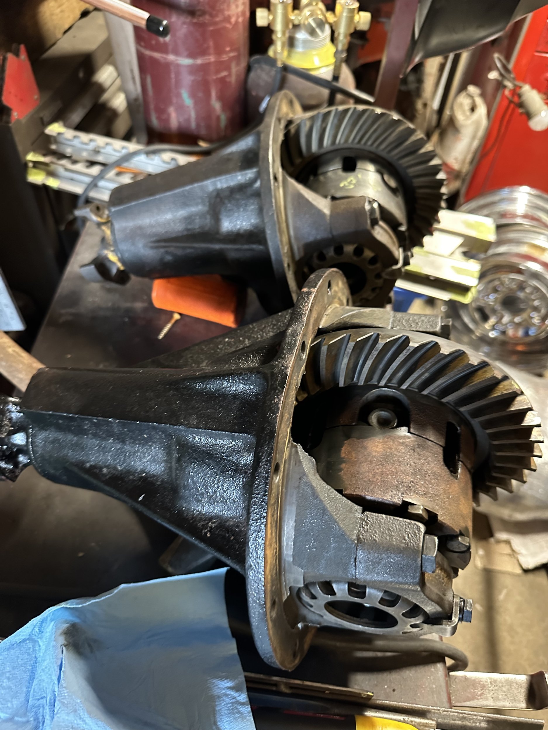

    It’s time to start on my rear axle for my ‘60 El Camino. I’ve got a 59 3.08 posi and a 64 3.36 posi. I took the 3.08 out of a 348 parts car that had set since ‘75 in a damp field. I got the 3.36 from a house flipper cleaning out an old biker’s lair. Confederate flag floors and every inch of the walls covered with easy rider centerfolds. It was hidden under a bench. I hope to put the 59 in my ElCo and save the 64 for my 63 SS in the future, but I’ll use whichever works now if I need to. I’ll probably use a 3.55 or 3.70 gearset. I’ve got a 350 with an M20. I’ll run 14” wheels and not too much tire.
    I’ve never gone through a differential before, so I’ve got some learning to do. It’s either learn on this one or putting lockers in my OT Jeep. The 59 reared was leaking like crazy so I figured I should reseal it. So I might as well put bearings in. And clutches. And re-gear.
    I think the 59 posi is virgin, but there’s pitting from sitting. The 64 has been messed with and has loose fasteners.

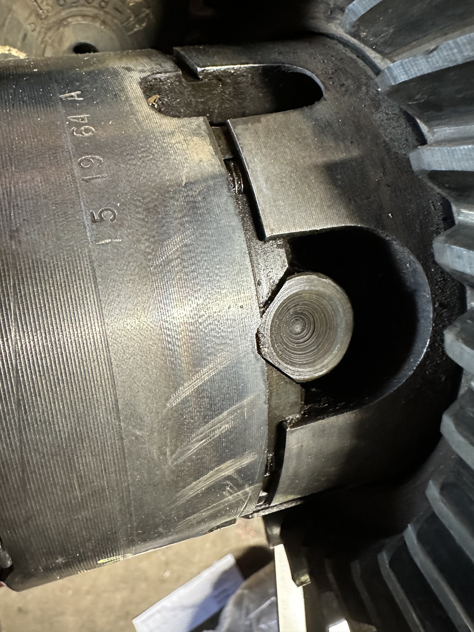

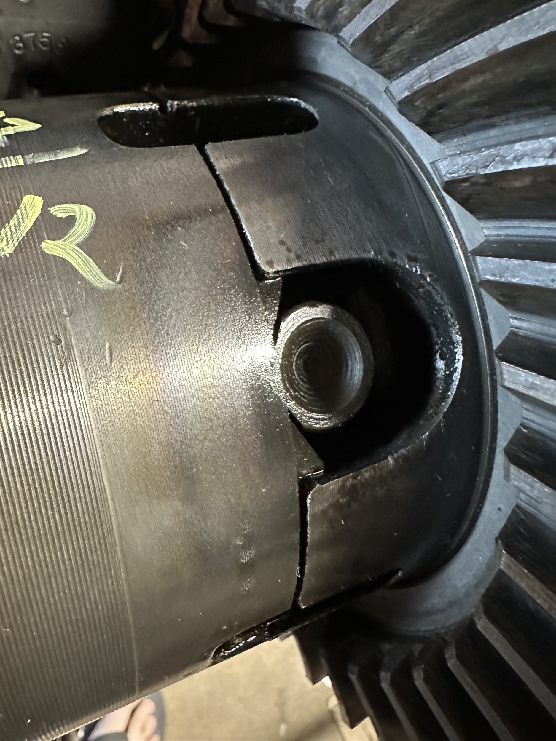

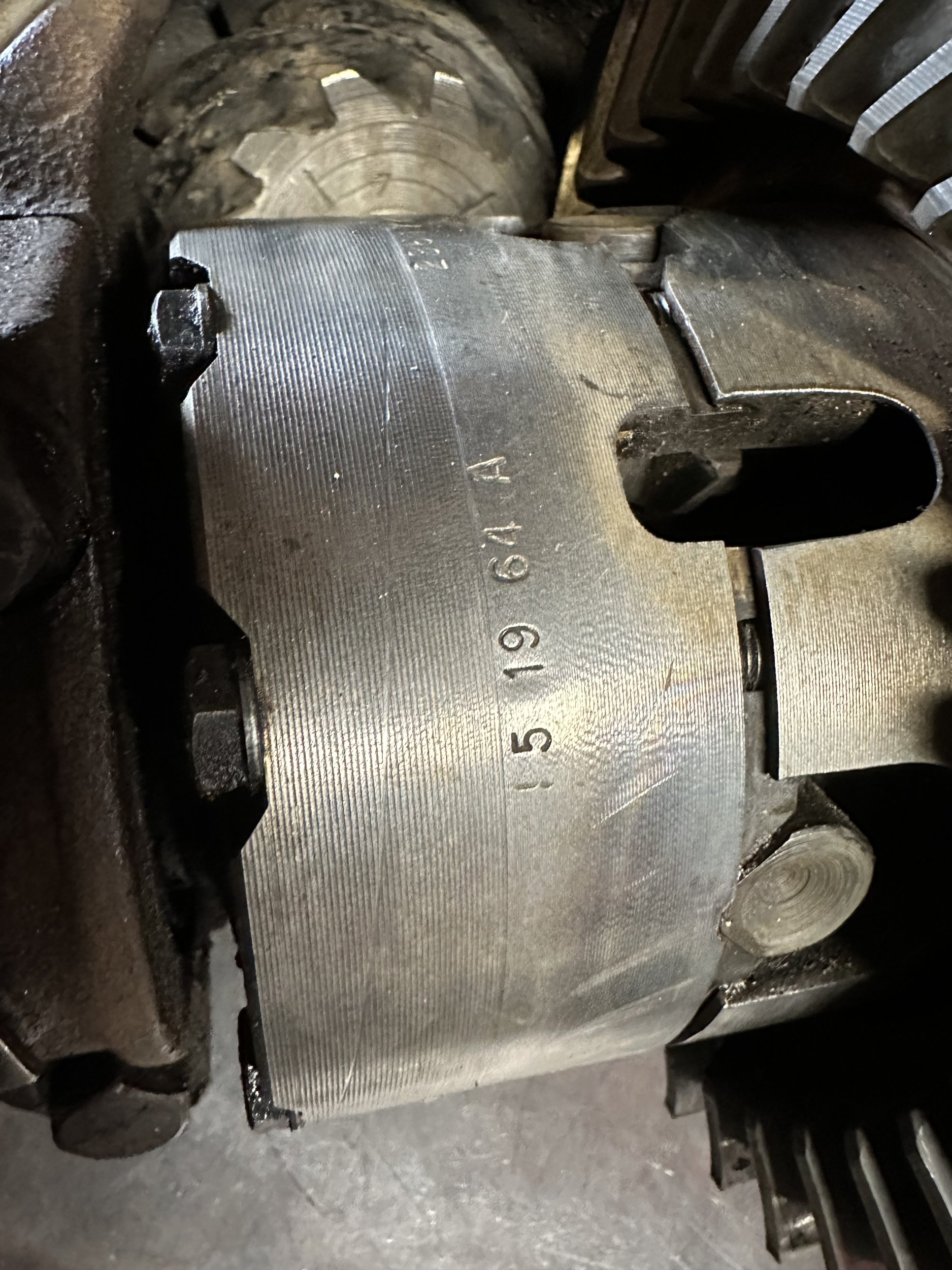

    Both carriers have some bluing where shafts come through the body. Is that normal or is that heat and disaster?
    Pics:
    The bluing for lack of a better term:

    Thanks Mike! Any concern with the discoloration around the cross bars?

    I wouldn’t run a bearing with a blue color. Indicates overheating, lack of oil, etc.
    But the shafts I wonder about, they don’t have the stress of a bearing on them.
    Guess I’m saying “good question”.

    The fact that they’re both discolored in the same spots is reassuring, but it does make me nervous.

  9. The bluing, if I'm looking at the right spot, might be where some used torch to heat the cross pin, to get it out? Maybe. Maybe forgot to take the locking pin out first, and was wondering why the cross shaft was stuck.
