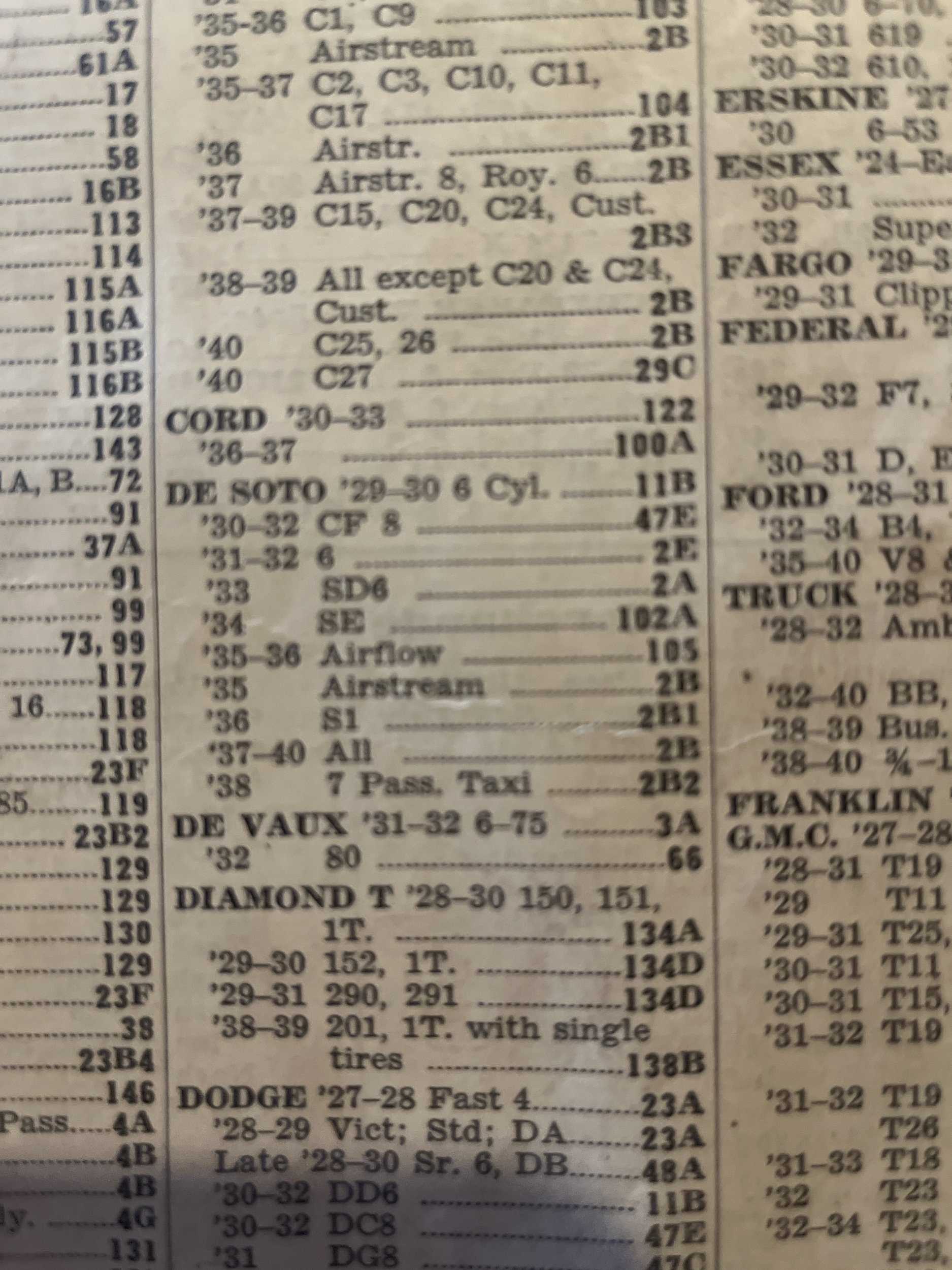

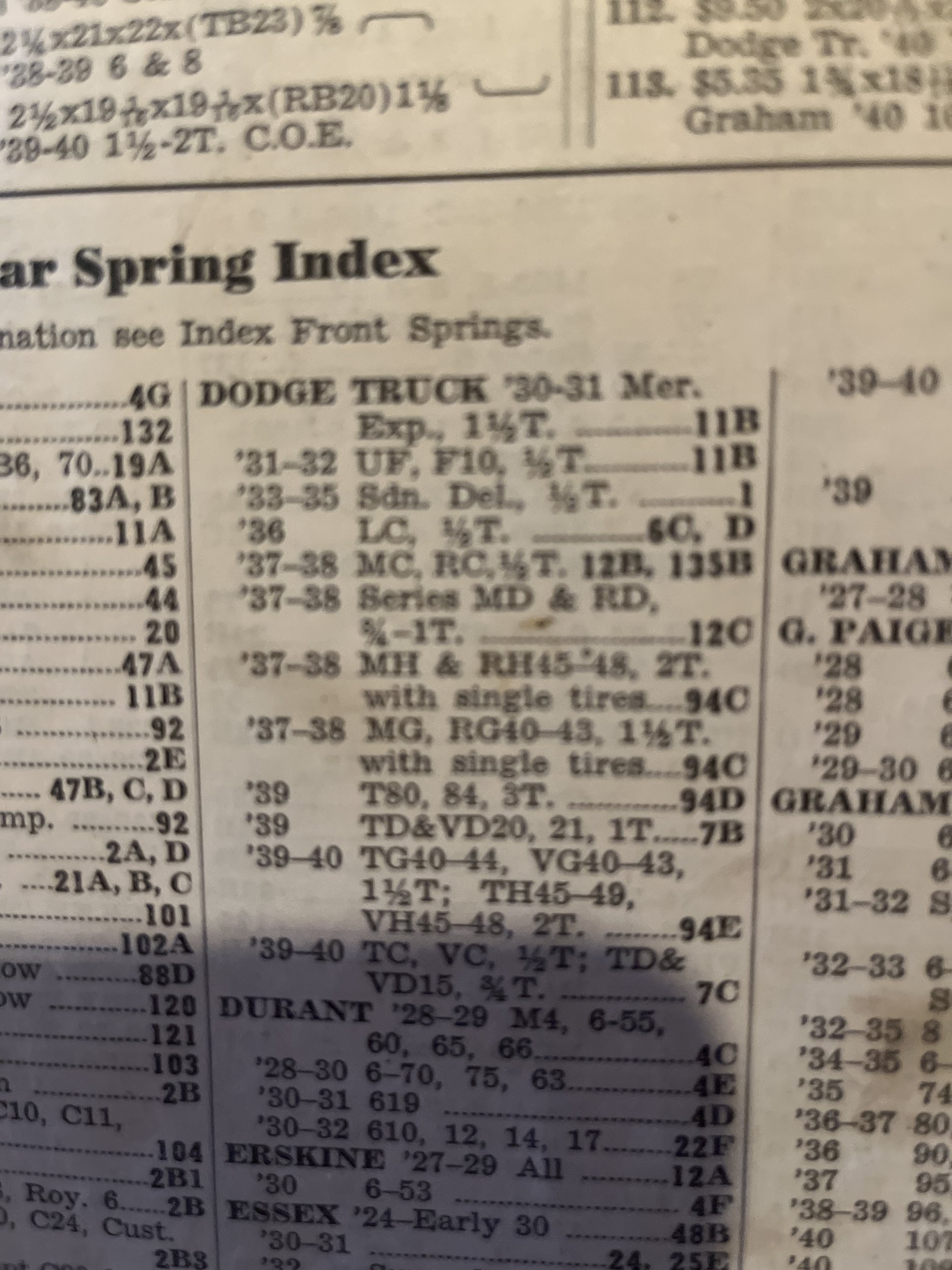

    Check your PMs, this thread just popped back up
    Nailhead A-V8 and lothiandon1940 like this.
  19. Budget36
    Joined: Nov 29, 2014
    Posts: 15,839
    Budget36
  20. Budget36
    Posts: 15,839
    Budget36
    As I mentioned, so, if your Desoto is a 6 cylinder car, should be correct to use my F10 springs.
    I’d only guess spring rating would change for other models? No clue.
