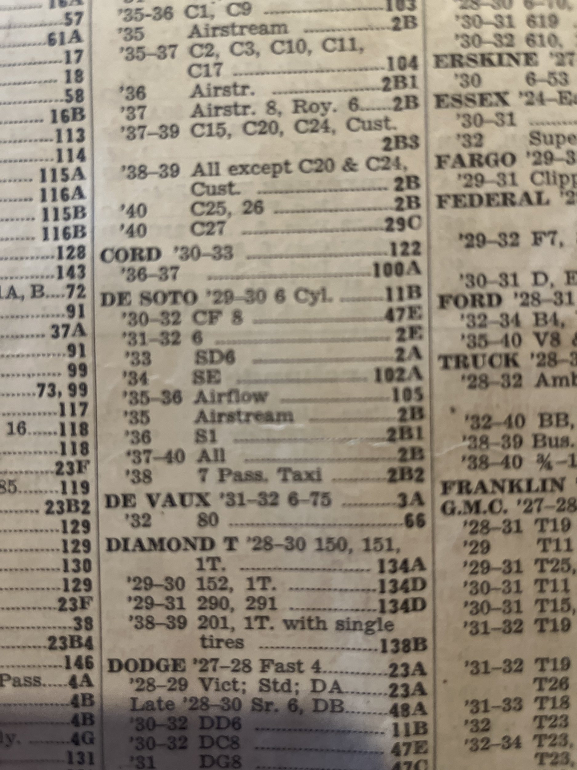

    When the heat sets in today, and I go inside, I’ll scan through the manual I have and see what else will swap.
    Do you know which Desoto it is/was?

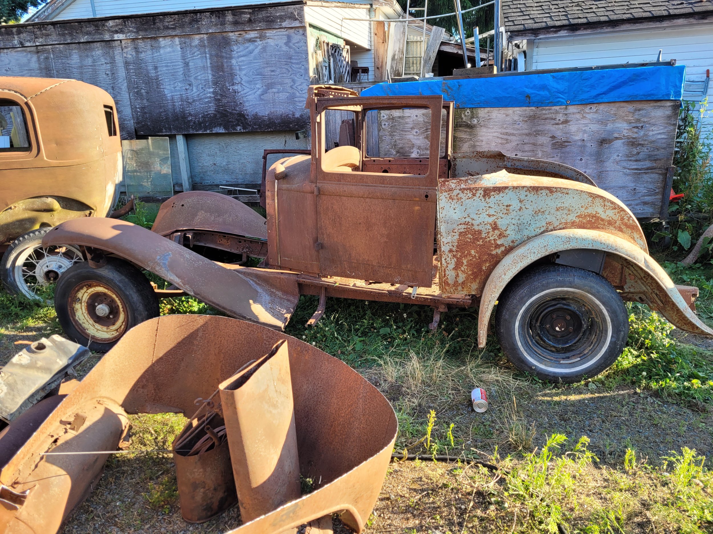

    from what I have of the remains it is identical to the Plymouth model 30 U [​IMG]
    I'm trying to make this:

    While I’m waiting to charge a battery…

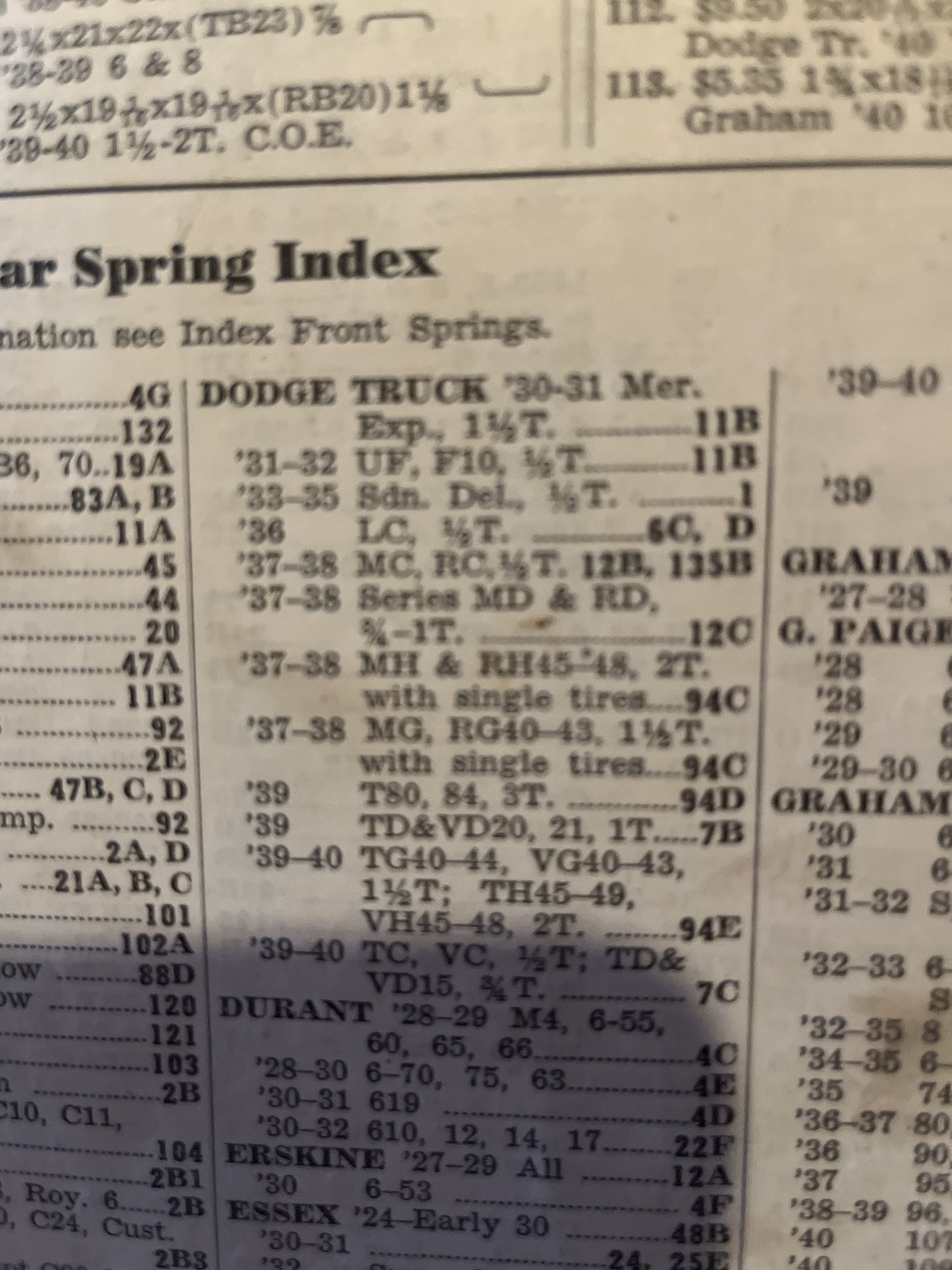

    29-31 Plymouth (no model designation) uses an 11B
    ‘30 Chrysler CJ 6
    30-32 Dodge DD6
    are what I see uses the 11B as well.
    Sharpone and Nailhead A-V8 like this.

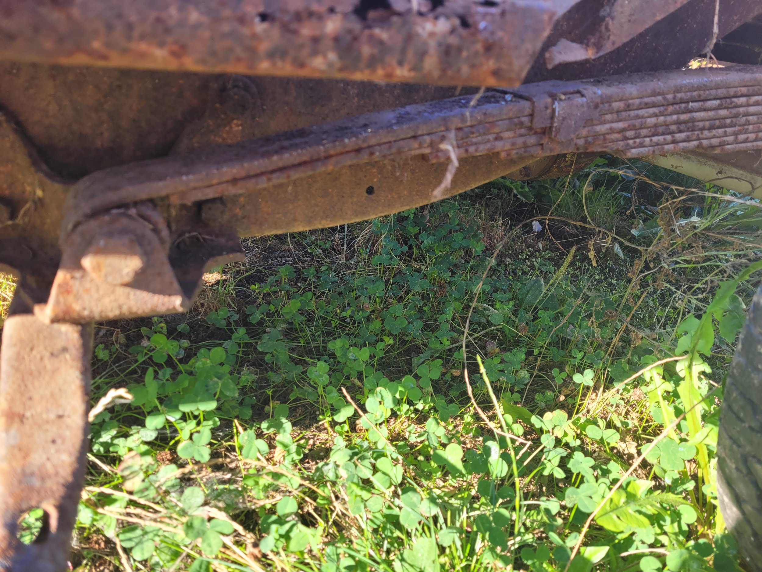

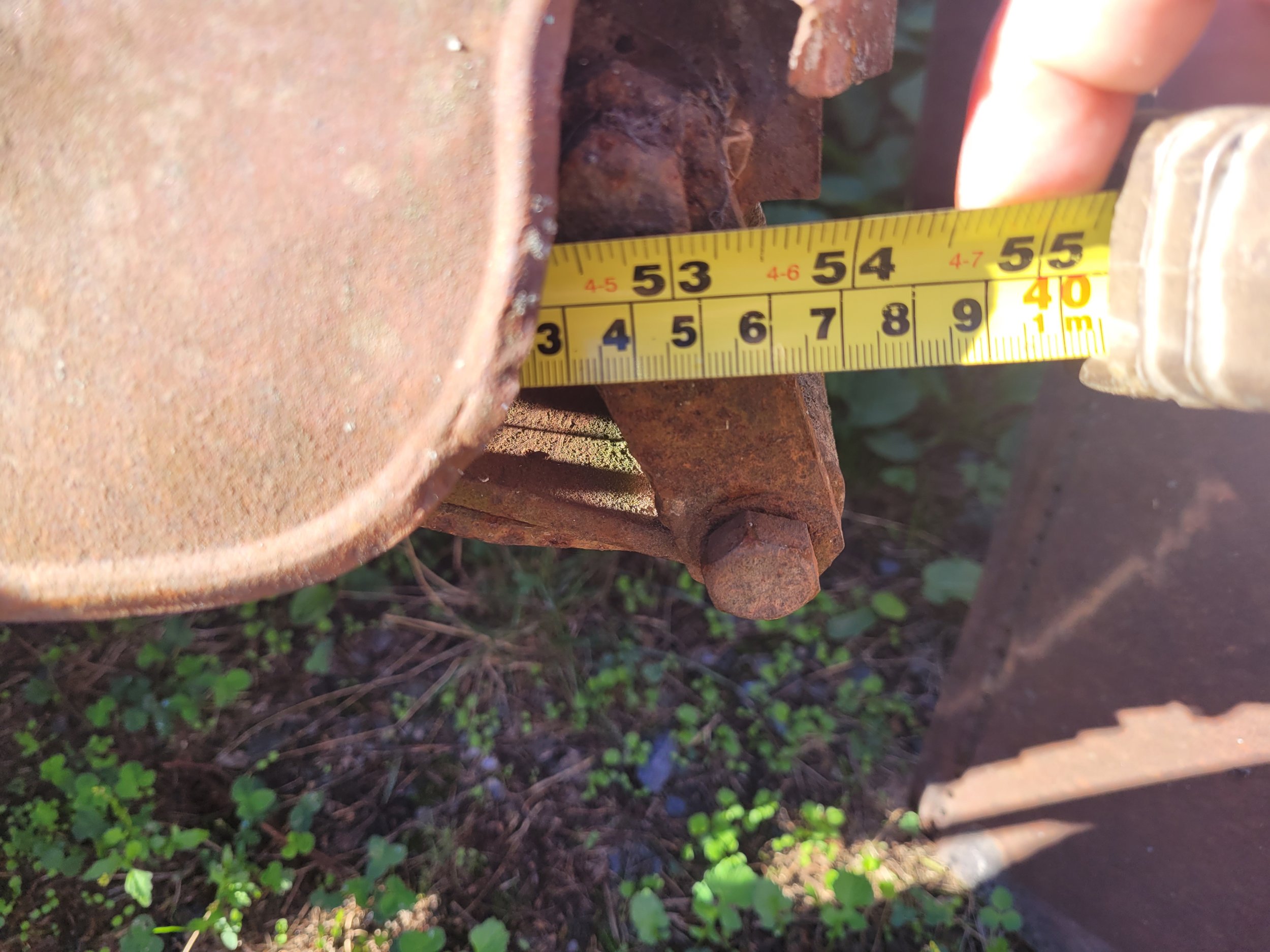

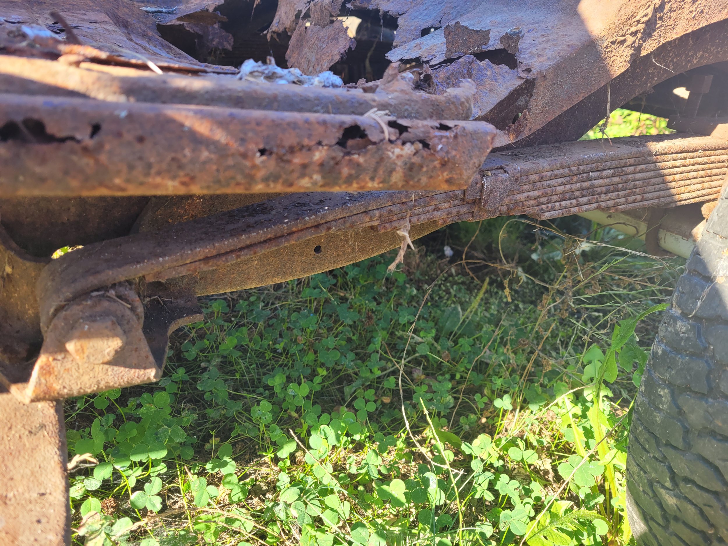

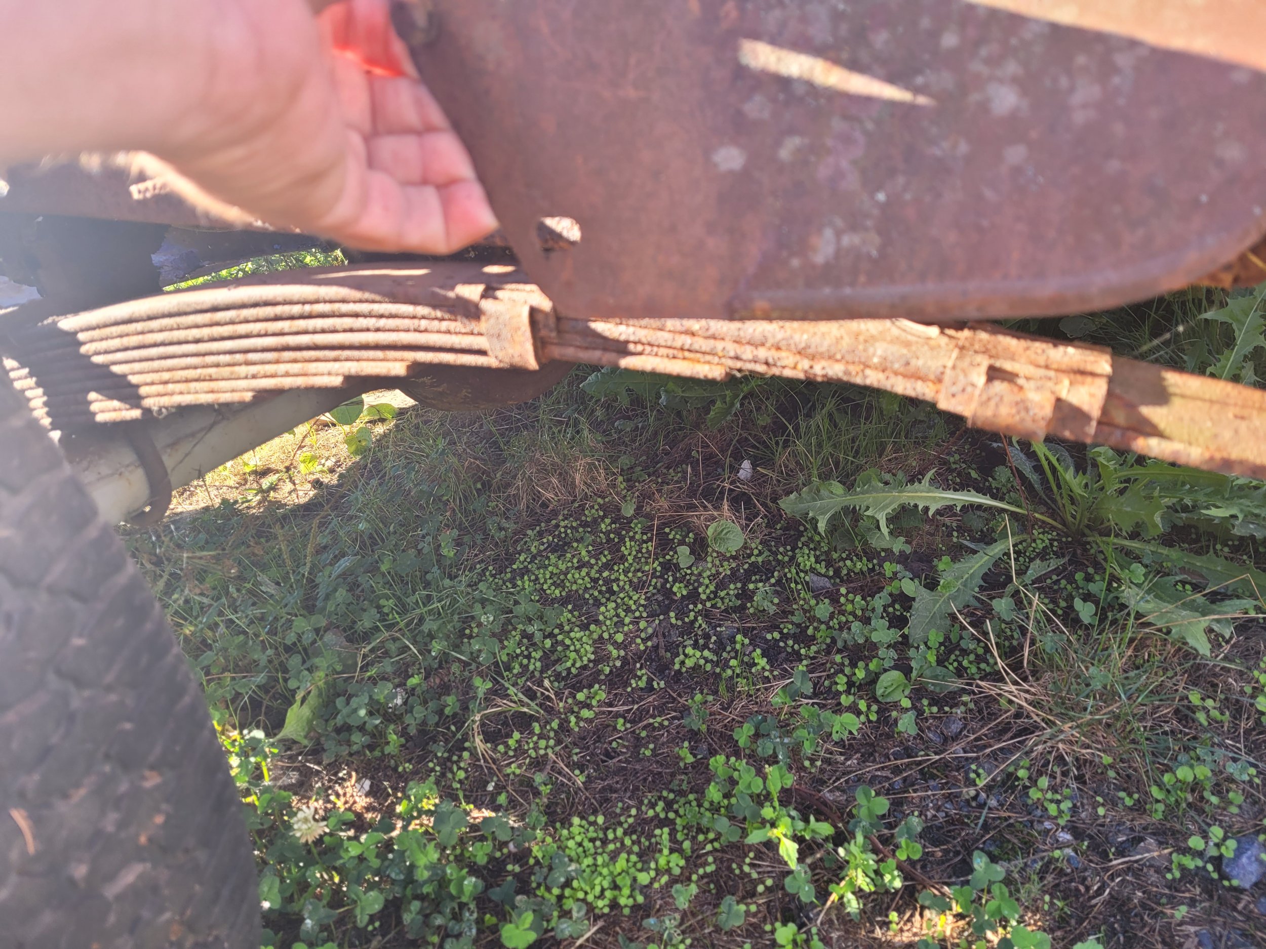

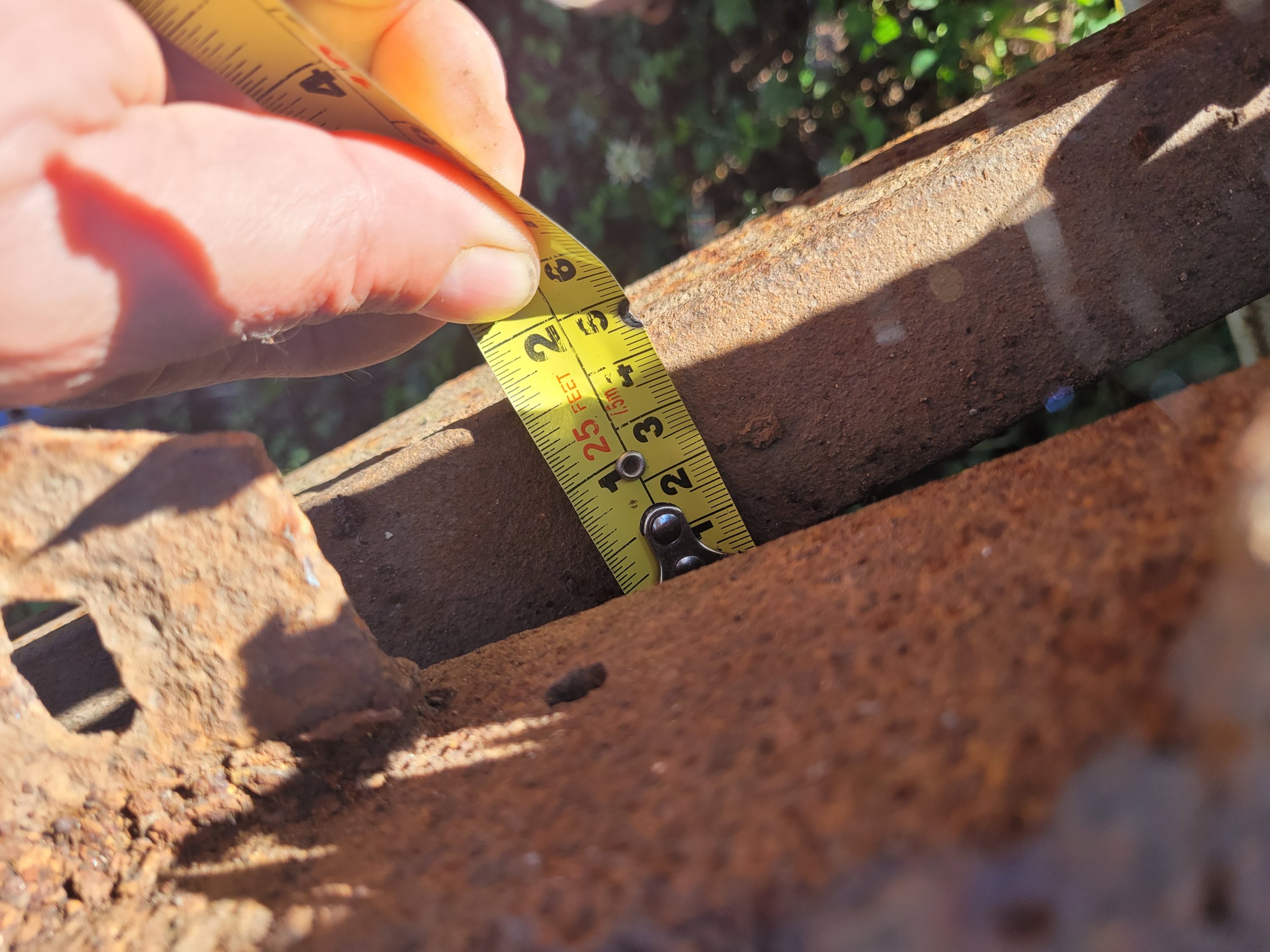

    I'm getting approx. 52 1/4" from the centre of front spring eye bolt to centre of rear shackle upper (frame) mount x 1 3/4" wide
      551.8 KB
      11
      504.7 KB
      12
    RMR&C and Sharpone like this.

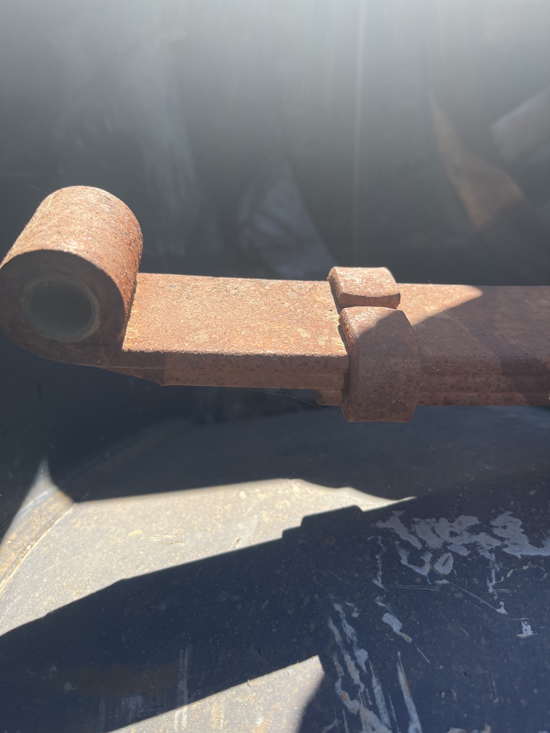

    I won't make that mistake again...pics or it didn't happen right? @Pistnbroke
    Adding somewhat to the degree of difficulty in finding replacements is that the front eye is reversed....

    looks like the spring bracket bolts to the frame, maybe take it off and flip it over? then maybe the eyes wouldn't matter??

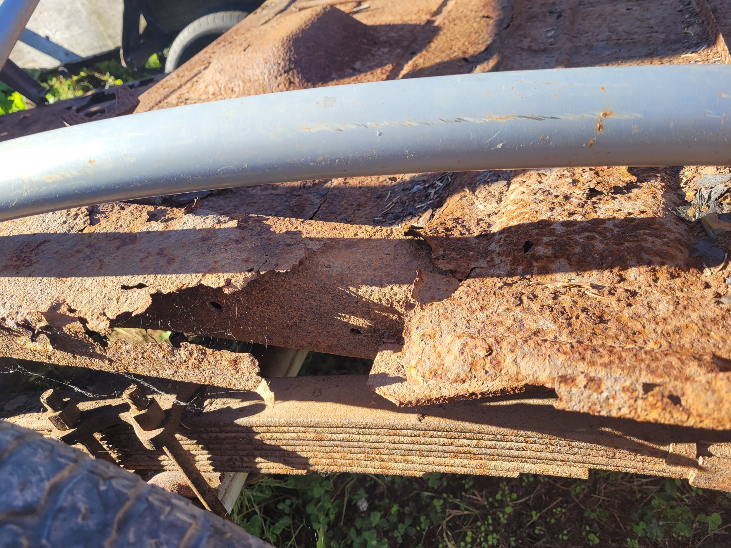

    I'm not seeing any warping or deformation of the frame...it's made of different steel than the springs which were probably subjected to the tires burning ...the guy junking the car kept the 10 bolt... said it was seized... it may not necessarily mean the bearings themselves melted

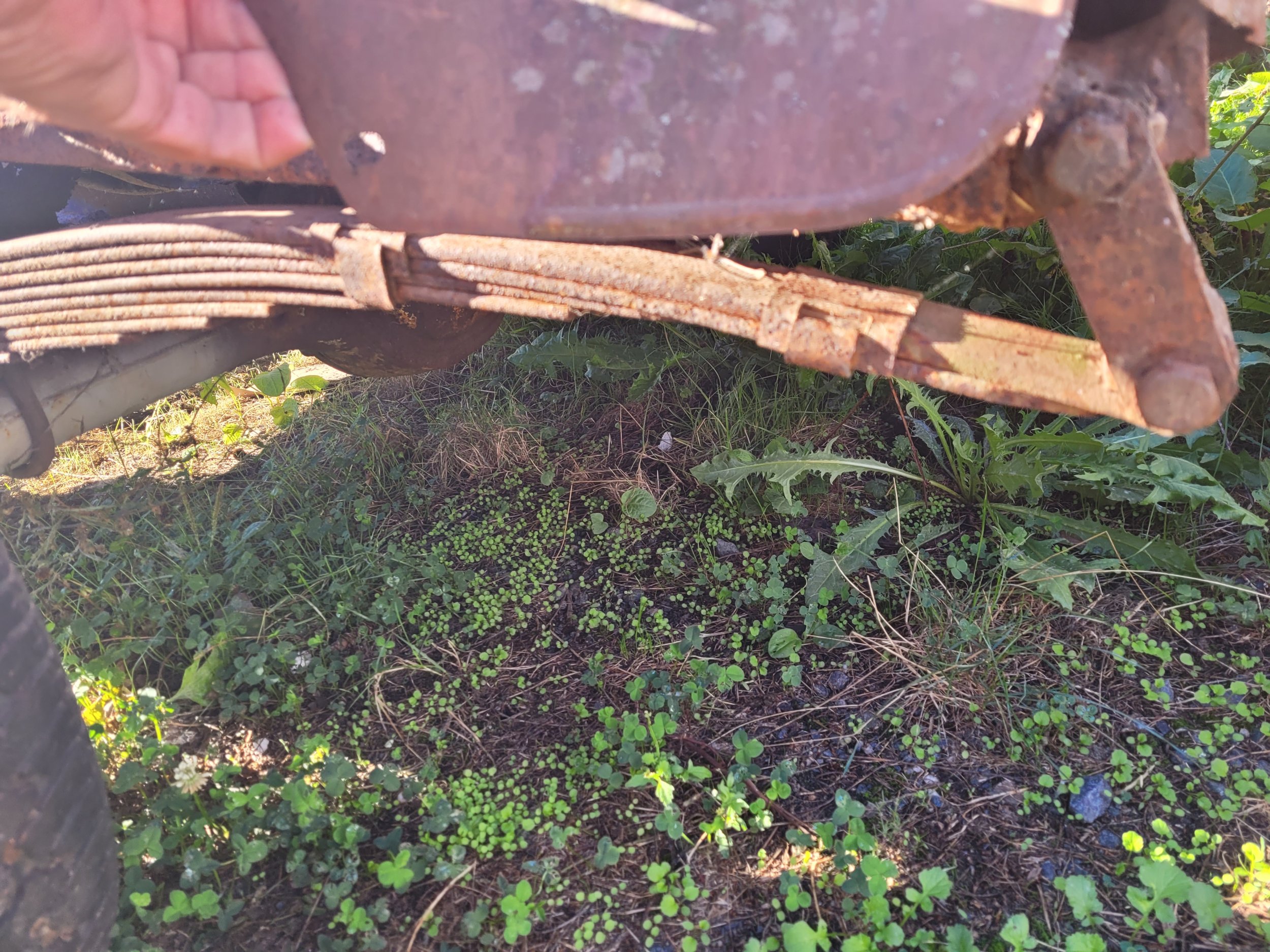

    No it’s not reversed, will get a pic on mine to show you it’s the same
    Edit: Well, reversed yes, but made that way I guess is a better answer.
    Nailhead A-V8 likes this.

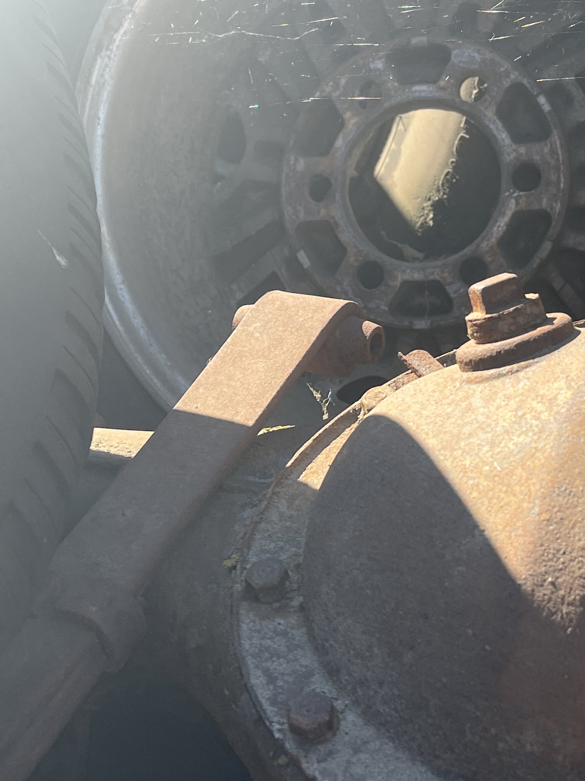

    image.jpg image.jpg Here’s mine

    You may have just solved this for me...for some reason I thought it was riveted...I have this old trailer sitting around with a set of 1 3/4 spring but the eyes are same front and rear...now to figure out if the length is similar and if the centre bolt comes out in the same spot as the old ones...thanks @Moriarity !

    I just went out back and spotted one rear spring like you show, I’m positive the other is in there somewhere.
    So you have options if nothing turns up or it’s too costly to have a set made.
    A question for the curious me, is your front spring(s) the same on the eye?

    No the front spring has both eyes conventional ....this is what I have kicking around on a trailer that's no longer roadworthy...if I flip the front mounts and get lucky on the centre bolt and length I have these Buick fronts (1 broken main) as well then between them I should have enough 1 3/4" leaves to make a spring pack

    Even if the spring brackets on your frame are riveted, the rivets can be drilled out and be replaced with grade 8 bolts. If you flip the bracket, you may have to drill new holes.
    I can tell you I would be going at this in a completely different direction.
    A 32 Desoto 2 door coupe weighed 2889 lbs (according to the Standard Catalog of Chrysler 1924 - 1990) from the factory (a 30/31 2 door coupe is 2630 lbs)
    Find a pair of parallel leaf springs made for a car near that weight range (length and width of the spring wouldn't matter) that is currently being produced as a spring kit, with mounting brackets and everything you need. At least that would be the direction I would go.
    Then I would determine where I wanted the center bolt on those leaf springs to be located so the rear axle was centered in the rear fender opening.
    Then, using the brackets included in the spring kit, I would install the brackets where they needed to be on the frame and remove the original brackets.
    The point is, the frame you have is for a 4 door sedan. Its pretty likely that the current location of the spring mounts for the rear axle on the frame will not place the rear axle in the proper position to work with the rear fenders on a coupe body. The coupe body is very likely to be a few inches shorter then the 4 door sedan body. If you are going to have to modify the spring mounting brackets on the frame, you might as well just mount new, wider spring brackets in the proper location and be done with it. Save yourself the added expensive of buying special order outdated parts.

    Yes indeed...I'm going to take advantage of that to move the cowl back...so where the rear tire ends up is going to determine where the wheel wells of the body will sit ...it has a hood so moving the body back will give a stretched look to the front fenders...I'll leave the headlight bar where it is and move the rad back...I think it will look cool
