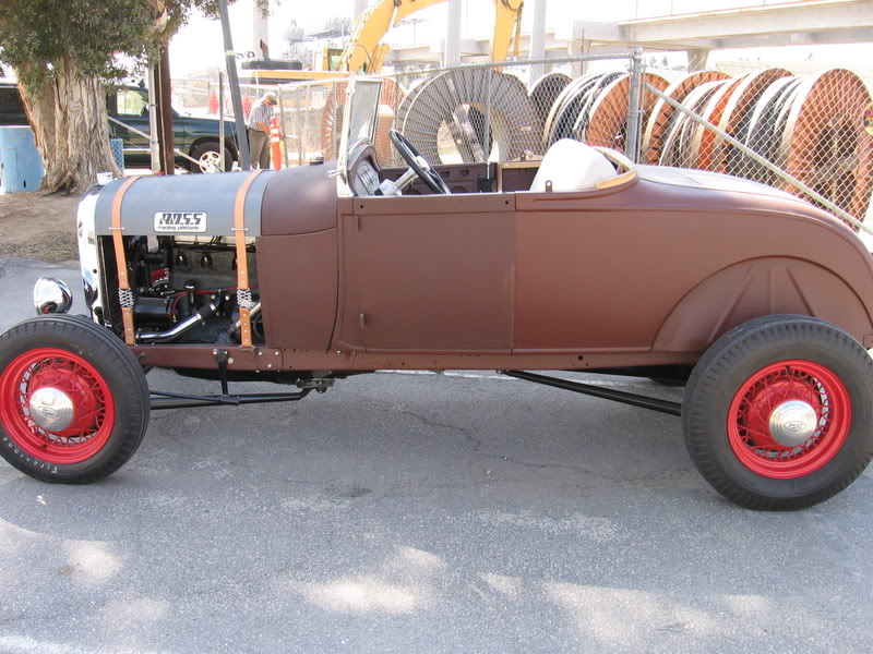

    No problem with the OP's set up, this is how it has been done and will continue to be done. My previous post explains it.
    kidcampbell71 and metal man like this.

    Listen to metal man, 09. The wishbone and draglink need to be not only parallel, but the same total length, including tierod ends or heim ends, whatever you are using.
  24. gimpyshotrods
    Joined: May 20, 2009
    Posts: 24,583
    gimpyshotrods
    Not true.
    If you were running a parallel 4-bar setup this would be true.
    With radius arms, or split bones, the drag link needs to be on a trajectory that intersects the pivot of the arm/bone, the longer the better, but not past.
    Ideally, the rear TRE on the drag link would be aligned with the arm/bone pivot.

    Take a good look at 117harv's pictures.
    That is the correct way of doing this, from and engineering standpoint.
