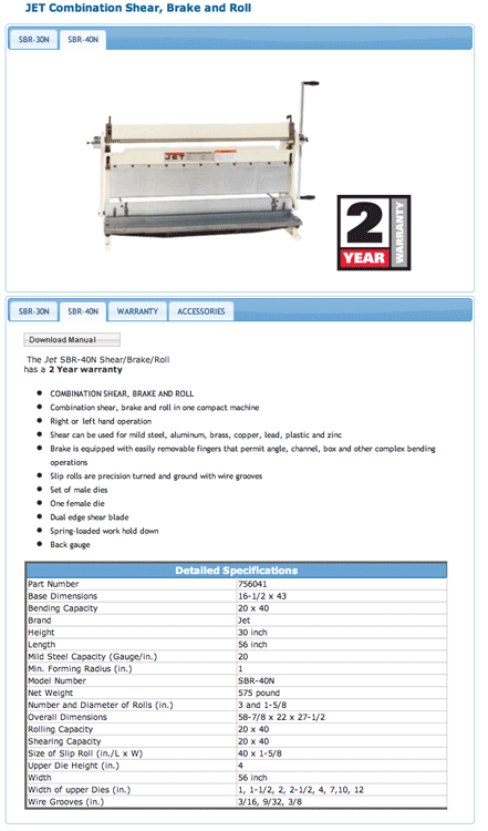

    1st looking at a 3-in-1 metal bend roll shear machine. Brands I looked at online are Baileah, Birmingham, JET, and Woodward Fab. Like the 30˝ to 40˝ models, most seem to be 20 gauge. Leaning towards the JET 30˝ model as it comes with a set of female/male dies, has multiple wire grooves, and a 2 yr warranty - all options that the other brands don't offer for about the same price as their 40˝ models. Or I could go with a 40˝ model of the other brands but not have the options/warranty. (JET has a 40˝ model, but it's almost double the cost of the other brands)
    As a starter, I just want to do floor pans, braces, brackets and metal boxes sort of work. Don't want to buy something that's cheap or known to break. With all of the metal work here on the HAMB, surely someone has some advise as to what to look for, options, or brands that are good/bad?

  2. in my opinion those 3-in-1 tools don't do any of them well
  3. 20 Ga. isn't enough. I wouldn't buy anything that wasn't rated for 18 Ga minimum. After my torch, my most used tools are, Beverly style shear, shrinker stretcher, and bead roller. I have and use my two slip rolls a lot, but that type of bend is pretty easy to do with other methods.

  5. Thanks, the 3-in-1 seemed appealing because it saved shop space and more bang fort the buck, but if they aren't worth a crap... I need other options
    That was my first opinion on the 20 Ga., as I use 18 Ga. on floors. Models that go up to 16 Ga. sure jump up in price though...:(
    Yes, primarily those are the two items I need the most. Mostly a pan & brake. Never used a slip roller, would be nice to experiment with one and see what I could learn to do. Don't see me buying one separately just to experiment and learn, which is why the 3-in-1 was appealing.

    Bear in mind that a 4' brake like mine that is rated 16, is a real tough job bending a 4' wide bend on the 16. So, if you bought a 30" 20ga, it might have a tough time with the 20 ga if you bent a 30" piece.

    Used American made stuff is always the way to go...use common sense, try it first, and you will have something for the rest of your life. Remember you can make a small part on a big machine, but a big part is impossible on a small one. This stuff is always around once you learn the ropes. ( Never saw a 3 in 1 machine that wasn't broken.)
