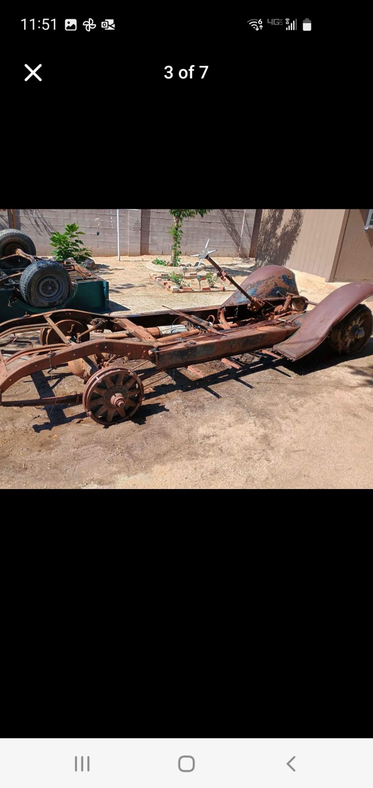

    First piece I'm looking at, ch***is. I have come across a early 1920s Buick ch***is. It's large. Anyone know these ch***is and believe that it can handle the weight, torque, etc, of a future aero engine to come.

  8. Here's the Buick ch***is

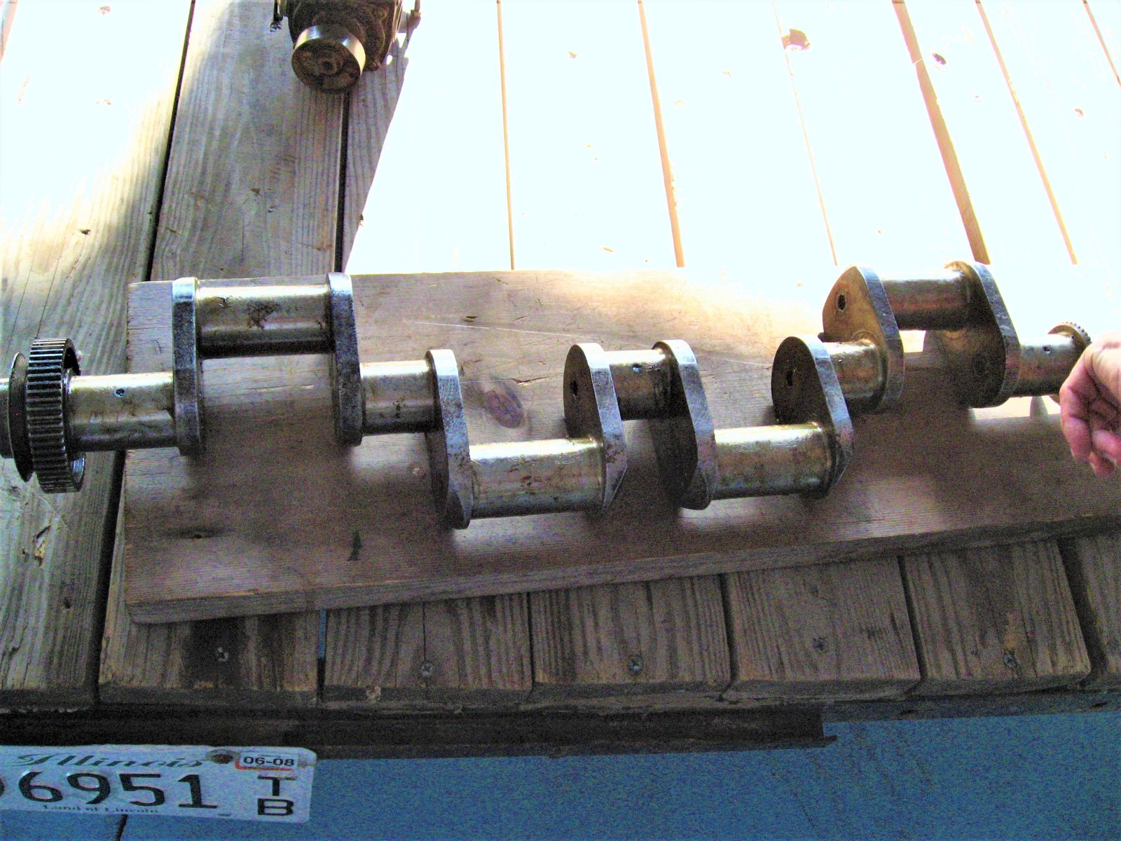

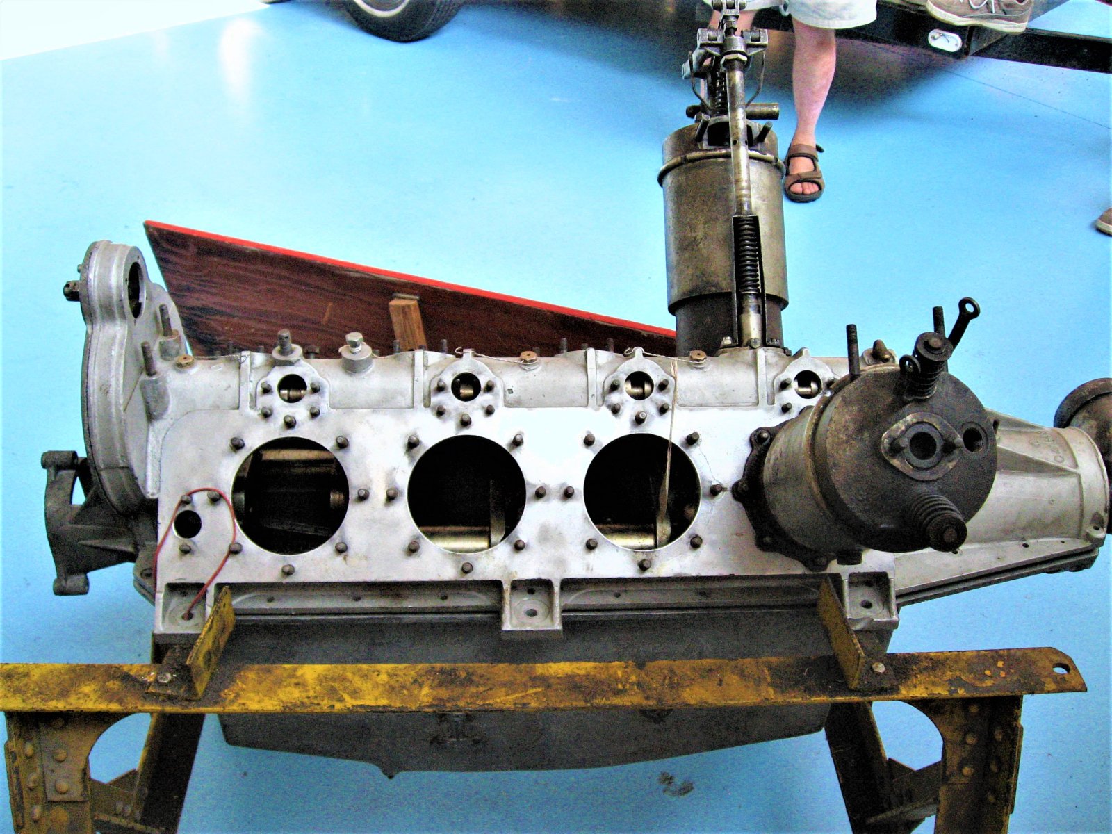

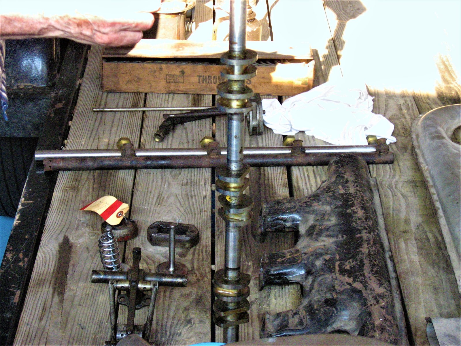

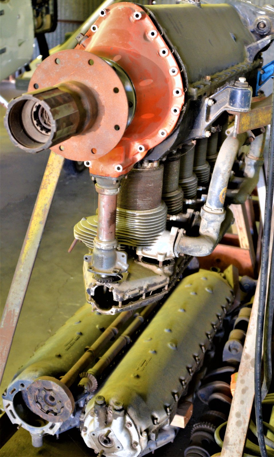

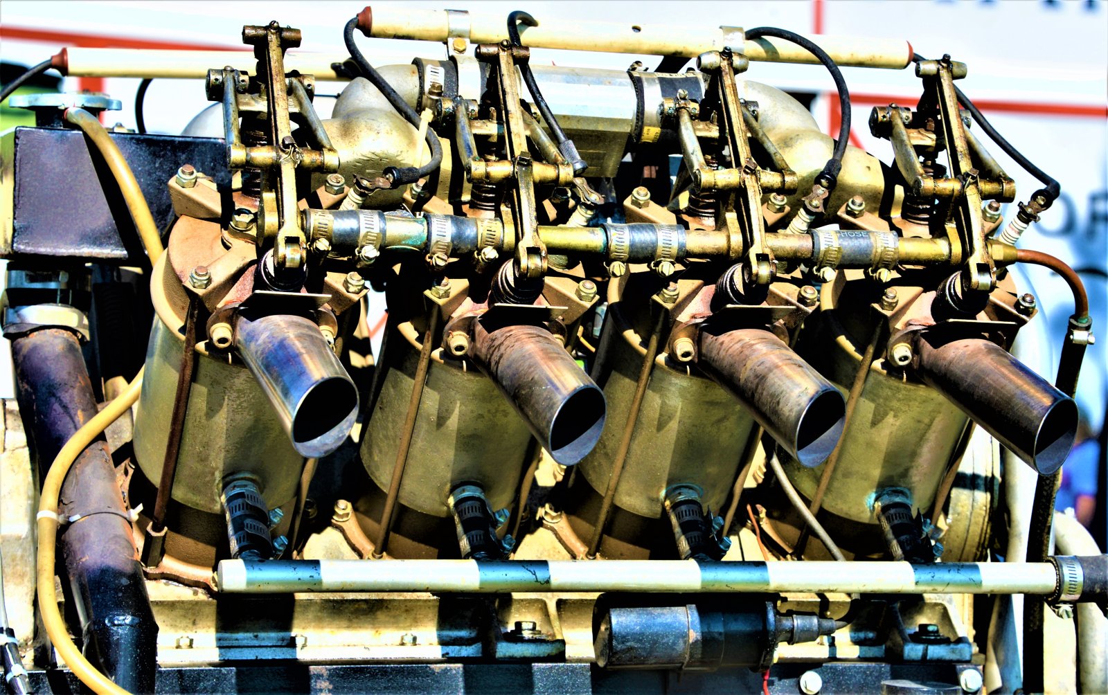

    When you get into post WW1 aircraft engines, well lets just say that its a cl*** of engines, at this point in time, that are rare and exotic, and not easy to deal with nor adapt to a practical drive train, but don't let that discourage you, it is possible, you just have to know what to look for.
    I will give a couple of examples here that will be interesting to you.

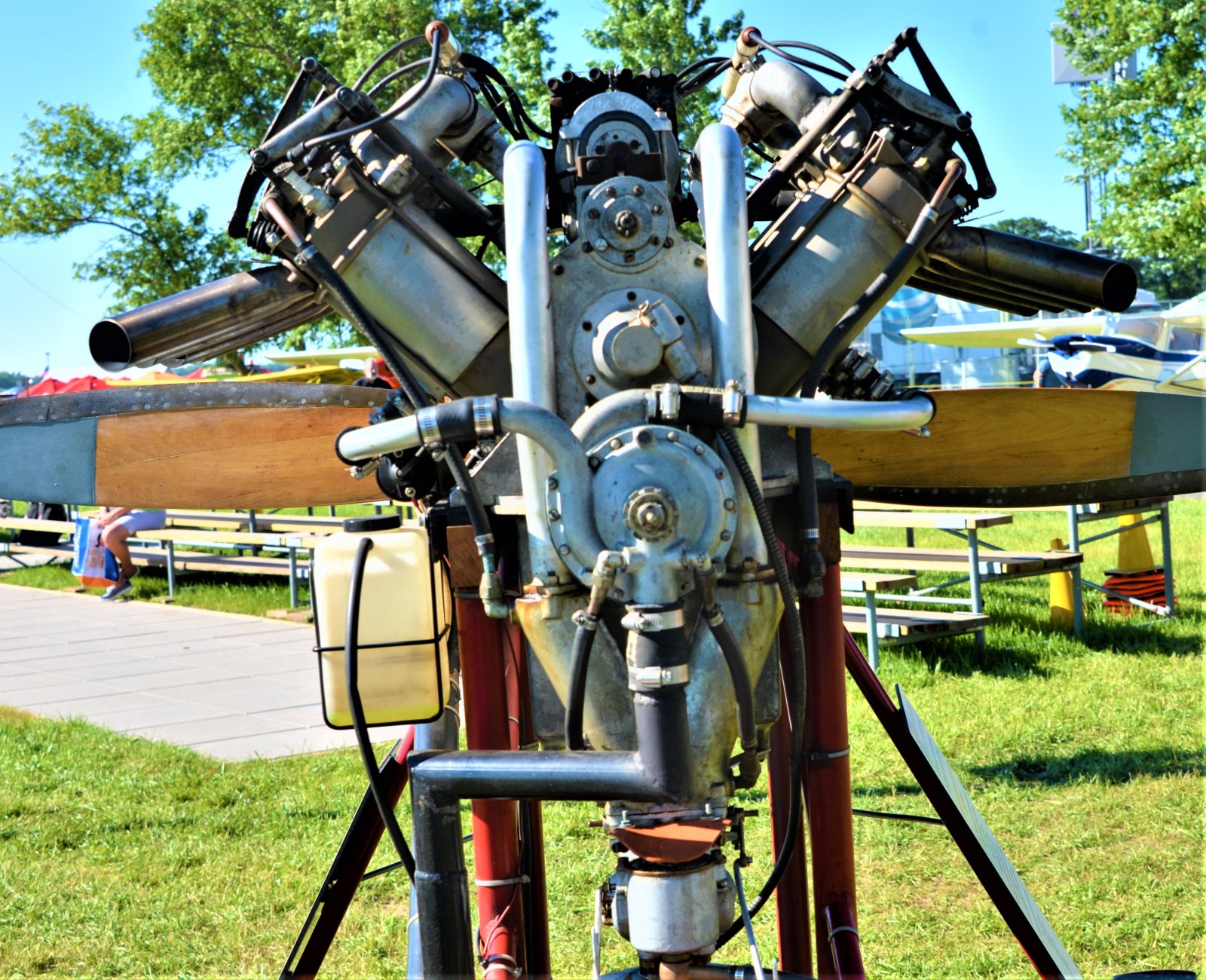

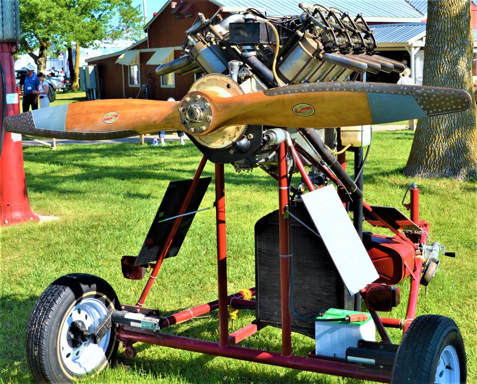

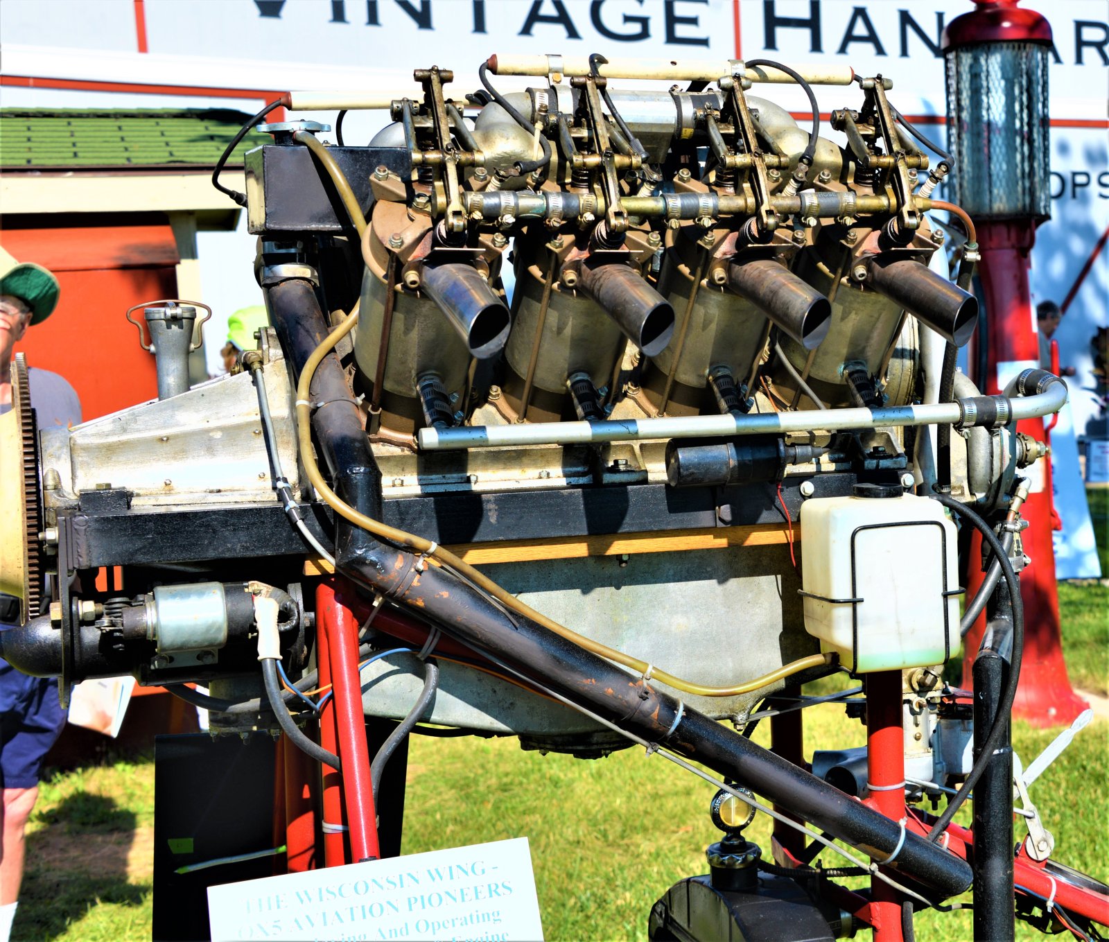

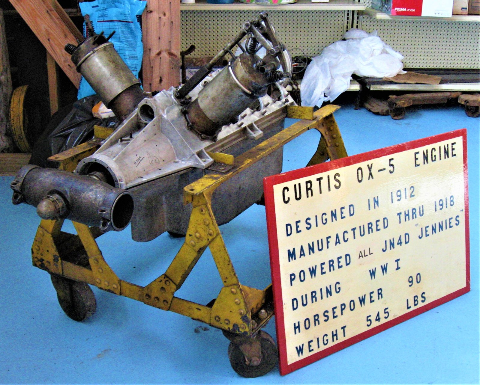

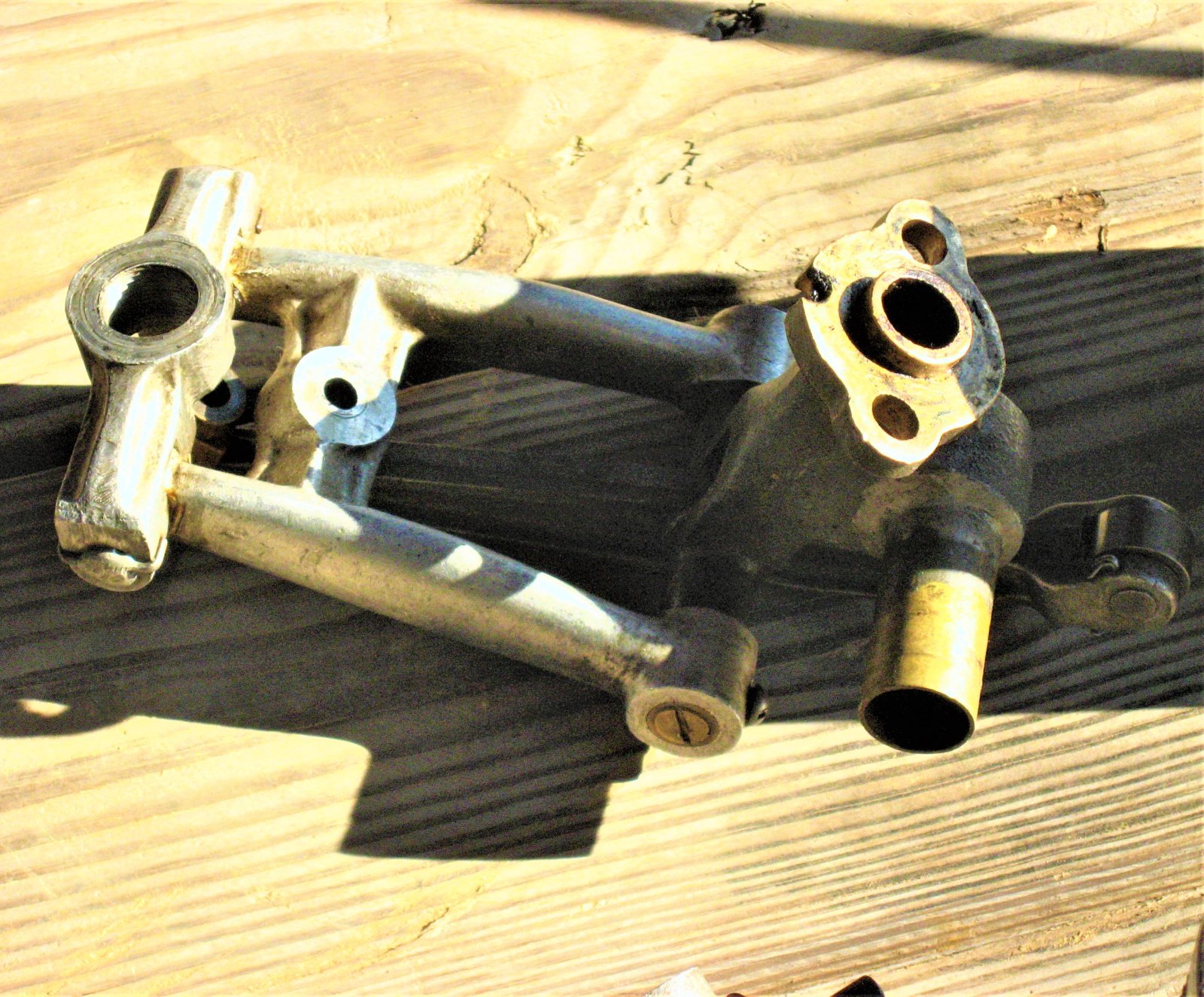

    The Curtiss OX-5, has a few quirks about it that makes it tricky to adapt to what ever custom clutch set up you are thinking about, that is because the shaft for the propeller hub is at the front of the engine and not at the rear, for obvious reasons. ( yeah I know, the engine can be turned around )
    You really have to get extremely creative to engineer a bell housing to maybe adapt to that area of the engine. DSC_2761 (2).JPG DSC_2762 (2).JPG

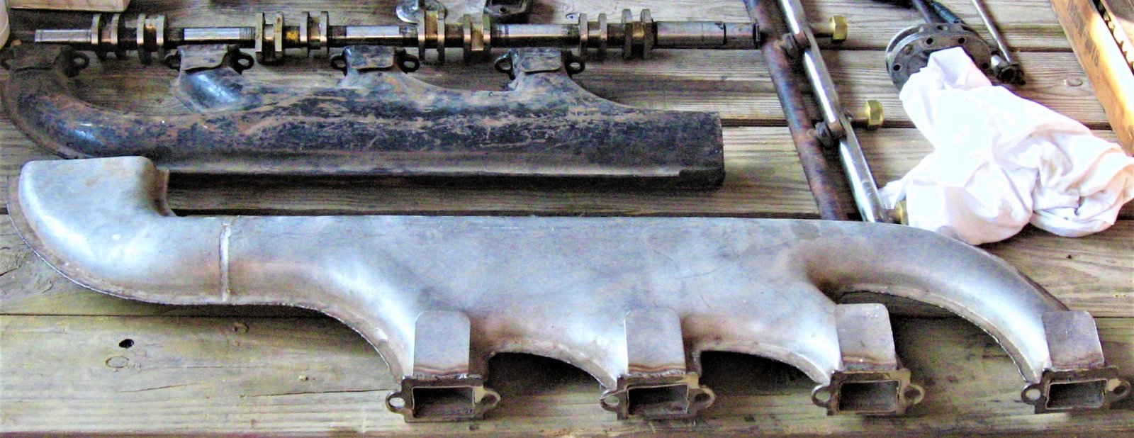

    The OX-5 is water cooled, and the water jackets are not the best engineered, for what your potential project might evolve into, but you will figure that out pretty quickly if you go that route.
    The valve train is all open and has to be greased by hand, and bare in mind, that this isn't a high RPM engine, and parts for these are getting exceedingly more hard to find, so bring a bucket of money to start with.
    These shots of a friend's OX-5, these pictures will give you a bit of an insight as to how exotic these engines were, for the time period they were being used, definitely not for a rookie to start with.
    IMG_1651 (2).JPG IMG_1652 (2).JPG IMG_1653 (2).JPG IMG_1656 (2).JPG IMG_1657 (2).JPG IMG_1658 (2).JPG IMG_1659 (2).JPG IMG_1662 (2).JPG IMG_1665 (2).JPG

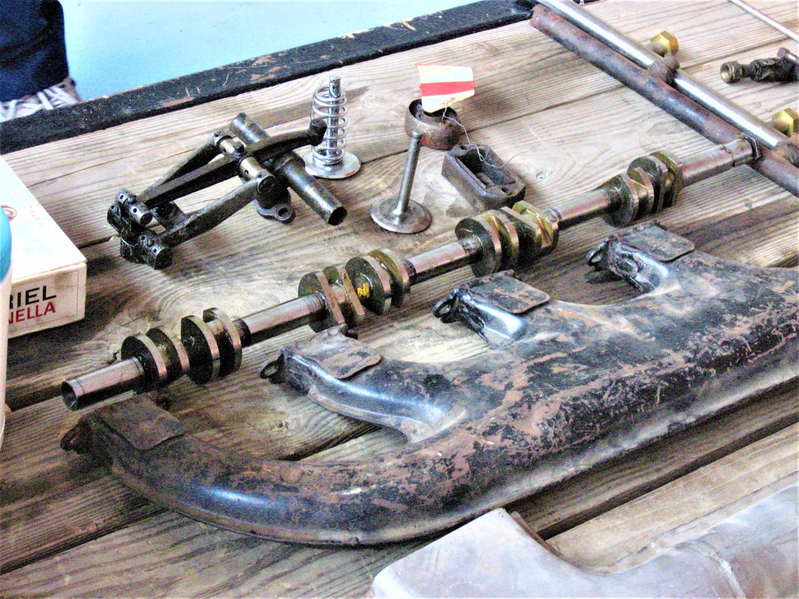

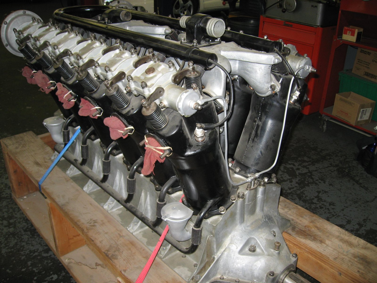

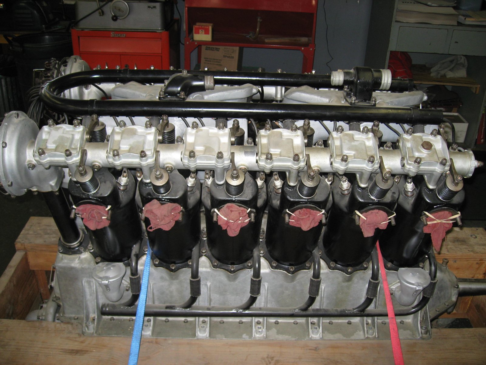

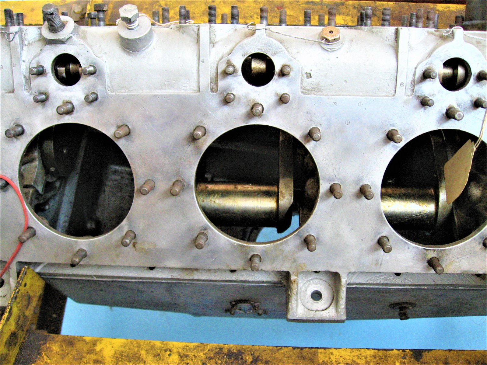

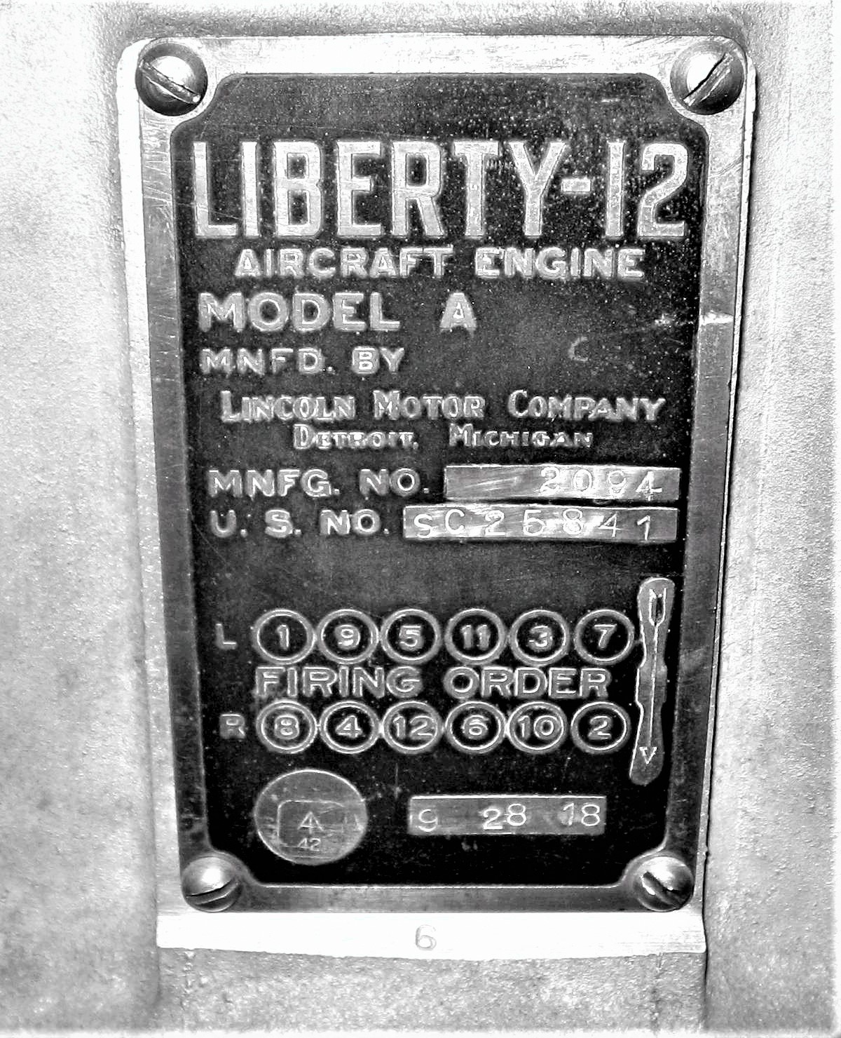

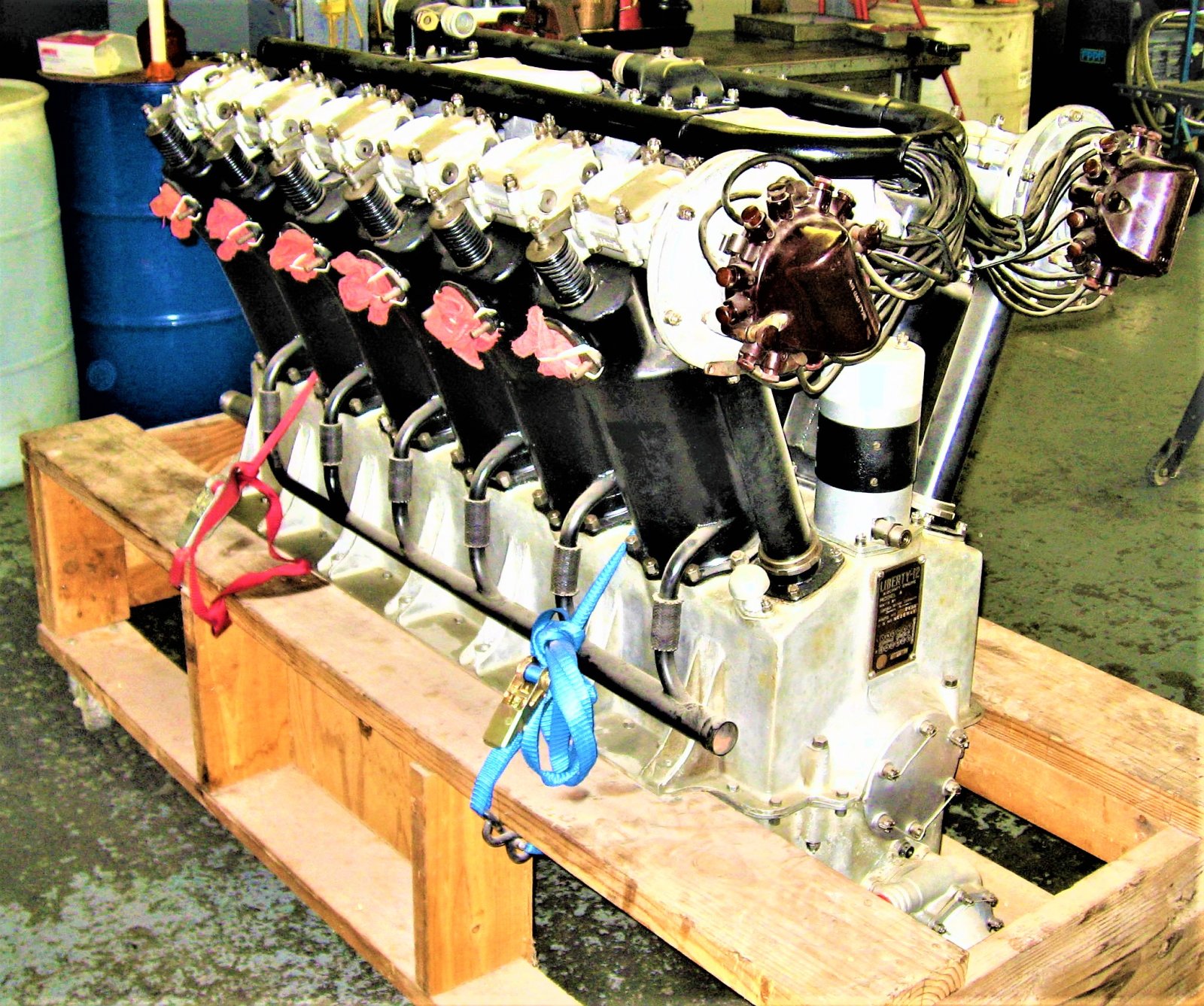

    Fair warning about the venerable V-12 Liberty engines from the time period of WW-1, these are very cool, but make no mistake, this is ancient technology, and again, the aviation crowd, for the most part, snapped these up long ago, and you don't see that many of them, that are actually being used on an aircraft, it takes leather balls to play rugby, and nerves of steel to actually entrust yourself to fly in a Liberty V-12 powered aircraft, just sayin.
    As you can see, its back to all open valve train, that has to be greased by hand. and again, the water jackets for cooling, can be a real pain in the *** to maintain and to repair if needed, there are not that many of us geezers left around, that can truly work on these, with any true degree of expertise.
    Just sayin.

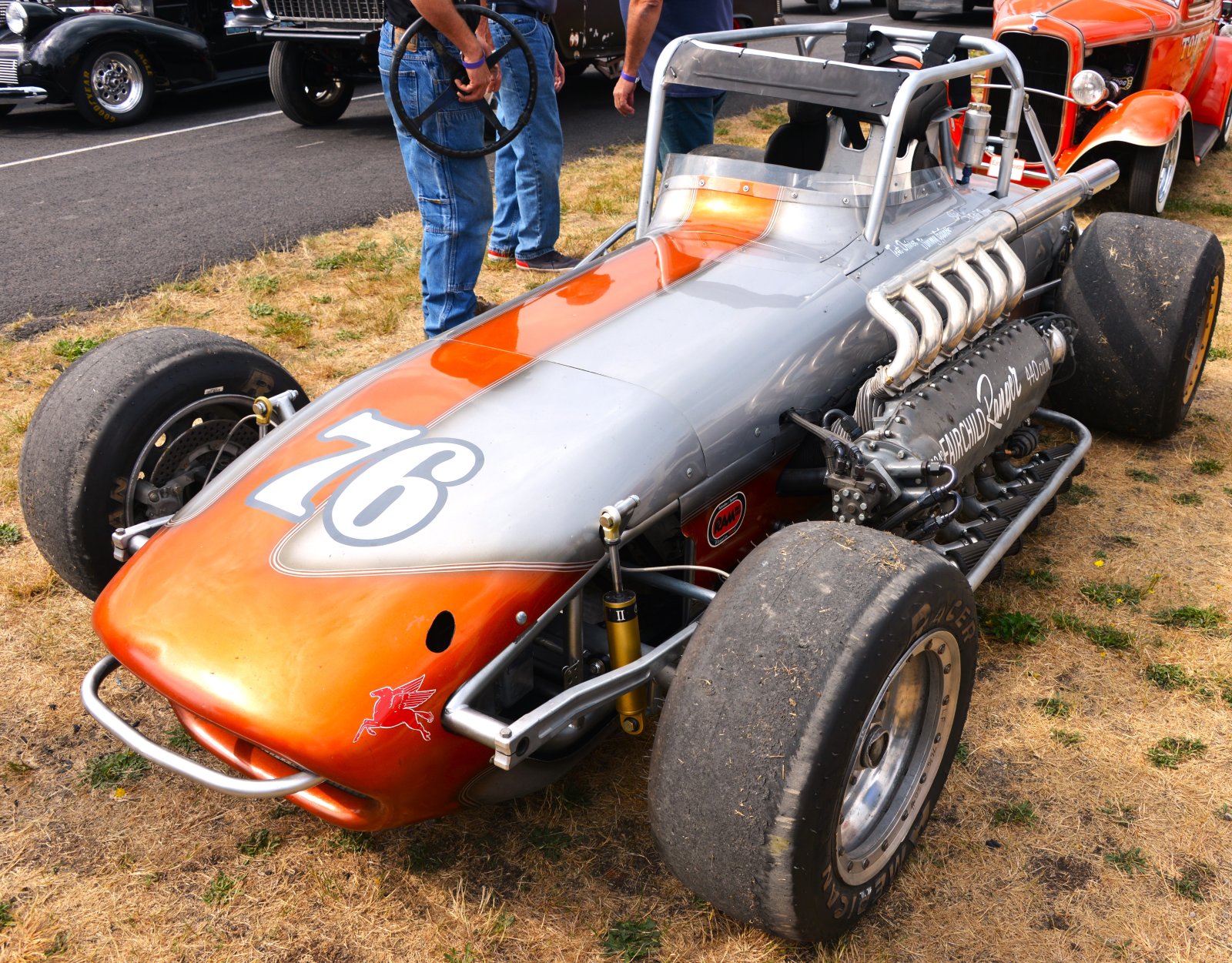

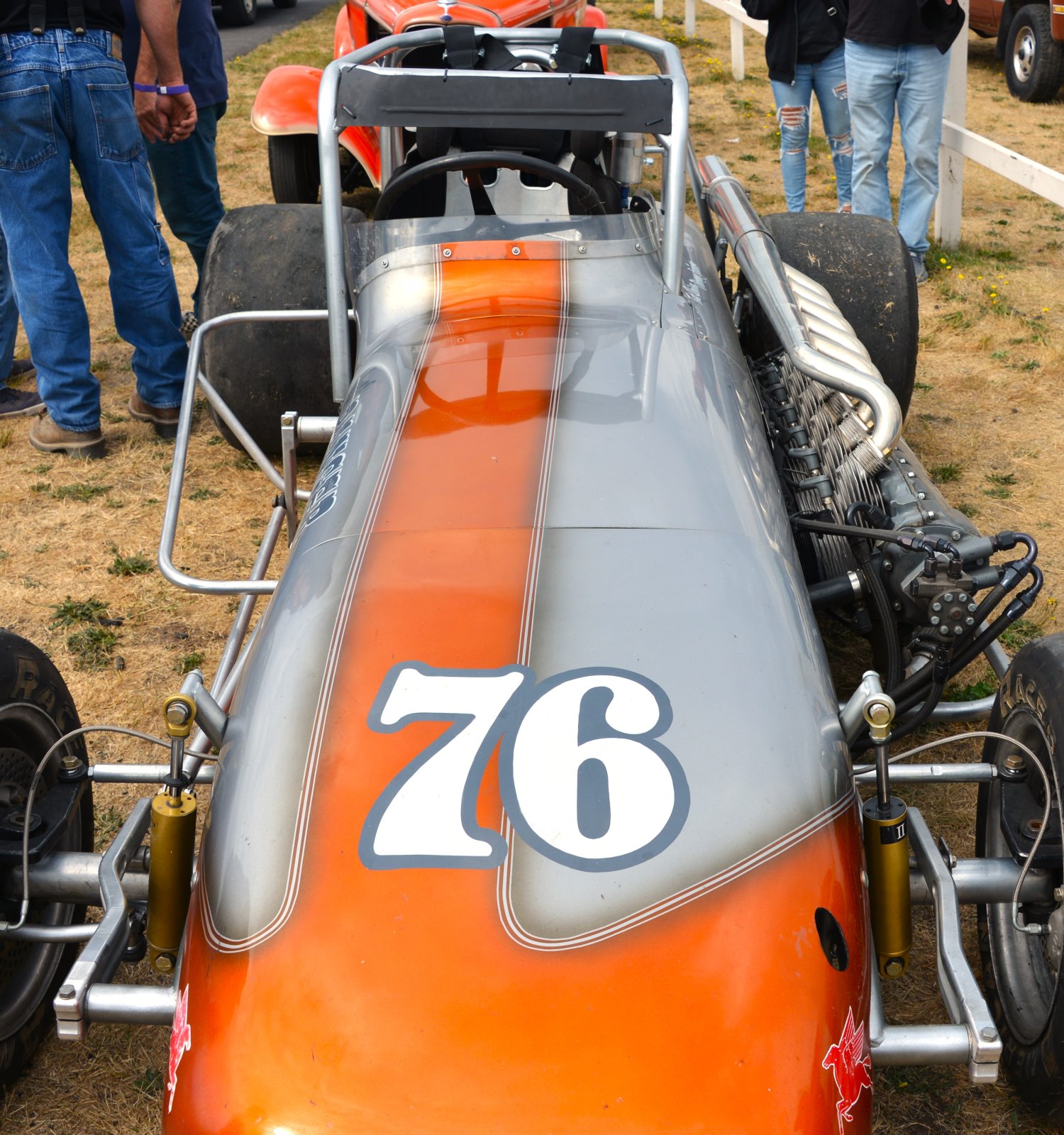

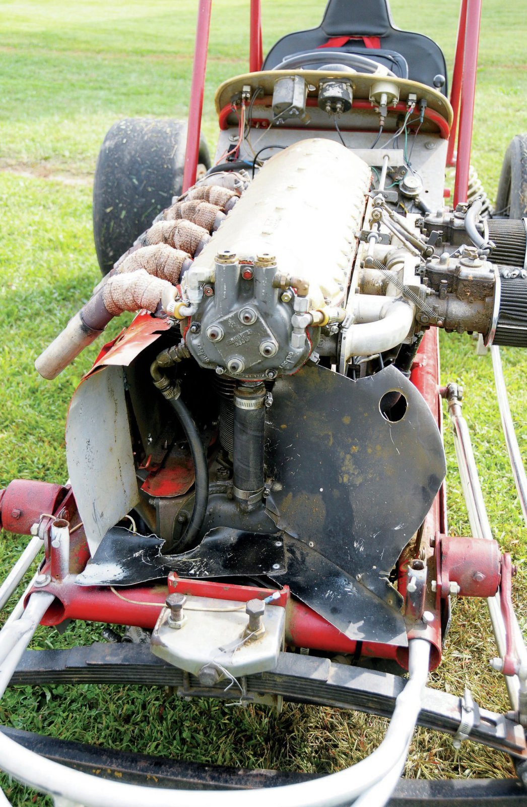

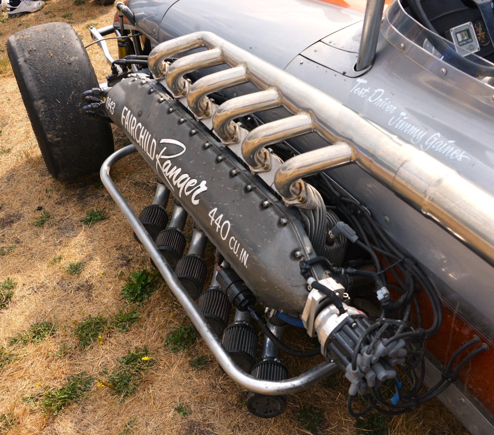

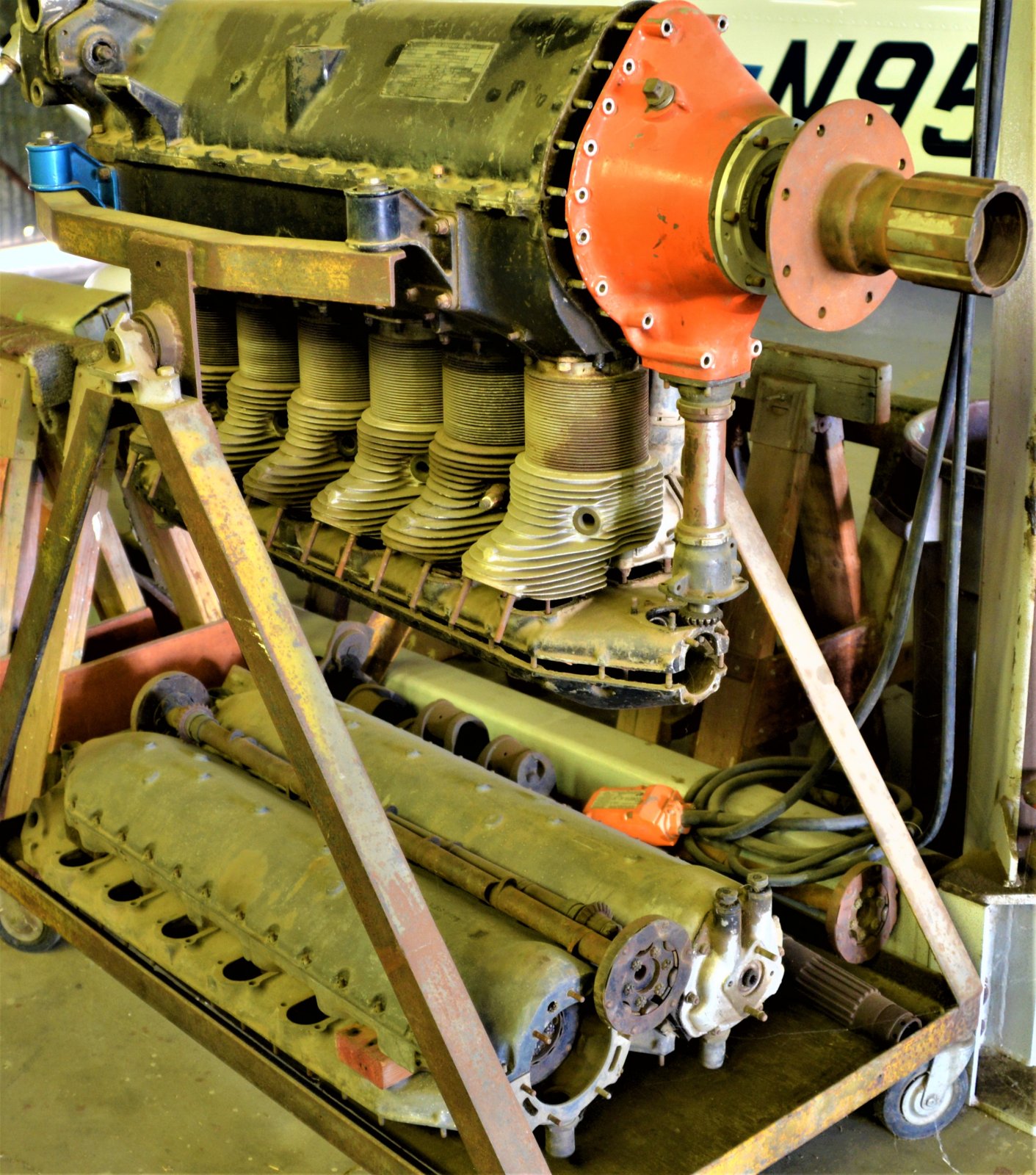

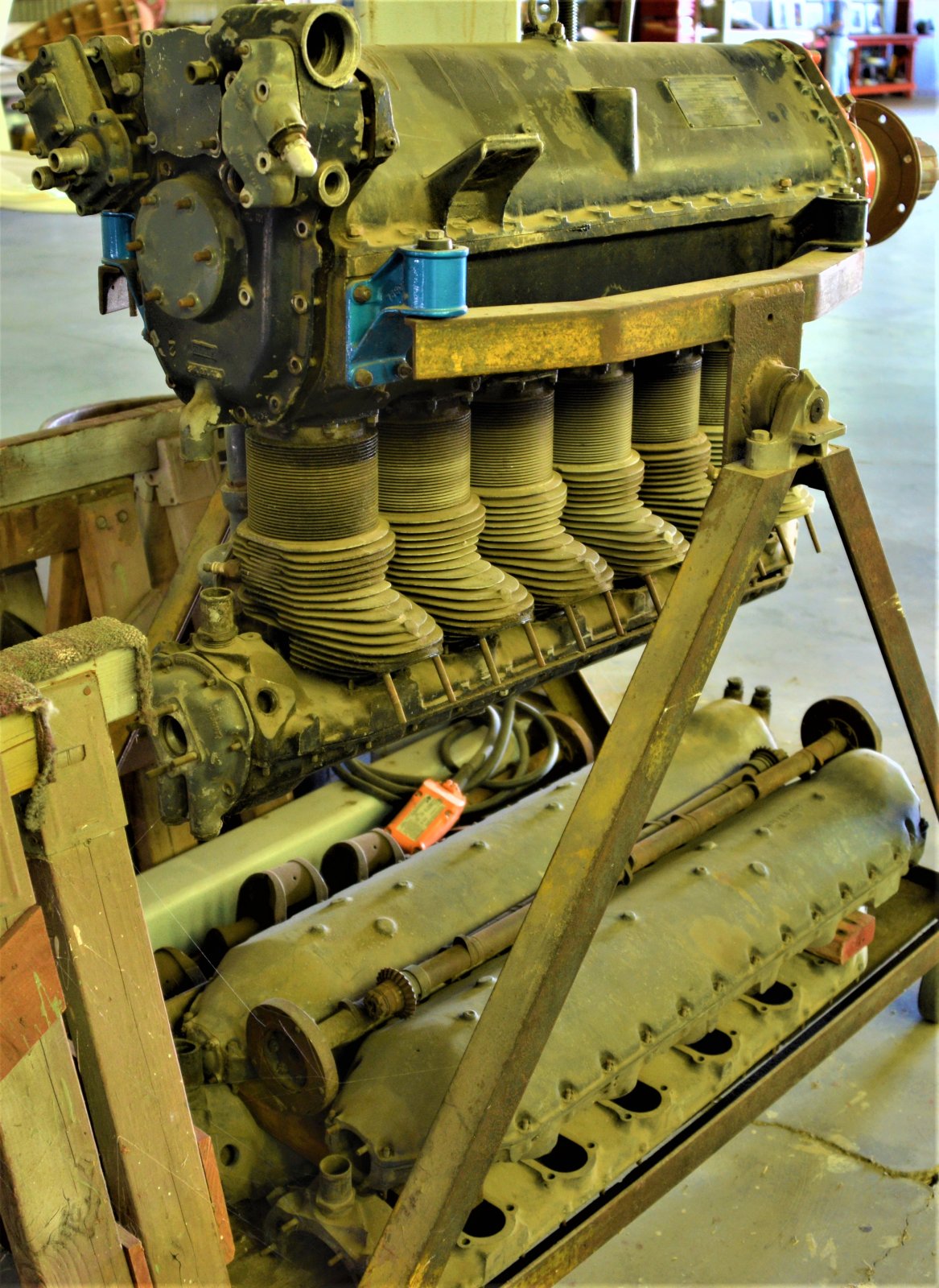

    You might want to consider going the route of the very cool Fairchild Ranger, inline 6 banger, which when it was in the aircraft, it was inverted, and they were adapted to be used in sprint cars, and they were powerful.
    These were modified to be on their side, and were used in various sprint race cars such as this one.
    So don't let any of what I have posted here, discourage you in any way shape or form, just be aware, the bucket of money, and connection to older geezers that are master machinist, that savvy these rare, cool engines, are very much wise elements, that you will need, to help you adapt vintage aircraft engines, to what ever rolling ch***is you decide on.

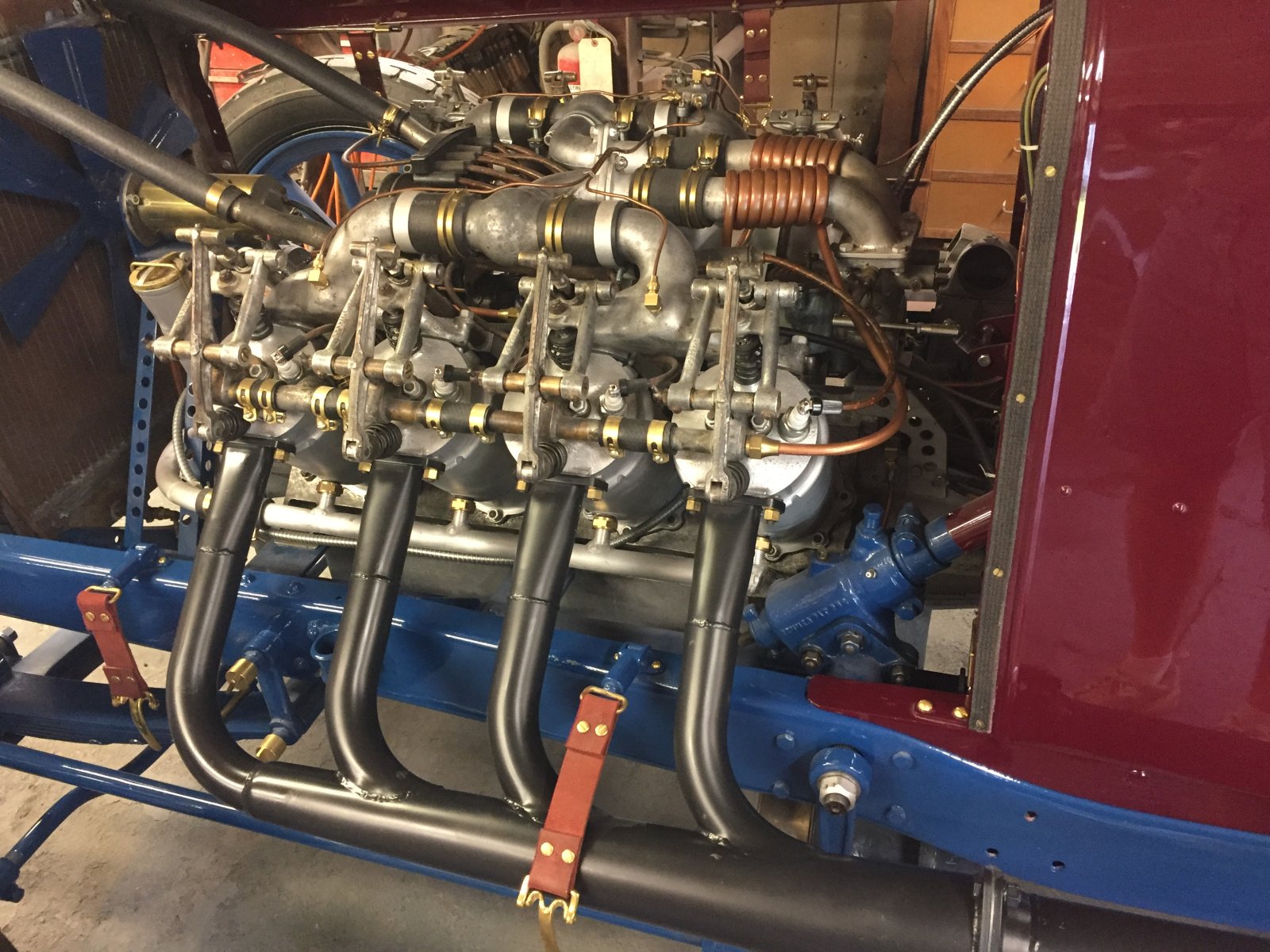

    We've got a couple of Aero Engine builds happening at work, 1 is an OX5 in a 1913 Wolsley the other 10L Hall Scott in a 1914 Sunbeam TT replicar
    Both engines are WWI era engines, in my opinion the cars look best if they are built in a similar period to the engine,
    If you want to take the easy route I can arrange to send this OX-5 powered speedster your way…..
    HarryT, 40 Olds, Stooge and 3 others like this.

    Hey @uncle buck !
    That last picture, has very impressive detail of fuel lines and copper tubing forming, I would have liked to have seen some pictures of the undercarriage and details of the clutch apparatus!
    Thanks from Dennis for sharing those great photographs.

    The car belongs to and was built by a close friend of mine with the help of another friend who is an amazing machinist. It’s got a divorced transmission and a complicated cone clutch with a whole lot of machining to adapt a flywheel to the tapered crankshaft. I don’t think I have any pictures of it on my phone and the car is currently in storage

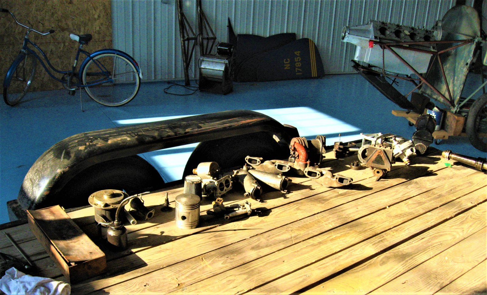

    One year at Hershey a friend showed up in the old White field (former Hershey Airport) with a pile of parts he had cleaned out of a garage. He was clueless as to what he had there an OX-5 that was totally dis***embled. I often wonder if someone got all the bits and put it together.
