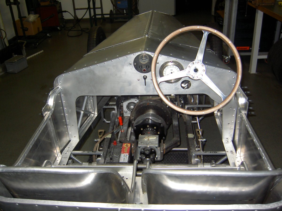

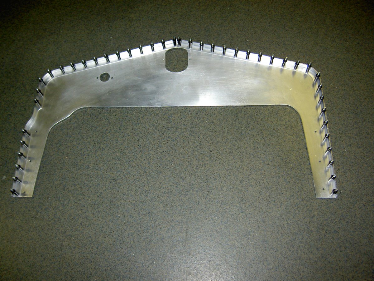

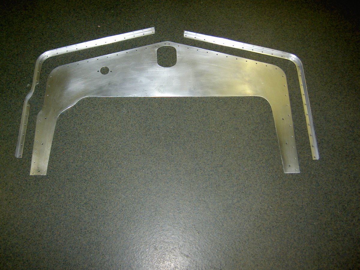

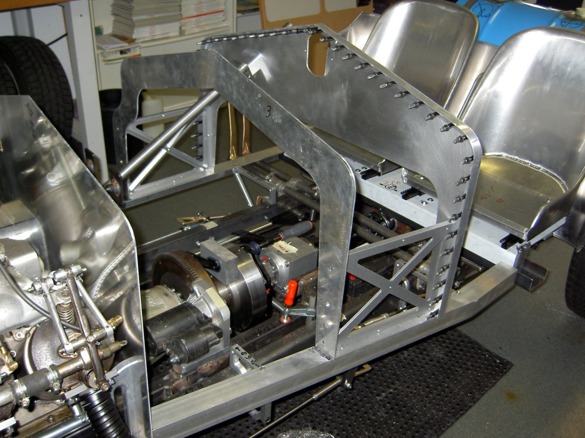

    The dashboard is ready for riveting 44364E77-355D-48C5-9F00-90D2E91BE896.jpeg 9E26CE32-131B-47E6-9203-5E4524B83C48.jpeg 0264706C-C97D-428F-BB77-69343A18666D.jpeg

    Hello, Rolf!
    Excellent development of your magnificent project!
    Is all that made of aluminium or steel?
    The technique looks the same as for the fuselages of vintage aeroplanes and their modern replicas - quite in a style of the entire concept of your Fraser-Nash aero-monster!
    Good luck with the following steps of the project and please inform us with text and photos...

    All is made of aluminium also the connection parts to the ch***is.The connection parts are made on a CNC milling machine and afterwords very rough sandblastet to get a look like casting.

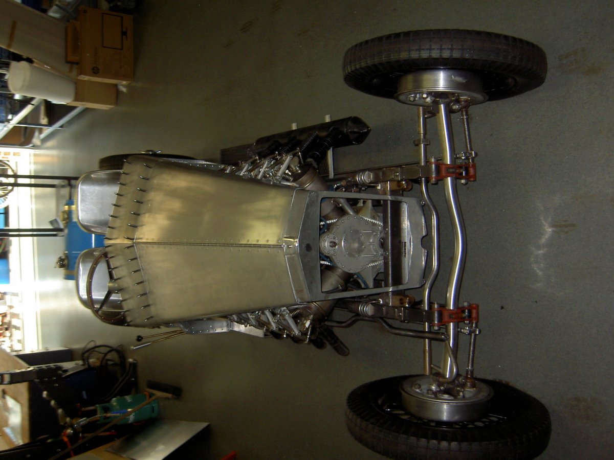

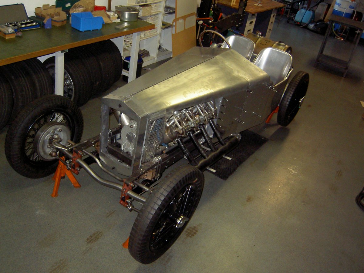

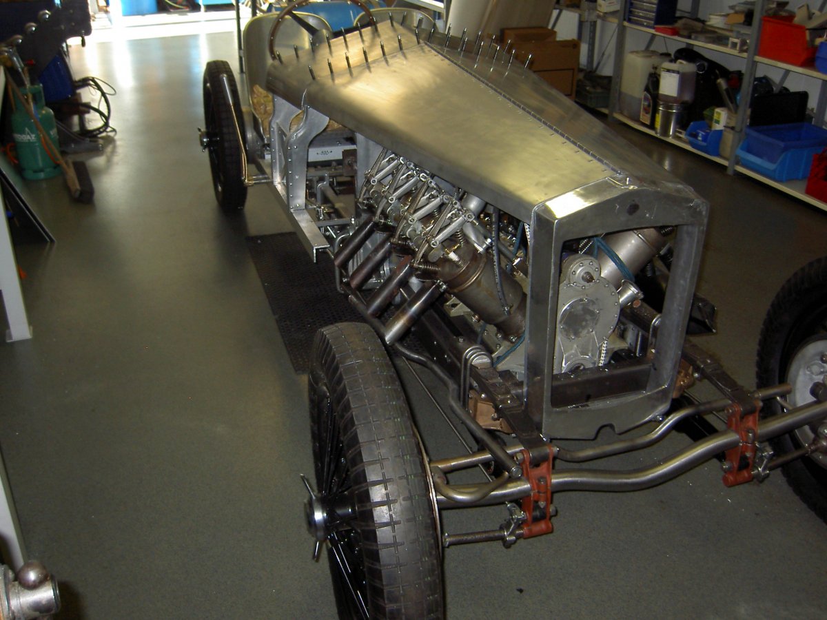

    Hood made from Peraluman half hard 1.5mm EE598816-FA2D-4FFA-A79E-7FE0940E0E5D.jpeg 9B266A27-B083-4FD7-B192-B10BE7410C20.jpeg 2B2F490D-0DD5-4CE7-BEB8-12560EDAFBD8.jpeg 4BB73371-1455-45C8-B7E5-74B7611CA352.jpeg

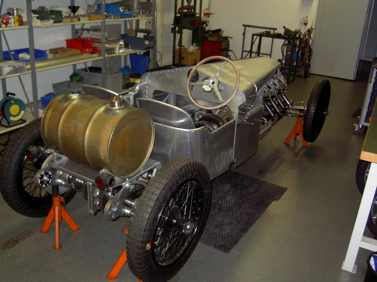

    Some pictures about the latest progress 19B52E7B-58A6-4D46-8A61-D27E02D1B45C.jpeg 2791FA83-8E2C-4437-BE92-7A2BCE9CB67E.jpeg 183AA357-1273-47FD-BDE4-328143DDF8F8.jpeg 13EFAFC0-6FB8-419C-97FE-90AEBA4BF615.jpeg 13EFAFC0-6FB8-419C-97FE-90AEBA4BF615.jpeg 1CB12D79-7A38-47B3-86BA-1D971EFB7C71.jpeg

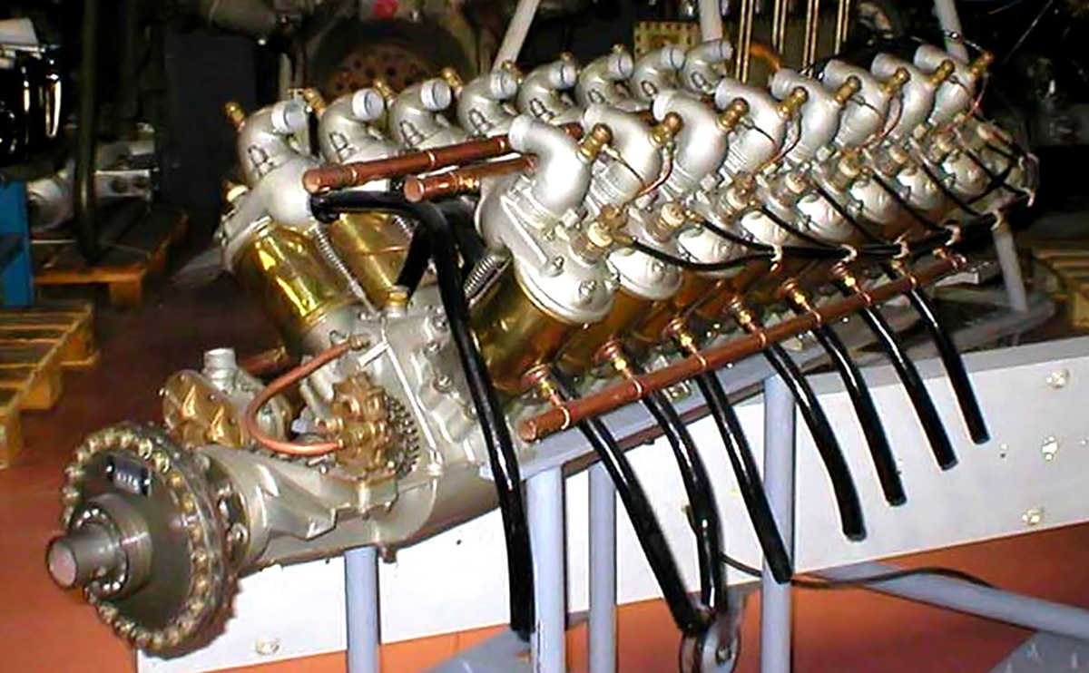

    Thank you, Rolf,
    For nice time spent this Sunday searching through magnificent Blastoland website, old and new, but Baron Margo's too! Some decades ago, I was dreaming about such magnificent but totally crazy machines. When some years ago I found mentioned websites, I became glad that I am not the only lunatic. Unfortunately, in my case, that is just as studying ****ography: just watching no taching (working).
    So, what to think about the biggest piston engined aircraft engine and its positioning in some biiiiig automobile? So, here it is - Gigantic 3393 Cubic Inch 800 Horse Power V-16 Duesenberg Engine (maybe, not for aircraft only?)...
    Quite interesting valve-mechanism: not quite OHC, but almost!
    Then, a few other of aero-engine monsters:
    A pair of big Bugatti's looks quite small compared to V-16 Duesenberg?

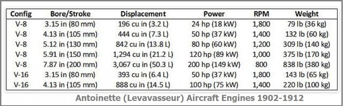

    Interesting text, but I am not sure why most of the texst is crossed? That part looks to me quite logical and true! It is interesting how early aircraft engines were light, opposite modern people thoughts... Even early aviation pioneers always complained how they do not have light enough engines - but, truth was that their aeroplanes were often too heavy and aerodynamically inefficient. There were a few smalle engines developed from motorcycle engines as Anzani, Buchet and JAP or bigger special made as Lev***eur' Antoinette. The first of his long range of similar engines were produced in 1902, long before the first successful aeroplanes. There are some facts about their size, power and weight:
    "Levav***eur’s first engine was running by the end of 1902, but efforts to improve the engine were undertaken throughout 1903. The engine was a V-8 with a 5.12 in (130 mm) bore and stroke. The engine’s total displacement was 842 cu in (13.8 L), and it produced 80 hp (60 kW). Initially, the engine weighed 346 lb (157 kg), but refinements brought the weight down to 320 lb (145 kg)."​
    Interesting table:
    Some of the presented engines were, even more, power/weight efficient, specially adapted for aeroplanes or dirigibles (most were built for speed-boat sport and racing). Note: engines were water-cooled! There were versions up to 24 cylinders, but mostly for boats (three V-8 connected).
    The most important reasons for low weight were careful designing and construction, but also low mechanical and thermodynamical stresses of the engines. Could anybody today make 15.5-litre engine weighting 100 kg?
    As I know Glenn Curtiss made V-8 engines were also relatively light, especially early engines used in record-breaking motorcycles.
