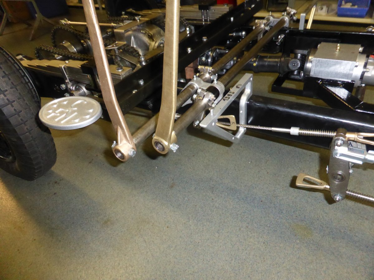

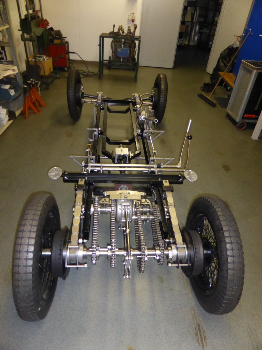

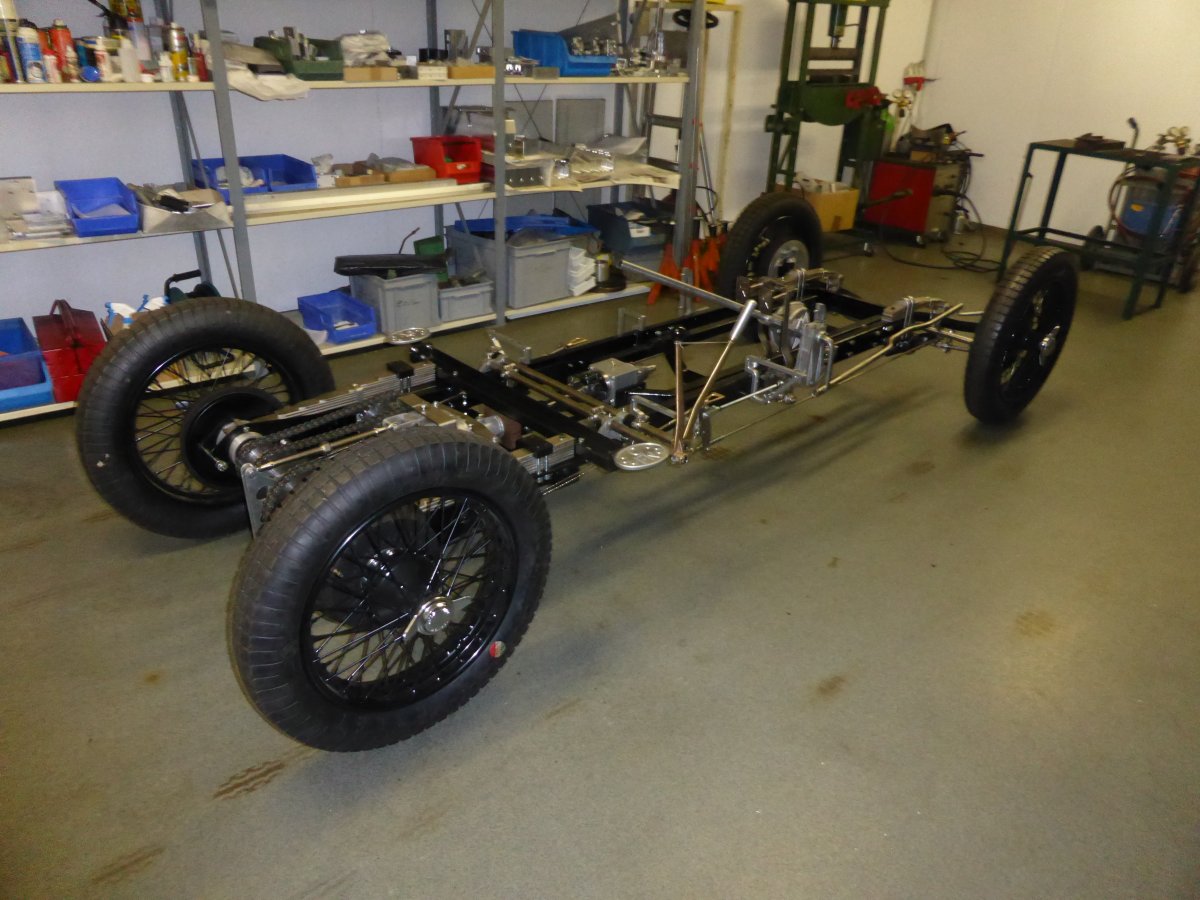

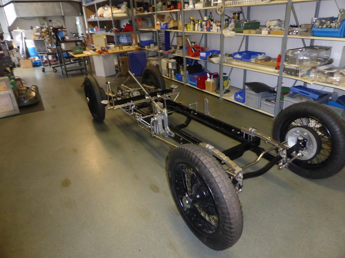

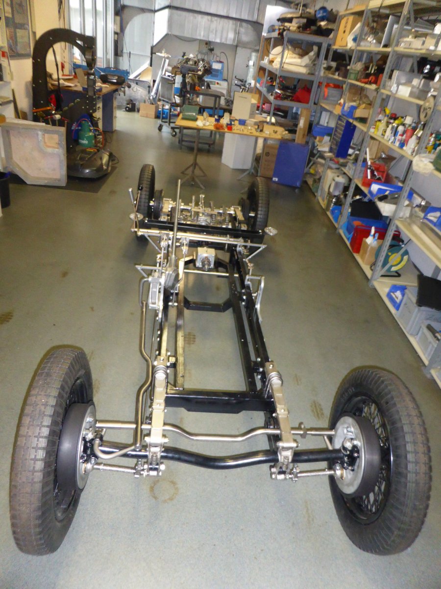

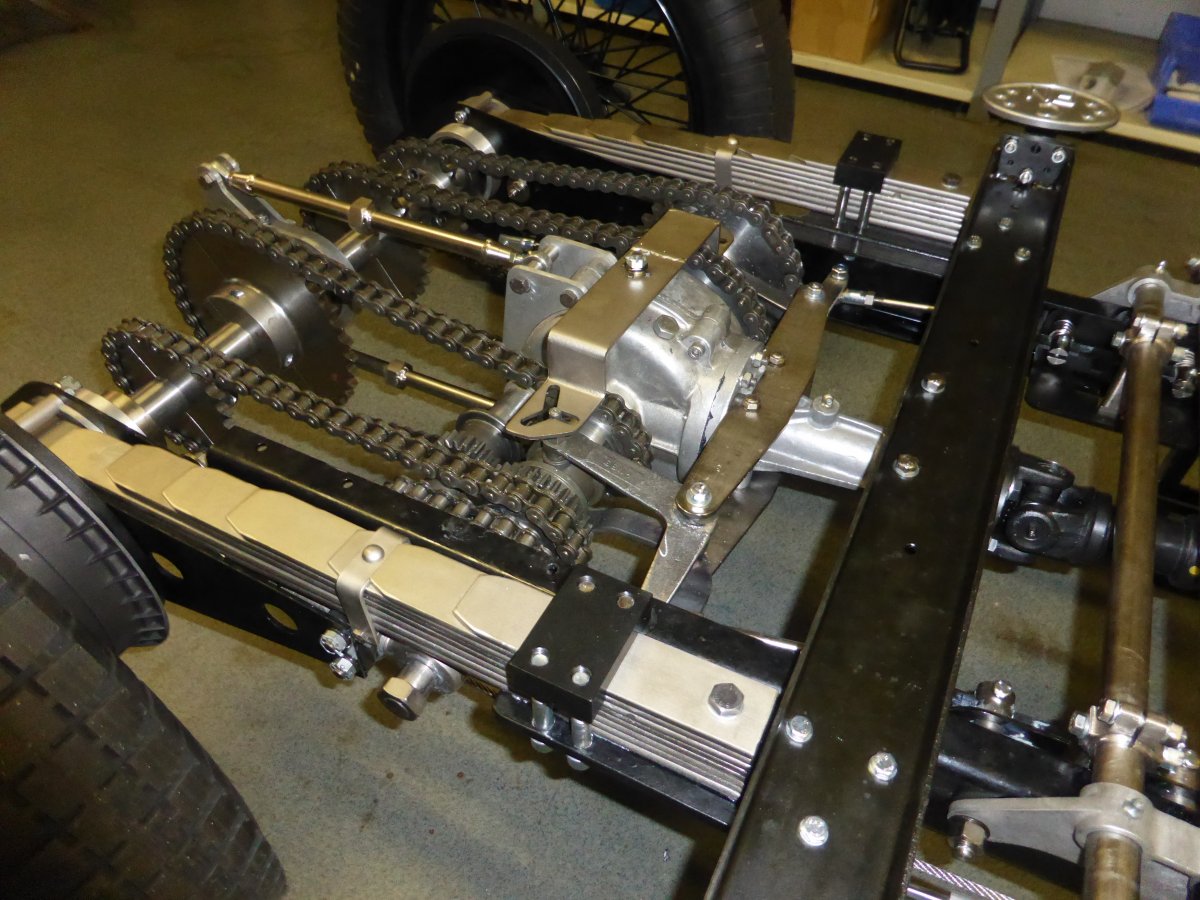

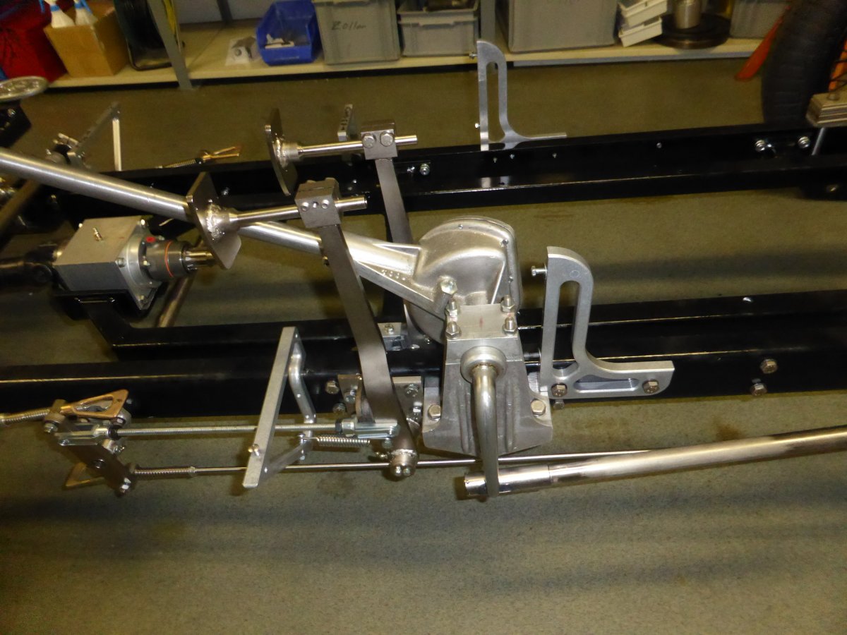

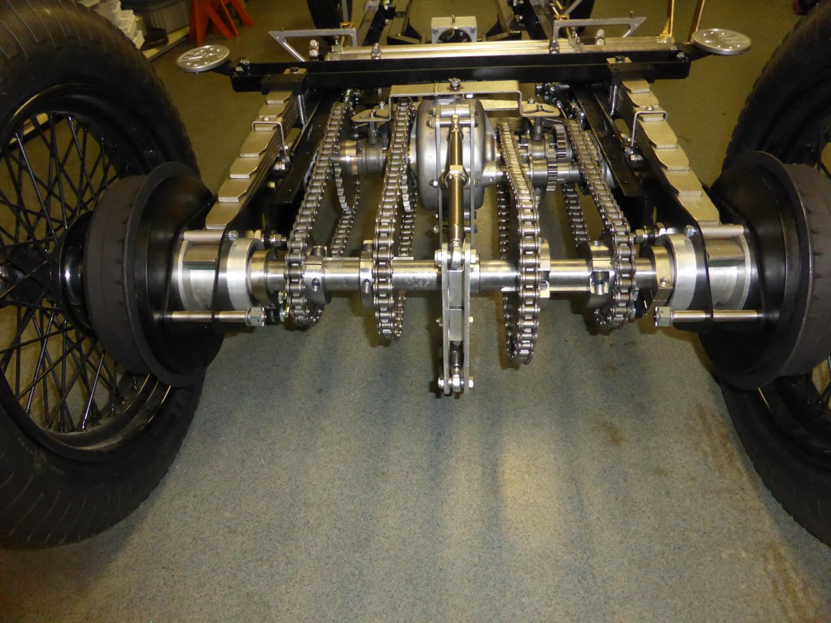

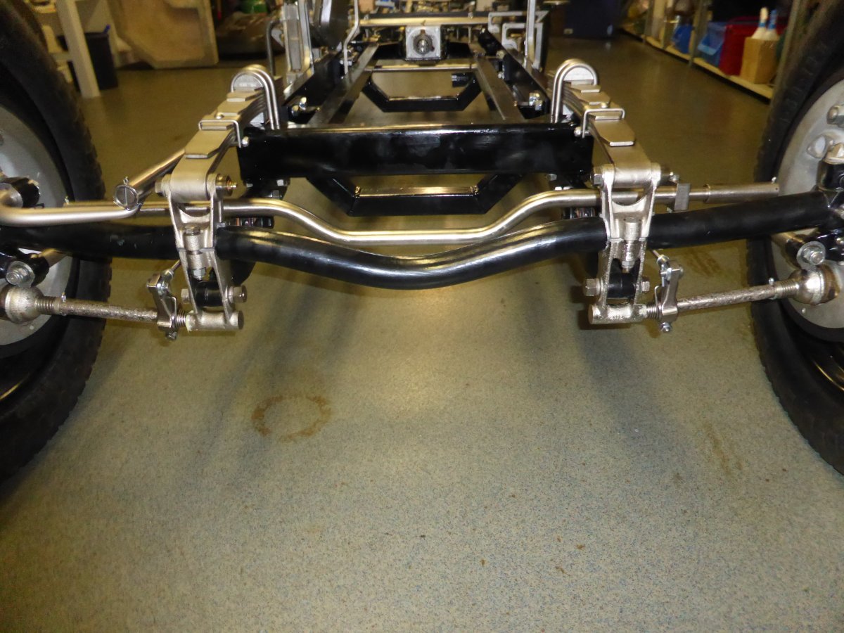

    59D3627A-94D0-4E80-82E7-E6FAE776DE0D.jpeg 13E434F6-84F1-4741-80D1-9F61AEA54C1D.jpeg 00922906-3F58-4A4D-836B-B80501841818.jpeg 26545AD8-559A-4C2D-8368-F0EADBF8540A.jpeg F6F8270B-9EA7-45CE-BFCC-1421739F8428.jpeg 2396916B-DFE4-4D63-8111-E27672420A9A.jpeg 9D702DB7-31CD-4E54-B4D1-9D9C39C7B885.jpeg C49B072F-8F2F-4CC4-B98C-5528277E8E4C.jpeg FA8EB12C-A228-4061-ABAC-4BC6E8D1D57F.jpeg 0D58AE51-2CF0-4646-8F97-80AE255517D8.jpeg
    The rolling ch***is is now complete finish.The next job will be to finish the engine and make it ready to install it.
    brEad, Ziggster, s.e.charles and 2 others like this.

    Hello, Rolf!
    Excellent photo-strip about rolling ch***is of your own designed and constructed Curtiss/Fraser-Nash.
    Nice view to entire ch***is, suspension, brakes, transmission - in general, and in details!
    All the best for the next stage: testing of running ch***is and finally with body attached!

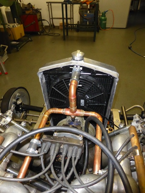

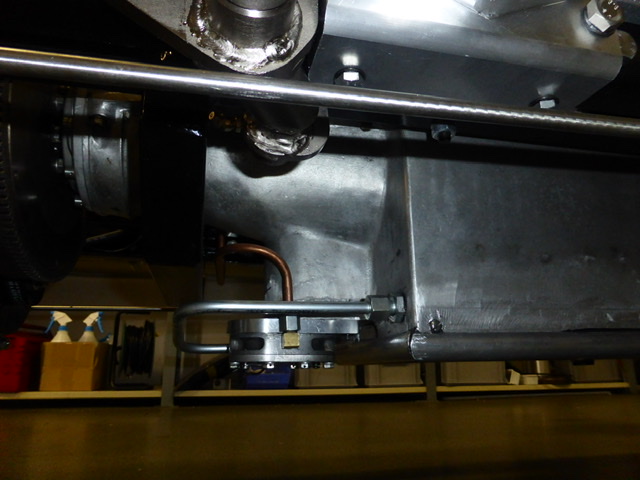

    Some new pictures from the project 84B178B2-611C-49D0-A0CC-13E63BD6A22F.jpeg 59469113-1AE3-4513-BB2E-8F163A163350.jpeg C36E76C2-2043-44FB-94EC-1FA79D3BC4FD.jpeg EAF2B5B8-0FF9-4DEA-980B-D8E45052C737.jpeg CCE386E2-EEAB-40BD-9740-30DCCC1267E6.jpeg C36E76C2-2043-44FB-94EC-1FA79D3BC4FD.jpeg EAF2B5B8-0FF9-4DEA-980B-D8E45052C737.jpeg CCE386E2-EEAB-40BD-9740-30DCCC1267E6.jpeg F7FBF270-4193-438B-A5AD-DEA1CFFFBF6B.jpeg A7065989-AE86-4786-941A-02C84EF7FCC7.jpeg FF946DFB-BDB5-4C51-A4A5-3EFE6F7F08C7.jpeg

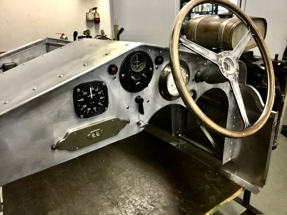

    The dashboard is finish and ready for wiring 99C1010F-9A97-41C4-A693-4E5DFE5121D3.jpeg F910EC3E-D902-46C6-8971-3A0A9D5095B4.jpeg 582FE0AB-AB03-430C-AD8B-26DA909D46BA.jpeg E47FFEB9-ADE8-471E-AA21-DF0D40362835.jpeg E9E3C889-9521-4812-9F6E-21B56A0619E2.jpeg
  23. studebakerjoe
    Joined: Jul 7, 2015
    Posts: 1,177
    studebakerjoe
    Rolf, is that a Malp***i filter/regulator I see on the firewall? Beautiful work on this car. Can't wait to see it completed. Be safe.
    Joe
  24. Rolfzoller
    Joined: Apr 30, 2014
    Posts: 400
    Rolfzoller
    Yes that is a Malp***i 67 mm Filter King.

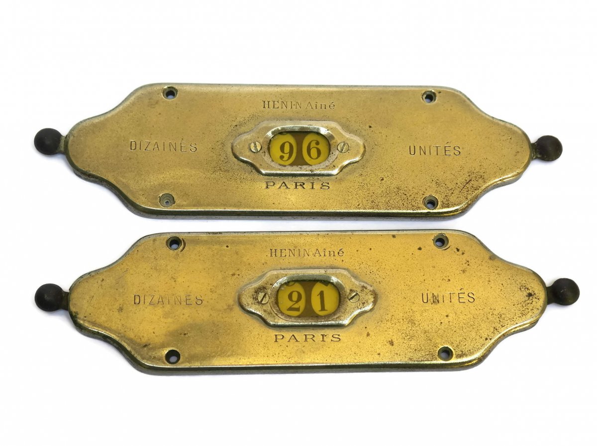

    Years ago when Ed Roy was restoring the 1914 INDY 500 winning Delage the lap counter was missing. He had original photos to study, and found one at a swap meet in Paris, an exact match! Then he found another, and a bit later another. Turns out they are Billiard counters. Bob

    I bought the Billiard counter for about 150$ on Prewarcar

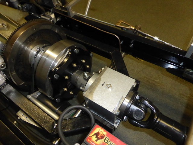

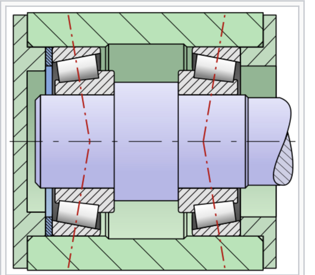

    Rolf, what is the rectangular box behind the engine?
    Thanks
    Bob
  28. Rolfzoller
    Posts: 400
    Rolfzoller
    In this Box are two roller bearings which support the shaft who is the connection between the clutch driving Plate an the propeller shaft in axial direction and in the flywheel is an additional simple roller bearing to support the radial force (It isn’t easy to explain that in English)
  29. banjeaux bob
    Joined: Aug 31, 2008
    Posts: 6,750
    banjeaux bob
    from alaska
    This is the kind of work I do. Just saying it is a support is enough.The drawing is great. Knowing the internals also answers the question I had about the grease zerk on the top.What material(blue in the illustration) do you use for the adjusting shims?Do you have bearing preload or endplay?

  30. The37Kid
    Joined: Apr 30, 2004
    Posts: 32,537
    The37Kid
    I'd like to know how the bearings get installed, look like cup & cone front wheel type bearings, correct? Bob
