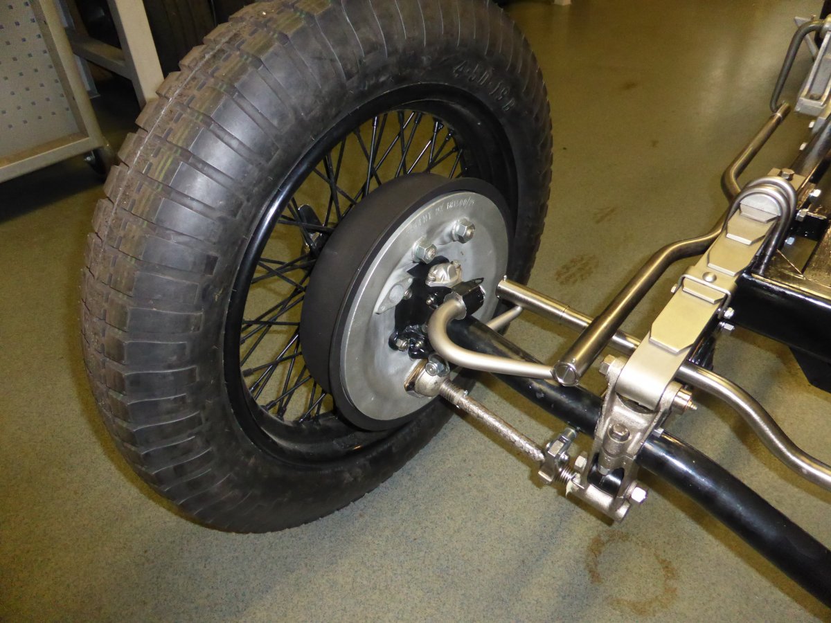

    Just found this thread. Rolf, your craftsmanship and detailing are incredible! I'm thinking you must have served your apprenticeship at a Swiss watch manufacturer!
    Question -- it appears that the upright that the front spring attaches to is clamped to the axle. Does this depend on friction alone to prevent axle rotation, or is there a dowel between the axle and upright, to preclude rotation? Is there a provision to adjust castor?

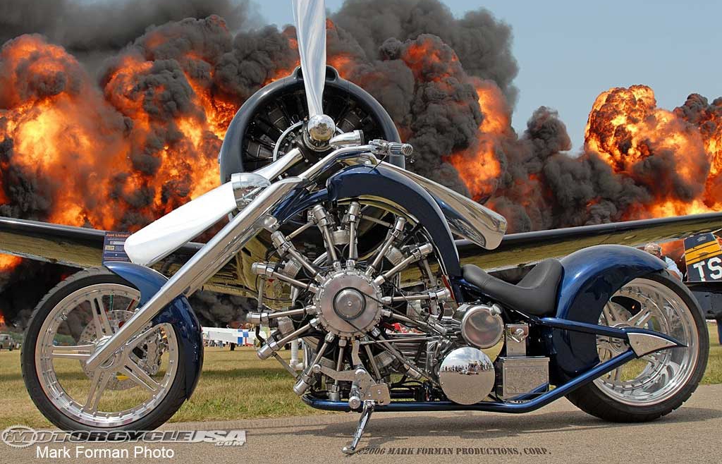

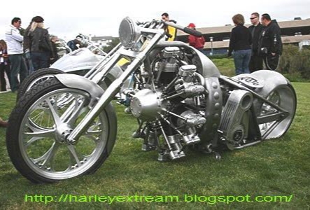

    Aero-engined, but maybe not racers, so maybe OT.

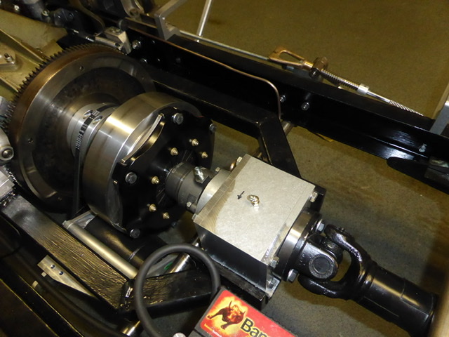

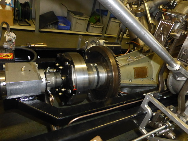

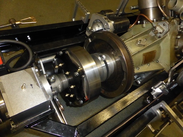

    I manufactured it with theoretical 0.00 mm end play, I was not able to calculate the preload because there are to many open questions regarding length of the housing (It’s actually to short but I had not more place) inclination of the propeller shaft and stiffness of the subframe.So it’s the easiest to start with something and modify it when you see there are some problems.I will use some steel shim rings for bearings if the preload isn’t enough .After ***embling the bearing,shaft and housing I was feeling a small preload when I turned by hand .For me is it all ways a big challenge when you have to solve problems like that,because nobody can really help you and when you ask 5 experts you will get 5 different solutions.As I wrote already in posts before I underestimated this project, I was thinking with my background as a mechanic working for 20 years on Motorcycles and building a Riley Big Four Special and a Salmson S4c Special with blower ,I can do that with any big problems but I was completely wrong!

    Bob,there are caps on each end to allow installation of the parts. The bearings are installed on the shaft first.Once the shaft is in the box ,the cups are added.The end cap that does not have provisions for the shims is put on first. Then the other cap,in conjunction with the shims , is installed to obtain the proper bearing load or end play.

    The silver bike was at EAA Oshkosh a few years ago and would fire it up on a regular schedule all during the weekend......great sound.....great vibration......great smoke......great smell.

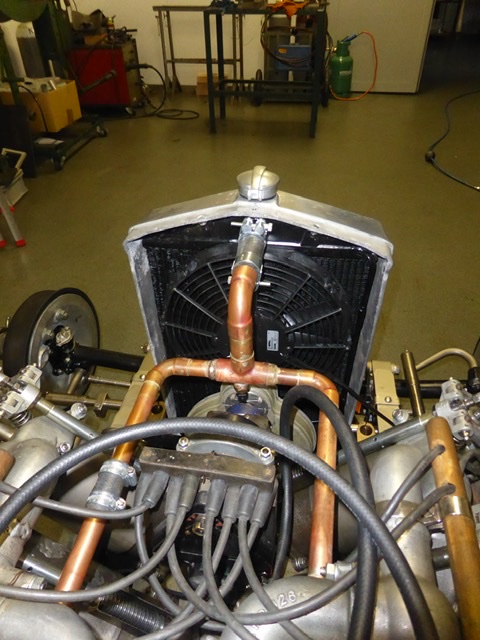

    I just installed the starter magnet and the ****on for the choke FF8F57E5-8555-4133-A92C-E4DFB6820974.jpeg

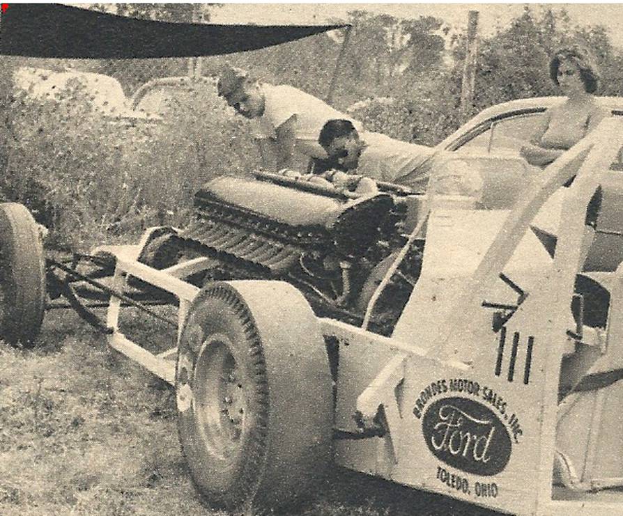

    Just found this picture...is it the same car? 158418223287235599893843204031.jpeg in post 729

    Don't think so, the first car was from New Zealand and this one is from Ohio and the engines are mounted in opposite directions. The blower is on the front in the first one and on the back in the second.
