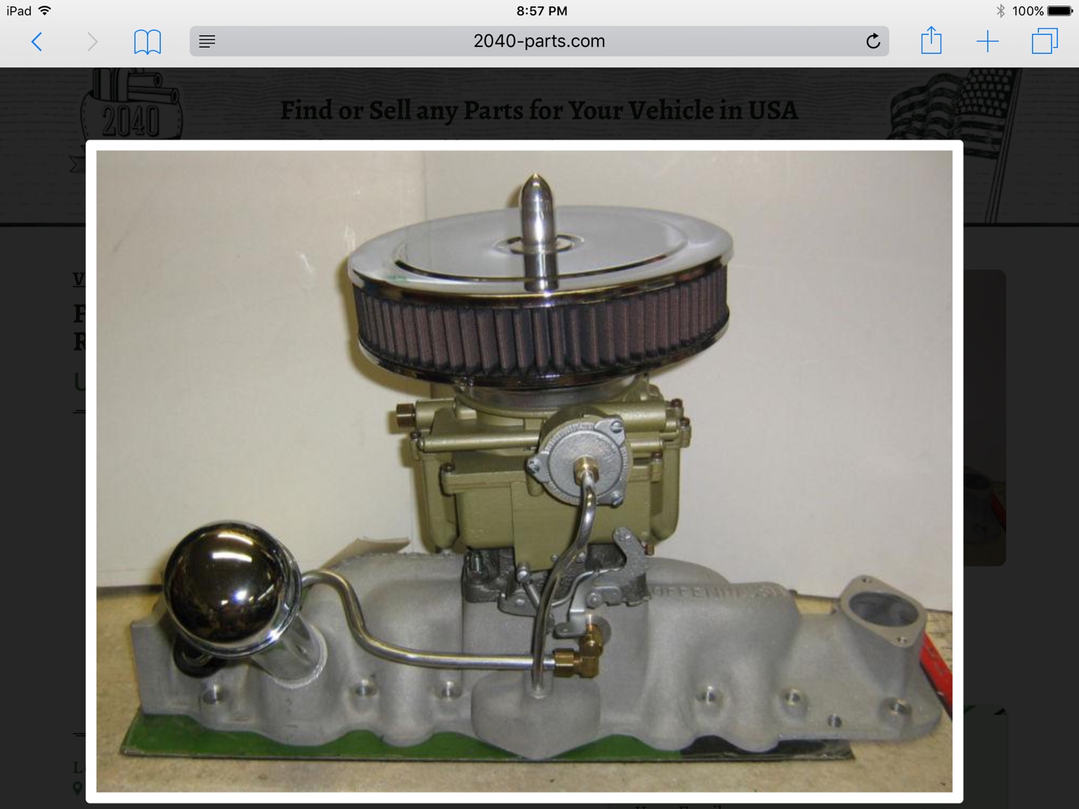

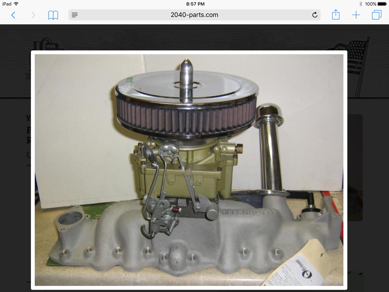

    Anybody have any photos? Seems like it is somewhat of an illusive setup but I have one and an Offy intake. Trying to set it up this winter and not having much luck finding any info.
    Here are some photos I have found and some relative questions below.
    Note the vacuum line inserted directly below carb, is this ok to simply be inserted/ jammed in, or should I connect with threaded insert?
    Why did they connect this vacuum on the manifold?
    Any photos or advice, constructive input would be greatly appreciated.

    Positive Crankcase Ventilation. ('PCV') Once considered a California pain, it has since relieved many of pesky oil leaks, resultant from excessive crankcase pressure. Lots of threads on this, look up 'PCV Valve'.

    Uhhh... Any time a PCV is utilized, the filler 'breather' is either 'valved' one way or actually plugged. If this filler cap is 'open', it's incorrect.

    The Vacuum line that just plugs into the center of the intake is for a the hot air choke. The stainless tubing connects to a chamber that is warmed by exhaust heat, that warms the manifold to aid in cold drivability and keep the air fuel mixture from freezing up the manifold. Not as big a deal with a V8 but with an inline 6 you can get frost on the intake if it is not warmed up from the exhaust.

    The vacuum line for the choke should be sealed at the manifold. You have an open vacuum leak there.
    Agreed. Both your breathers need to be closed for a PCV to operate correctly.

    The above intake is designed for the later '48-'53 8RT/8BA engines, with the angled carb pad, road draft port (where the pcv is positioned) and fresh air intake/oil fill. On a late engine, the road draft port leads directly to a vertical stand pipe coming up from the crank case, while the fresh air/oil fill flows down and to the rear. The '35-'48 crank case ventilation is completely different.
    The late intake will work OK on the earlier engines if the air intake/oil fill is plugged and moved to the rear, using a stock 59 fuel pump stand, and removing the front vertical stand pipe and plugging the hole, or the oil pan vent.
    The pcv vacuum line should be hard plumbed into the intake with a solid connection to prevent a vacuum leak.

    There is NO vacuum on that line. It is only an air source to warm the Temp sensitive spring in the choke pot that opens the choke after a period of time that is set by tension on the choke spring by rotating the choke pot cover for the desired opening time.

    Actually there is vacuum on that tube. It comes from the carb and ****s the warmed air into the choke spring chamber to heat the spring. Any carb with a heat tube ****s the hot air into the choke spring chamber. If you don't believe me hook a vacuum gauge to where the tube threads onto the choke.

    As stated by BJR, the vacuum source is the throttle area of the carburetor. A p***age through the carburetor enters the choke housing behind the internal choke pull-off, and is allowed to bleed into the complete choke housing, and thence into the tube pulling hot air from the manifold.
    The hot air warms the bi-metallic spring, allowing it to relax, and the internal choke pull-off pulls the choke ****erfly open. No vacuum - no choke operation.
